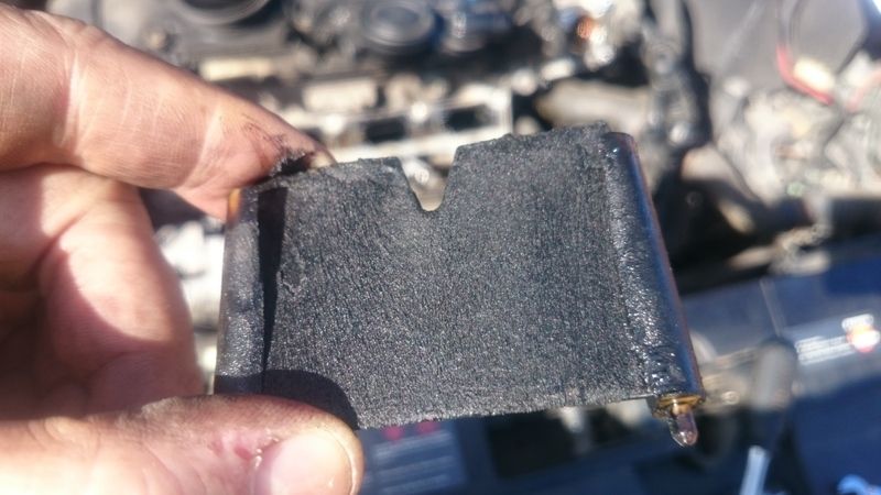

Ahh yes I did have until I ripped it out!
I heard something about that. Is there a fix for it?
If youve ripped it out theres your problem then.
Its a very well known design fault. I bought mine over the winter and noticed it was soaking wet.
I followed a guide on here nearly a year ago now and its still holding up well.
Just type in Mk 2 leon sealing bonnet strip and it will come up. The guide is by TimSwarf i think.
If i was you i would do that before winter arrives and buy a new bonnet lining incase a little water still gets through, cus if your taking the engine cover off it will only get worse and probably on all four coilpacks.
Thats what i would do anyway.
P.s How was your Apr remap and would you recommend?
Brilliant! I will have a look for that. I'll get it sealed at the weekend hopefully.
Hopefully I won't get much more bother with it seeing I'm aware of it now
Fix the scuttle on the bonnet to stop it happening again.

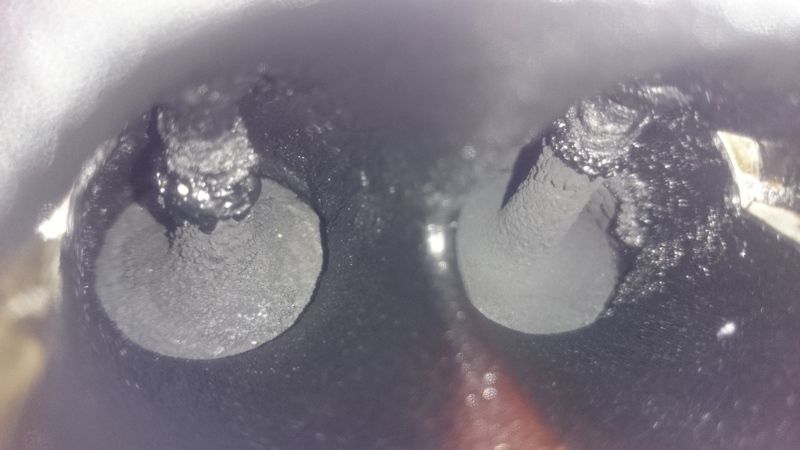

If your car is at 76k, I would definitely recommend cleaning the inlet valves and runners. I just did mine (67k) and they were minging. Absolutely caked in gum and carbon.
I also changed the injector on the affected cylinder as I didn't want to have to remove the inlet twice. If you do go ahead with it, I'd recommend replacing the fuel pump cam follower while you are at it. It's a cheap part that is easily fitted and will give you one less thing to worry about.
It's a pig of a job to do so if you aren't too confident carrying out mechanical work, I'd get a garage to do it. I'm a marine engineer so it wasn't too bad, just awkward as hell due to my sausage fingers :D I've read some good things about the walnut shell blasting process (we do a similar procedure every second day on large slow speed diesel engine turbochargers).
You'll notice that the car runs far smoother and the throttle response is much sharper too.
