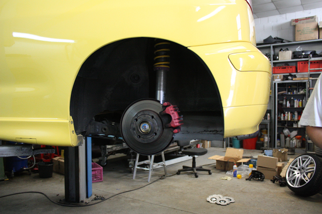

Hi I got a rear brake Upgrade with Polo mk3 and Lupo Parts. The Brake ist from a Audi S3...
Before
Difference
Lupo Plate with Polo axle tap
With new brake caliper
Mounted
Finish with 18"
