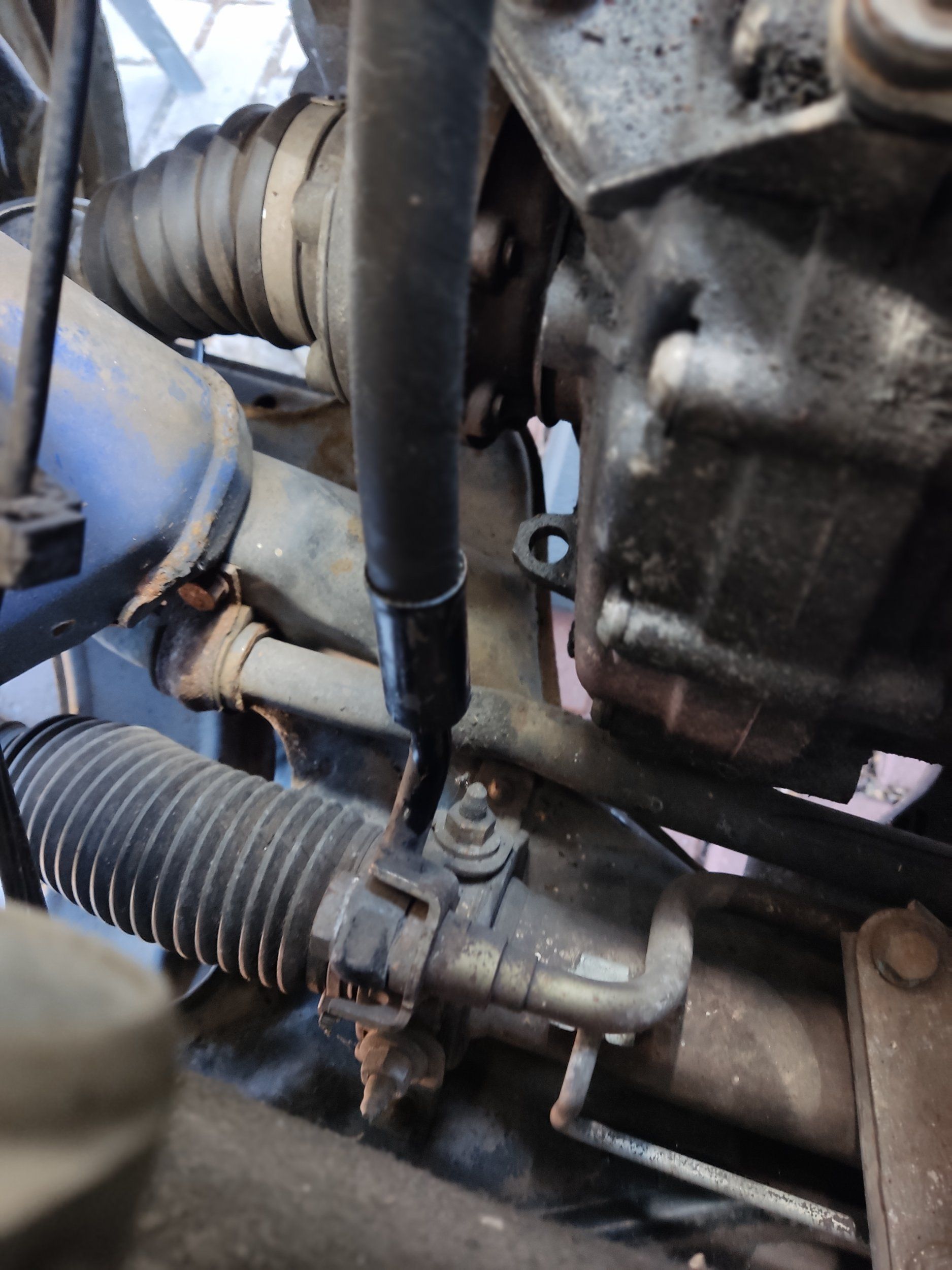

Got the free retest as it's free! Knew would fail as didn't have the right CV boot clip just rested a jubilee clip on it lol, they showed me the issue with the power steering, was pretty bad corrosion on a pipe on the near/passenger side and what looked like a moist pipe, seemed to have some kind of cover on it that was soaked in fluid so the pipe apparently needs replacing he said it probably had something to do with cooling not sure what he meant?
Wiped the pipe down this is what it looks like now, does not look excessively corroded to me (looked pretty nasty and greasy before)

If the examiner has failed it for that hose leaking and you've wiped it down and show it's not leaking then they will have to pass it on the retest...
If you ask me that seems very picky and it should have gone down as an advisory for 'seepage' at worse.
Feel free to look through the manual yourself, a leak is defined as :-
You should fail a vehicle if a fluid leak creates a pool on the floor within 5 minutes that’s more than 75mm in diameter or if there are many leaks which collectively leak fluid at the same rate.
I'd wire brush all areas of that steel section and paint it with some Hammerite, MOT testers probably see lots of steel sections of power steering fluid pipes that are exposed to incoming road crap, the smart home car fixer always treats these areas with paint to avoid any issues at MOT time and also to save that pipe from needing replacing later on.
I'd also think that MOT testers are just human and while sticking to the handbook etc, will probably hand out advisories or even fail cars that look like they are not getting much "love" - and when you add in that you just placed a CV boot clamp over the boot I'd think that was you adding to your possible pain. Too many people, it seems play the "just hand it in" and if it passes, do nothing for another year, I prefer playing the "try to keep on top of all problems" okay the odd thing passes me by at times, but by and large my cars get their MOT without advisories or failure, I'm aiming to keep my cars fit for the road and not them not being a danger to us or other road users, and hopefully not break down.

That was the retest, certainly was not dripping at all
