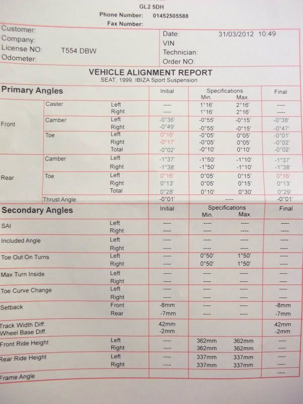

I rebuilt the front suspension of the car over Easter and took advantage of ATS being open on the Bank Holiday Monday to get the alignment reset.
I stupidly left the car with them.
Firstly they claim to have done a four wheel alignment on my 1999 Ibiza.
They claim the back was out so they did it all.
I didn't think this was possible as there is no adjustment on the back - They tell me there are eccentric bolts to adjust the rear toe.
Is this true, If this is not true does anyone have a photo or a schematic proving it so?
I asked them to show me the adjustment on the rear but the car was already off the ramp :(
Does anyone have access or know the recommended toe and camber settings for the front?
The car is running -1.5deg camber. I set this..(This is no doubt more than the book says).
I am also lowered about 25mm (The lower arms are parallel with the ground).
They claim the car should run 2.0 of toe in. Which is what they set it to despite my request for 30mins of toe out.
Apparently my request would have made the car unsafe?!

You're right though - you cannot move (with bolts) the rear camber or toe.
-1.5deg camber is what I always ran on the 6k's - but book is -0.5
I can't remember my toe settings any more though.
I think you've been duped though
This is what pissed me off, I went to like 3-4 places for alignment, but I knew the rear axle is fixed, but everyone except 1 company were like "you need full front and back alignment"
NO I DON'T [:@]
Then went to see Aline, first thing he said "cannot do backs on these, they are fixed, unless you have rear camber shims?" :love:
PS £57? WOW, I am getting front caster, camber and toe, rear camber and toe all done for £60 dude, go back and kick off...
Suj Ive had a few places try the same with me but when I said the rear is fixed they look at me as if Im making it up and dont know what Im talking about.
There is some sort of check that can be done on the rear but its only to see if the rear beam is damaged/bent in some way.
They can check rear wheel alignment easy
but you can't adjust it, not without shims
Protyre do a full report front & rear but tell you they can only fix the front
They do use the rear to then have a point of where the front is aligned to, but they can tell you like if there is castor on one side, then wishbones could be bent etc (or cars been in a crash), but as they are just using it as a reference point, you shouldn't be paying for that!!!

Yeah, I kicked off with them.
Got a full refund and I think the area manager gave them all a roasting..
