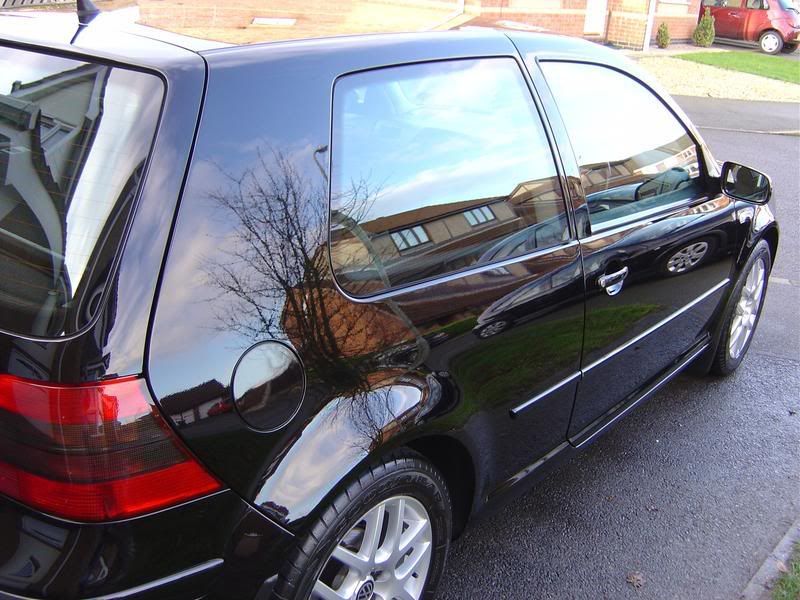

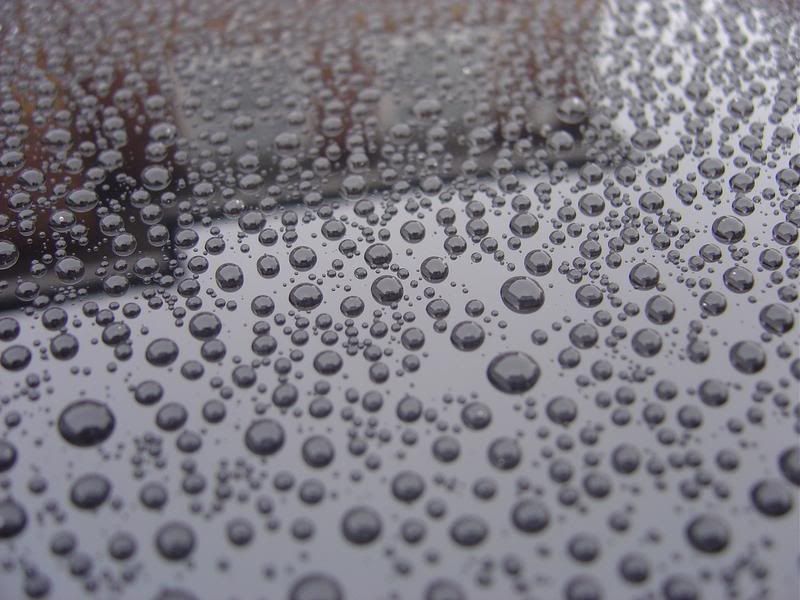

A few pic's of 915 on my old Golf, if that helps convince you ;)
ok, when you say a couple of layers down, do you mean wax, then leave to cure, then wax again and leave to cure? Or wax, cure, wipe off, then wax, cure, wipe off??? Never double layered a wax before.
Cheers for the pictures, looks as good as the result I got from Nattys Blue, looks like ill be ordering Collinite 915 for the winter then!
