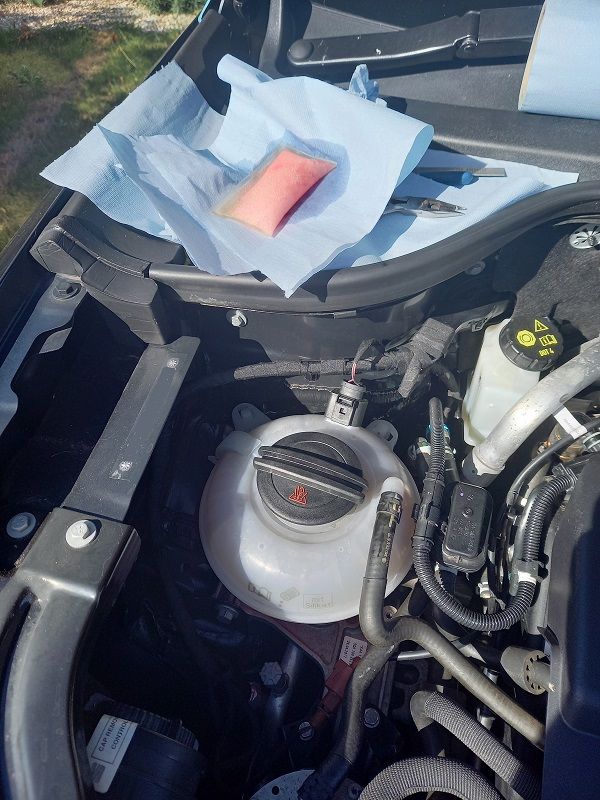

Next on the list was to see if there was a bag of silicate in the coolant header tank. There was, so I removed it to avoid the potential splitting bag / blocked heater matrix issues. Thankfully the bag was intact on removal and didn't look in bad condition:

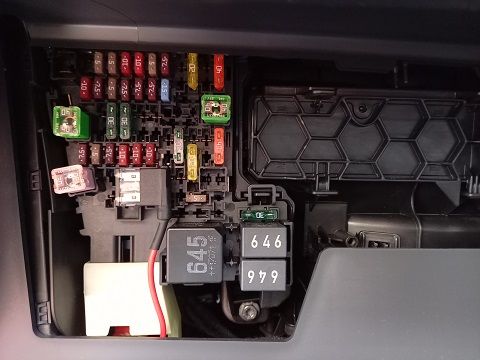

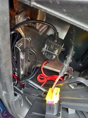

Next was hardwiring the dashcam in. It was the same process as on my Leon, but just seemed a lot fiddlier. It is all in now, running off the rear wiper fuse, and the cable comes out of the headlining next to the rear view mirror:

Looking good. Can't say I've searched for that bag of silicate. Same spec as mine, it does pack a punch and the seats. Sits very stable on the road, glued when cruising on autobahn.

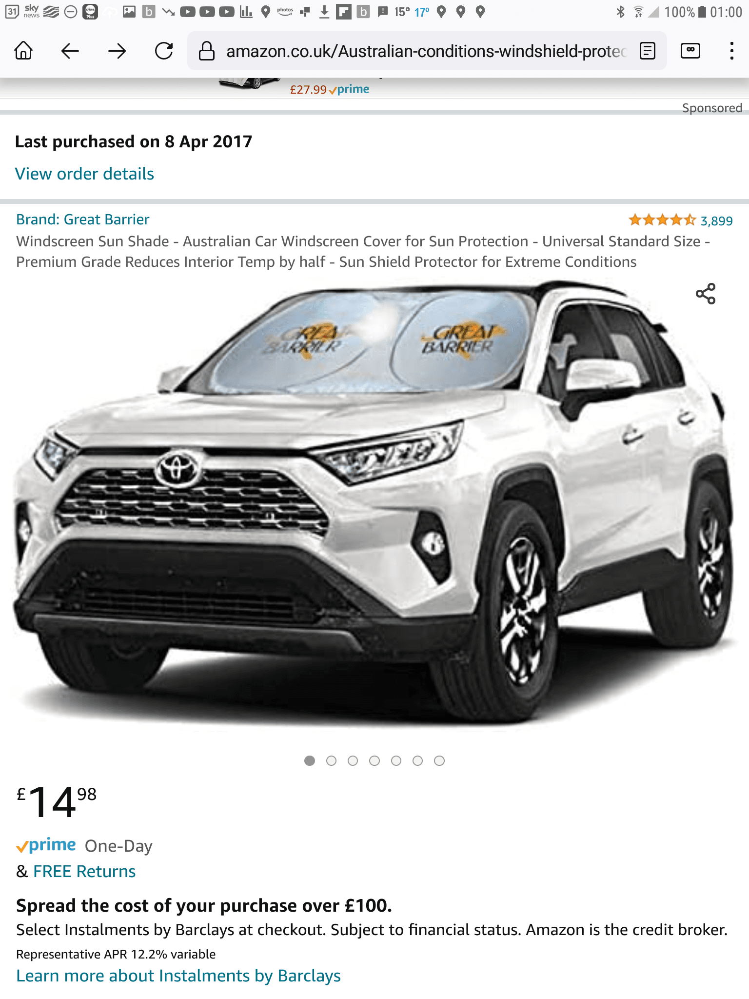

This time of year I'm deploying my twisty Ozzie shade sunshade. They pack down, go under the seat in a punch for storage and the towel on the seat so you don't burn your posterior on the leather 🤔. Godsend now with the heatwave.
Sold as these now. All branding. Never needed a sunscreen till I got the black leather seats 😂. The towel trick I saw in outer London with people with their Jags. Towel, slap on the front seats as required, generally if you forget to put the screen up and park in sun. 99% of the time the sunscreen isnt required in the UK.
