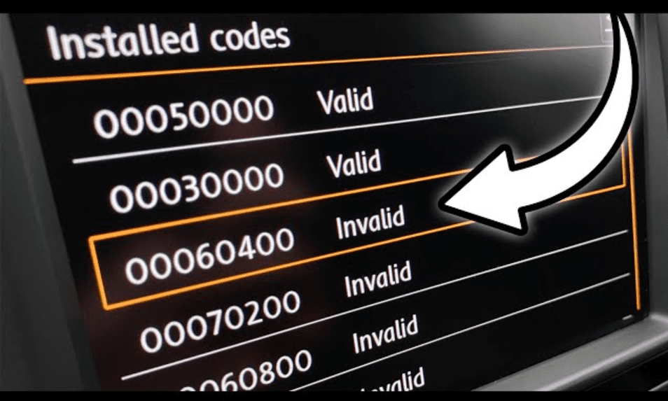

Even marketing documents from older versions of the Ateca FR mention it having wireless, so it's looking more and more likely that it's a licensing issue.
There's an information submenu on the unit which shows supported feature codes (FeC) and actually installed ones, like the one in the screenshot below.
Look for the installed ones and their validity status, take note of them, share here and let me compare with mine.
A long press on the circular menu button on the lower left should take you to that menu, if I remember correctly.
Reactions: Berlihm
Thanks for all the help so far. I just got my wife to check. Here's what it shows:
Installed
  • 00070b00 (Valid)
  • 00070a00 (Valid)
  • 00070500 (Valid)
  • 00040100 (Valid)
  • 00071c00 (Valid)
  • 00060400 (Valid)
Supported
  • 00000700
  • 00040100
  • 00060100
  • 00060300
  • 00060400
  • 00070400
  • 00070500
  • 00070600
  • 00070900
  • 00070a00
  • 00070b00
  • 00070c00
  • 00071c00
Reactions: serdar_18fr
Regarding the installed ones, my Ateca (wireless enabled in factory) does not have more feature codes than yours.
So, I believe activating wireless is just a matter of coding.
Being a 2024, your car shouldn't be affected by SFD2 and that's good news.
I didn't actually do this exact change before, but I remember that I've read somewhere that it should be as easy as changing a couple of long coding and/or adaptation entries in infotainment unit using a capable diagnostics device, like OBD11 or similar. (if the hardware supports it of course)
By the way, here are the descriptions of those codes for a MIB3 unit.
  • 00070b00 Android Auto MIB3OI
  • 00070a00 Apple CarPlay MIB3OI
  • 00070500 SDS MIB3 OI
  • 00040100 Navigation
  • 00071c00 Predictive Route Data
  • 00060400 Performance Monitor
  • 00000700 Green Engineering Menu
  • 00060100 Vehicle Interface
  • 00060300 MirrorLink/AppConnect
  • 00070400 Electronic Voice Amplifier
  • 00070600 Rear Entertainment System
  • 00070900 WLAN Hotspot
  • 00070c00 Baidu CarLife
