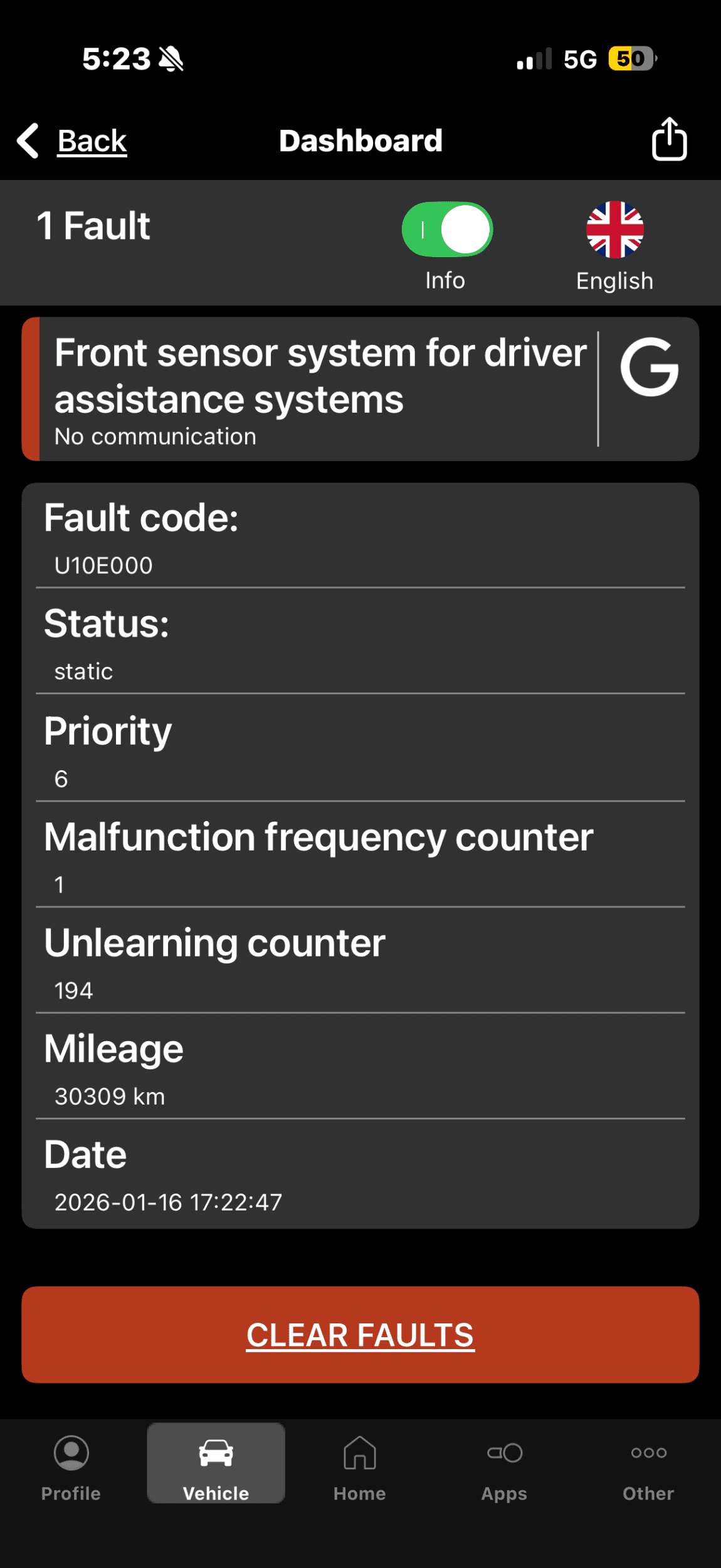

If anyone could possibly help or have advice!!!
Had one of the sensors replaced by seat couple of months ago, ever since I have this error thrown at me when scanning the car clearly a real fault as it stays on when trying to clear it.
No obvious signs of problems as all parking sensors work on the front & all other assistance systems I know off that the parking sensors use still work such as self park, emergency braking system etc…
It's a background fault that you can ignore. It's referring to the LDW camera and ACC radar, if there was an issue you'd have a warning light on the dash.
Reactions: Cain1412
If there's no warning lights on, ACC, front assist, traffic sign recognition and lane assist work then it's no cause for concern.
I see that code on most vehicles.
Reactions: Cain1412
