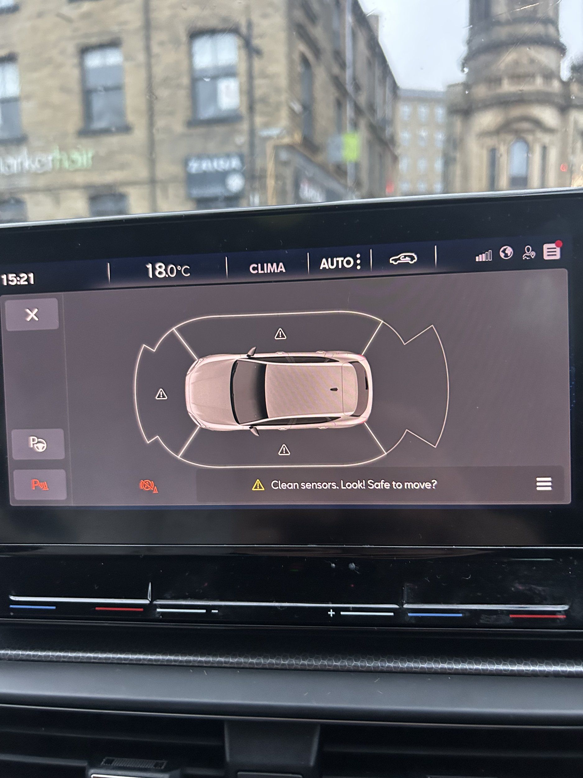

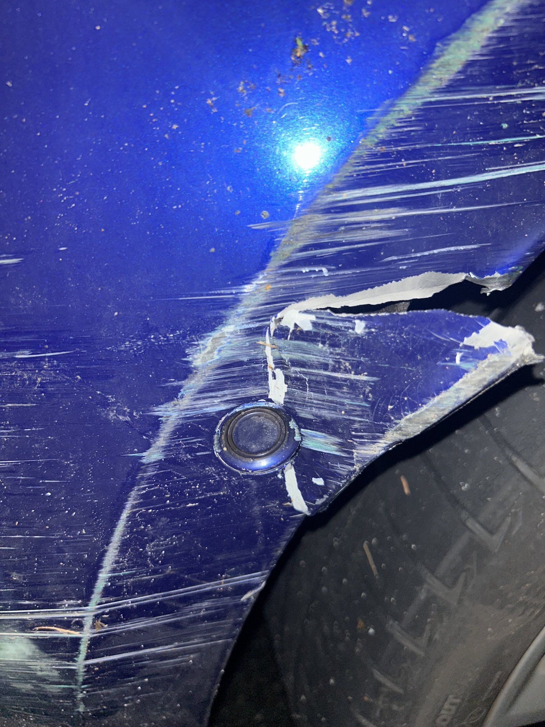

I was recently involved in an incident with a bus whereby it crashed into the side of my car, essentially scraping it. Causing damage to my rear off side bumper and rear bumper. In doing so, it has caused damage to one of my sensors - as shown in the picture.

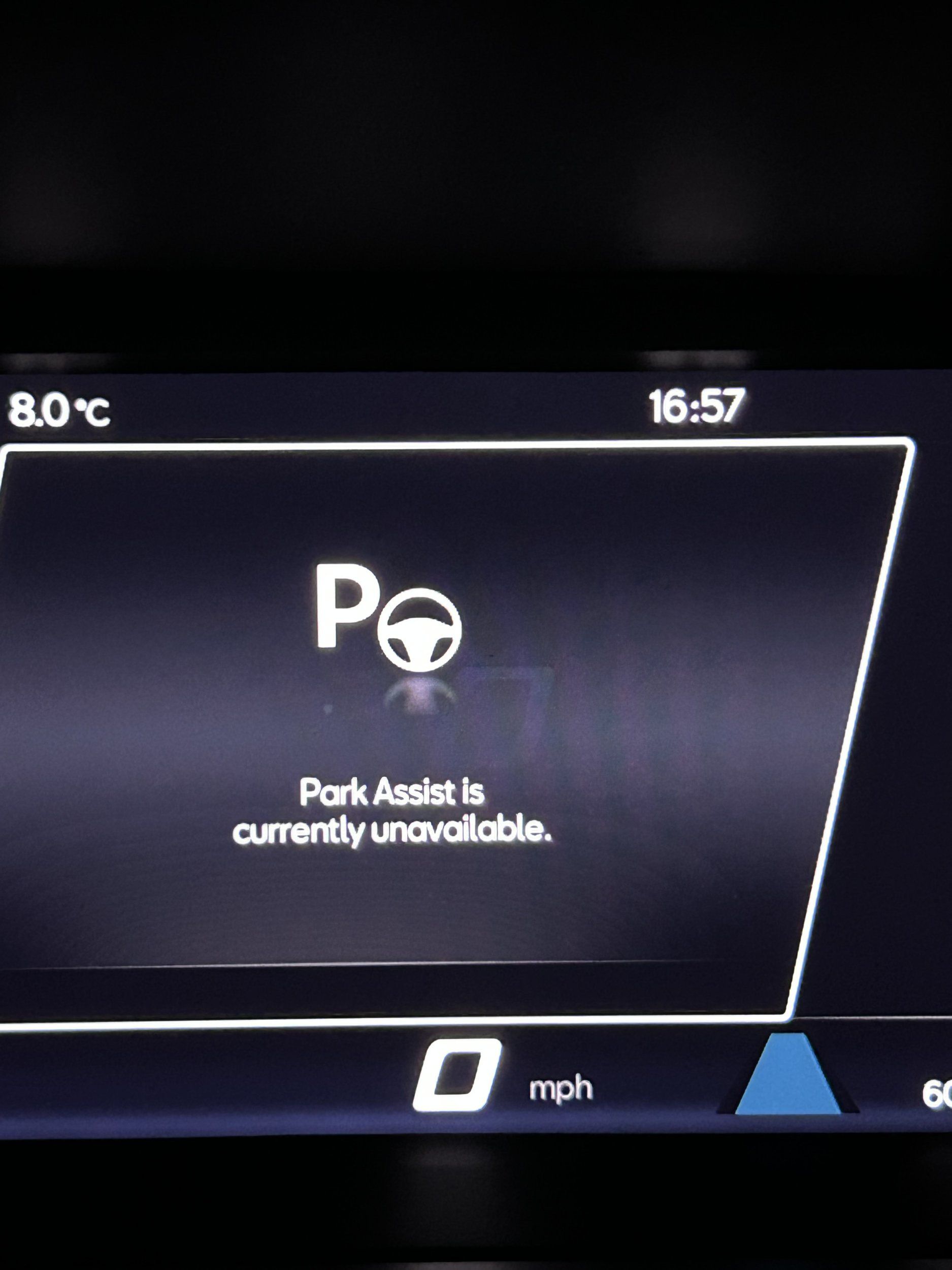

I have since had multiple error messages all to do with my sensors, all whilst stationary, parking or even driving. I’ve shown pictures too of this.
Will this all be linked and caused by damage to the one sensor? It’s thrown me a little as sometimes the reversing sensors work, and not the ones at the front. You’d have thought it would’ve been the other way around?

Also this one. Please NOTE. I did not take the photo of this. My Mrs did!😂 - just to prove it happens at times I do not need the parking aid
As a system they are all linked, yes.
The issue could well be that one sensor bringing down the whole system.

If the damage was at the rear, then I'm surprised to see the front sensors have been disabled whilst the rears are (mostly) working
Are you sure you haven't got a stone chip or similar on one of the front sensors? It doesn't take much to disable them unfortunately
The side sensor area functions using sensors on the front and rear, so a fault on either would cause the side area to show an error.
Hi. Yeah, there looks to be no damage to any of the other sensors.ive give the sensors a good clean too and if it means much, rarely wash my car with a jet wash. It’s extremely frustrating but it has just started after this bump. Just bizarre how the front ones are not working at all when the rear ones sometimes are
