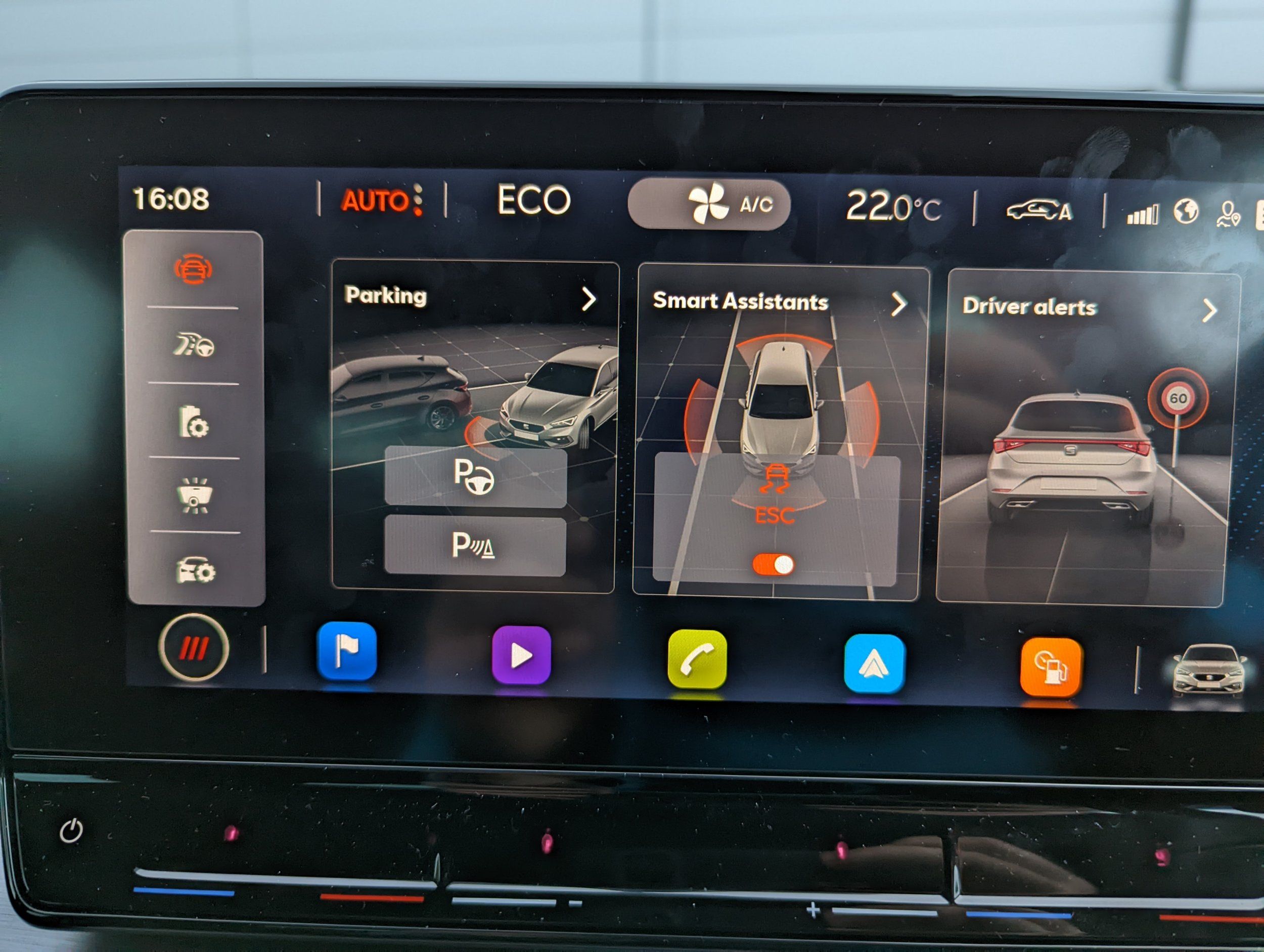

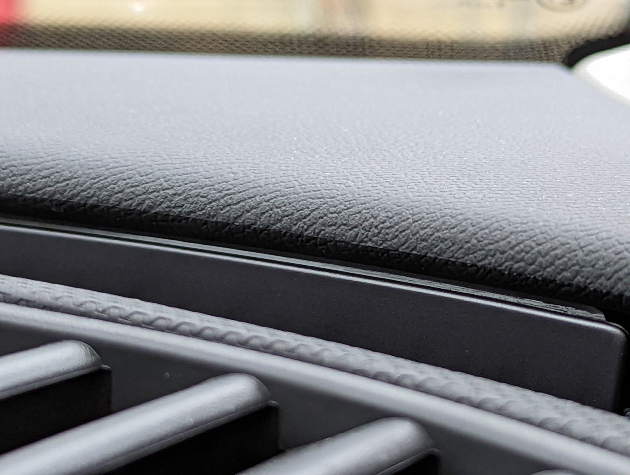

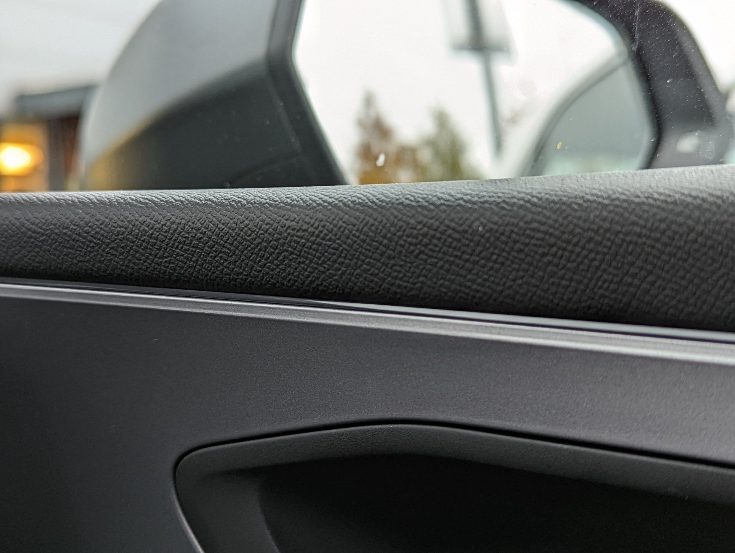

I can live without DCC, but I would very much like to have blind spot assist. Do you know if this can be enabled from software via update or something similar? Don't mind paying for it. I attached a few pictures where I think the car is equipped with LEDs in the door and dash.

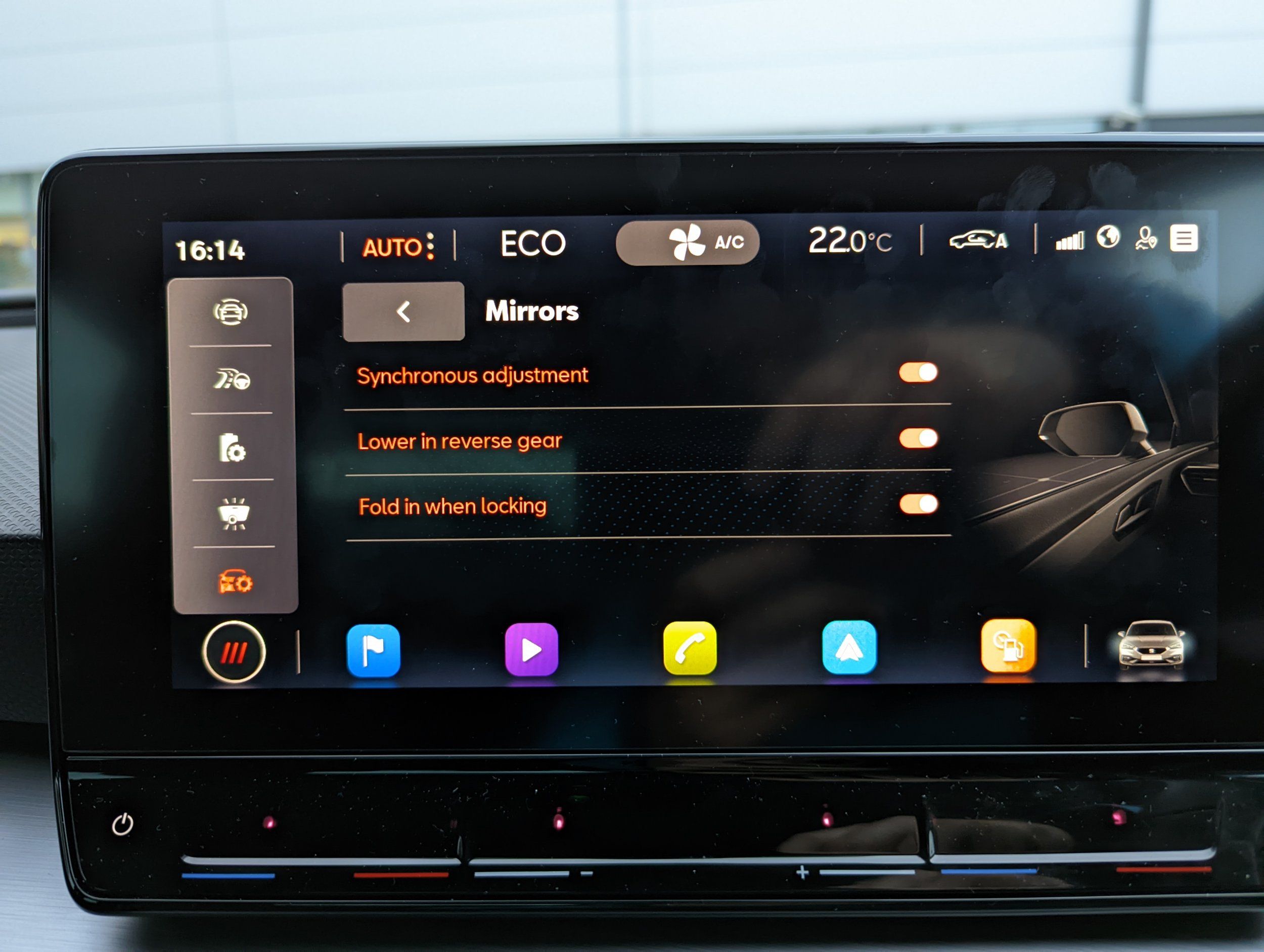

One other thing I still didn't manage to find, although it was advertised as a standard equipment on the basic FR was lowering the mirrors when reversing. I can find the option but the mirrors don't move when reverse is engaged. Sounds like a bug. Any ideas?

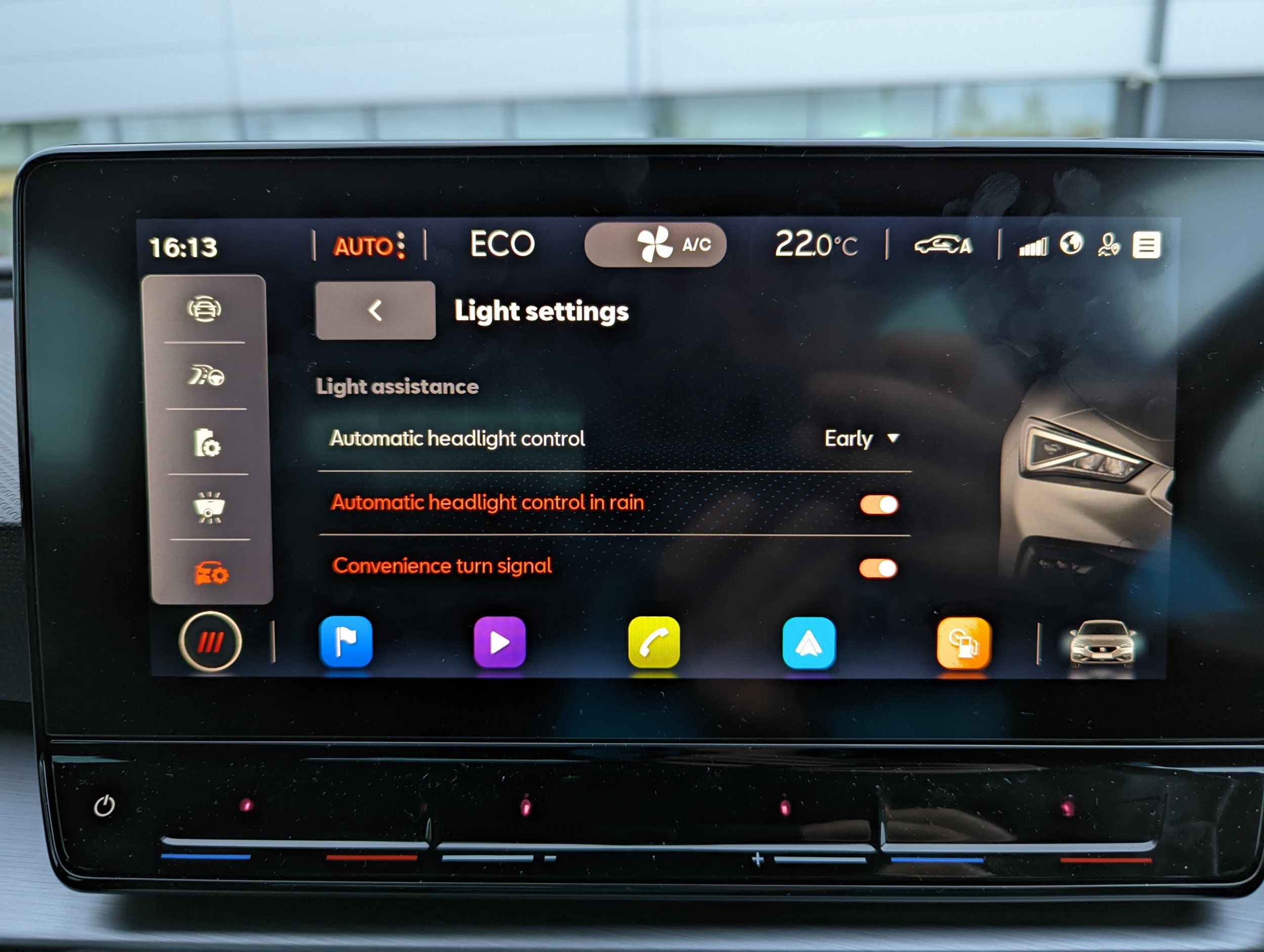

And one last thing, more of a gimmick, was adaptive headlights for incoming traffic. I'd appreciate some help with this too as I can't find any options around that.

Blind spot Assist would also need radars being fitted behind the rear bumpers, which to my understanding is a big job. @East Yorkshire Retrofits would know.
To lower mirrors in reverse the mirror switch needs to be set to 'L' on RHD cars, and it will dip the passenger side mirror in reverse. To set it up your best of reading the manual, just remember to set it to Left not Right, the manual is for LHD.
I don't think adaptive headlights are currently available on any Leon. There is high beam assist when turning on high beams you would see the letter 'A' inside the high beam icon. The high beams would turn on and off automatically when it detects oncoming traffic.

Adaptive headlights isn't possible however high beam assist is.
Blind spot assist is expensive, the radars are £450 each (there's 2 of them), then there's the necessary wiring, brackets, door lights & labour
We need a car here to look into the ambient lighting further. From what we can tell, there's no variations between cars with and without wrap around ambient lighting hardware wise

One last question: my current ambient lighting has only a white colour and unable to change it from the infotainment, even though when I unlock the car it does appear red. Also, the software being bugged and having to turn it on manually every time.
Does anyone know if I can reflash parts of the software to unlock other colours?
Can the wraparound be retro-fitted?
Thanks!
I reckon it would be a lot of work to retrofit most of the dashboard would have to come out.
Hopefully with the unlocking of SFD protection things like this can be enabled, but again it does depend on hardware support
That's normal, it's how it's supposed to work.

Come for a trip to us and we can investigate the lighting questions further. We've gone as far as we can now without getting a car here without it to look at
