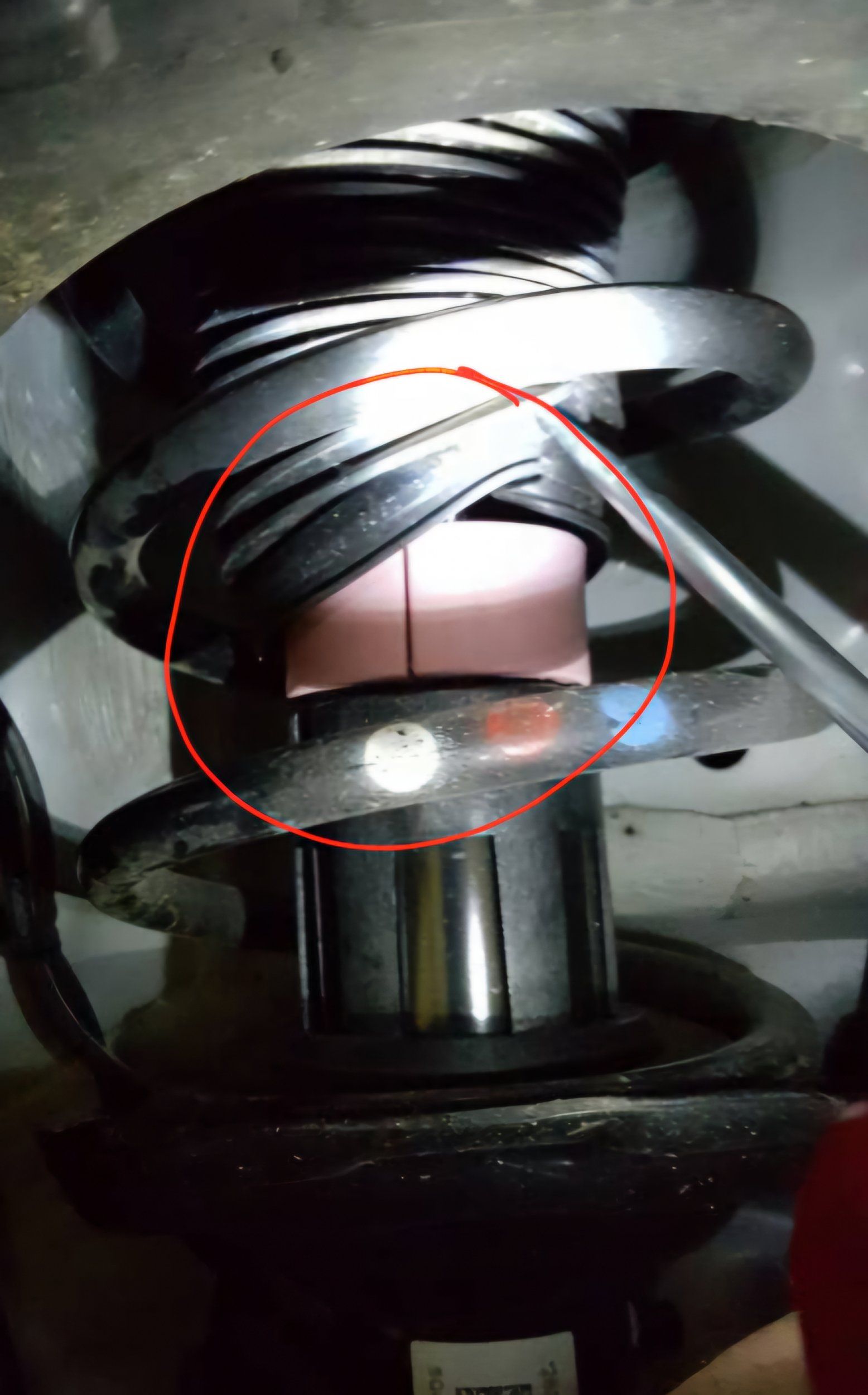

I'm not sure sure if these have transport blocks in the suspension, but that might be the first place for the dealer to look
Hi, thank you, Hubby thought that might be the case and had a quick look a few days ago, but couldnt see anything - although tbh, he wasnt quite sure he was looking in the right place.....
Ideally, you need to raise the vehicle to check properly. If there are any in there they will be under the plastic dust cover.

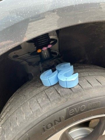

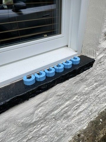

Investigation complete and you were correct! Absolutely fuming and delighted all at the same time! Thank you so much for your reply and your help. Dealer will be getting a call tomorrow! Been out for a drive and its a completely different drive, so relieved!
