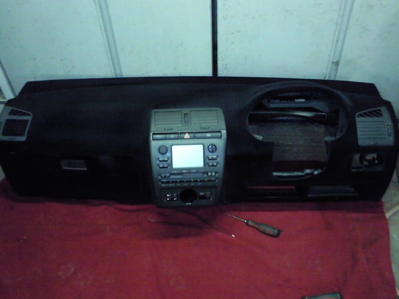

dials should have a click feel to em - quite solid in fact so sounds like your dial may be loose/broke or at best cracked but never pulled one of yet as they are on well tight
if it's more drastic than that to get at the main unit itself you need to carefull lever off the trim around the dials from underneath and you'll see the 4 screws in the corners holding it to the dash from inside
to get to the rear of it unscrew the pocket or window switch panel under it (2 screws at top) so you can push the heater bit back and then slide it out down the lower hole
not easy or ideal as it's all still connected but at least there is better access if needed
just watch the outer trim, it's only clipped on but if you twist it too much all the illumination optic plastic will jump out, easy and logical to get back in as it's all clipped in but will make ya think 'oh F***' when you first see it all fall down - lol
this might help ?
