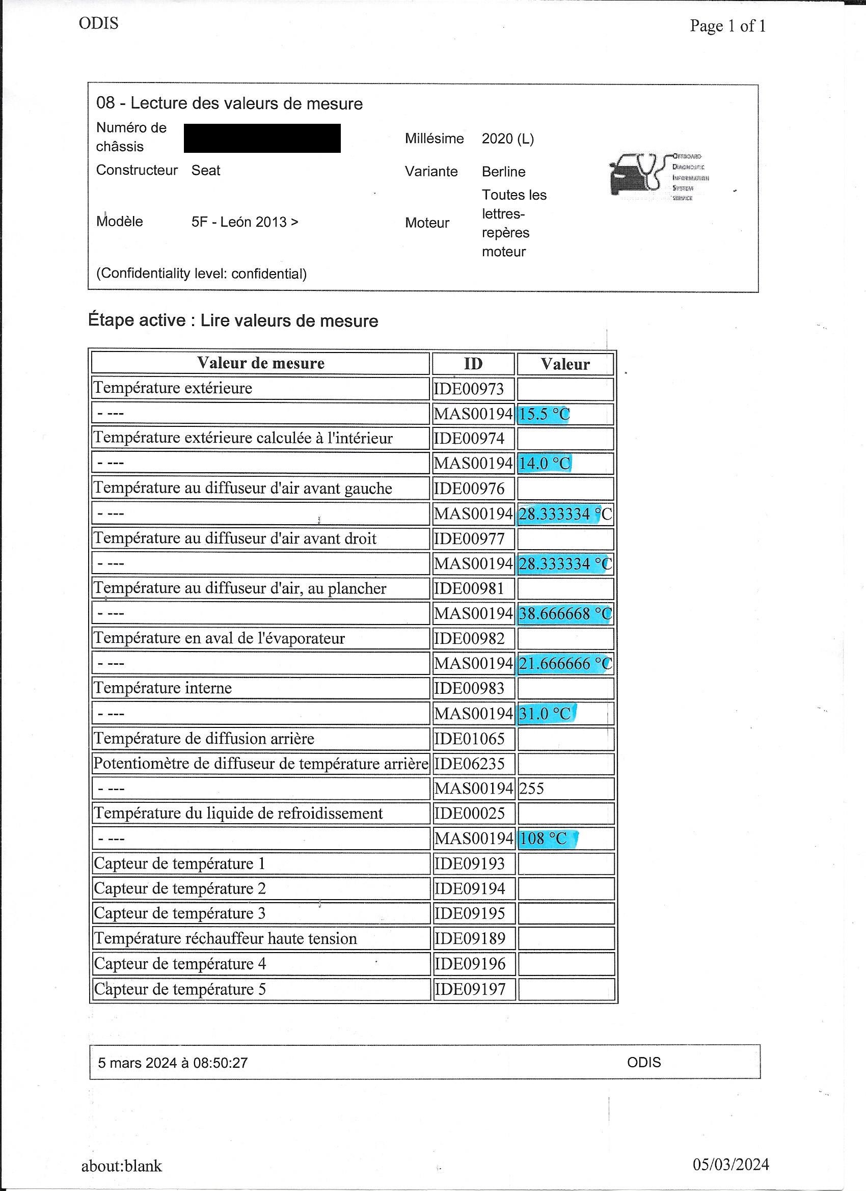

Hello meevilsheep,
An ODIS diag has been done and you'll find the values to the attached document.
Furthermore, they placed a digital thermometer at the level of the ventilation nozzles which regulates well to the desired temperature (tested at 26°C and it's going from 28.6°C to 26°C..).
However, the test was done when starting the vehicle (cold engine), where I managed to get a little heat.
As you say, I also think that the issue may come from the cabin temperature sensor. If you check the value IDE00983/MAS00194 for the interior temperature. It's about 31°C which is very high, so that could explain why it blows cold air and not hot air ???

I think you`ve found the culprit then :)
Not sure how could there be 31°C inside a car, from a cold start, when the outside temp is 15.5°C. But if that`s the reading, then the ventilation system blows cold air to drop the detected temp of 31 to the "desired" temp of 2X°C.
How come this didn`t raise any questions during the investigation? Especially since they had a digital thermometer on hand
They've sent a video that shows me they set the temperature to 26°C in manual mode and the digital thermometer drops from 28.6°C to 26°C in about 2mins (they've put the thermometer in the middle of the cabin). Then they've put the thermometer at the driver's seat air vent which increased the temperature from 26°C to 28°C.
But as I said, they did the test after starting the car.
I will try to drive 30mins before going to the dealership but I hope they'll have time to do the test immediately..
I am convinced that I am on the right track with the interior temperature sensor and I hope I'll find the issue..
