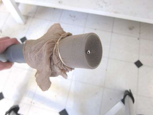

Got a flexible hose u can attach to a vacuum cleaner? :)
put some tights ( :p ) over the end and then put it into the headlight (if there is enough space)
Should suck it up and wont be in the cleaner either :D
Like this:
the plastic chrome bit won't allow the vacuum to go through :(
