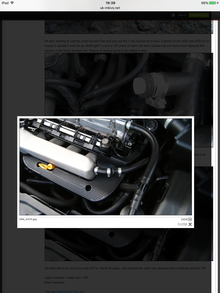

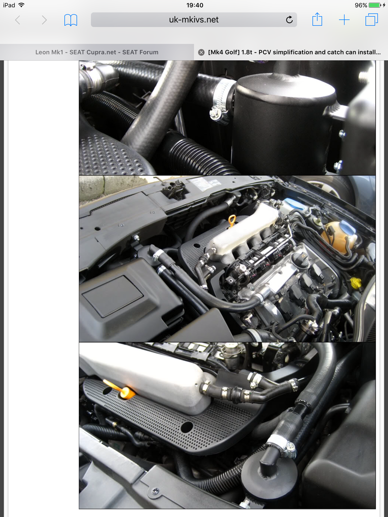

Look at these photos and look at the pipe that come out the side of the mani, what one do I go with?
The nipple under the mani is capped off u can use a bolt in a bit of pipe . The way thats bin done is from elbow pipe to ctch can top hose to rocker cover bottom pipe to tip your catch can is different u will have to mount it different to the one above
Just put a bolt in the pipe the same as the photo above cause wen u remove the pcv pipwork u will have to pull out the plastic pipe that runs across mani

Kev I'm gonna fit my can in a few hours, there a video online and the guy Dosnt take anything of the mani, all he does is take the y piece off the block and hockey puc then connects everything to that what's left, he takes nothing off, looks a lot easier, what do you think. Can I do it like this, you may want to forward the video abit lol
