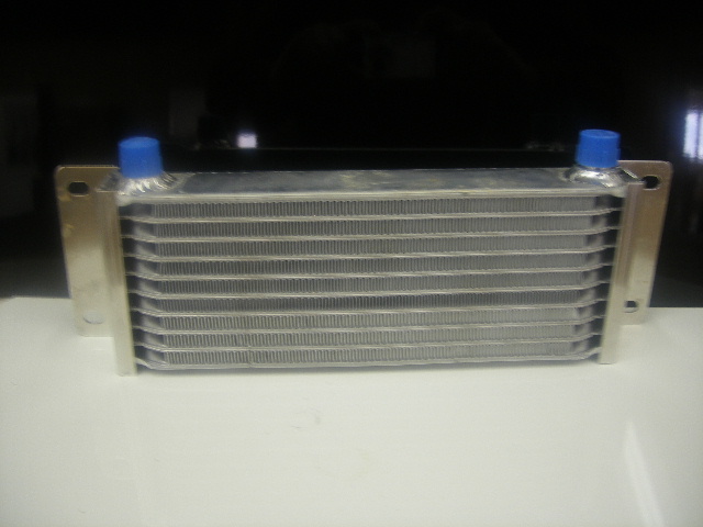

What kind of oil cooler is it? I may have one for sale soon, I bought a small 10row one on sunday and already have a rectangular one I think may be too wide for the hoses I have!!
