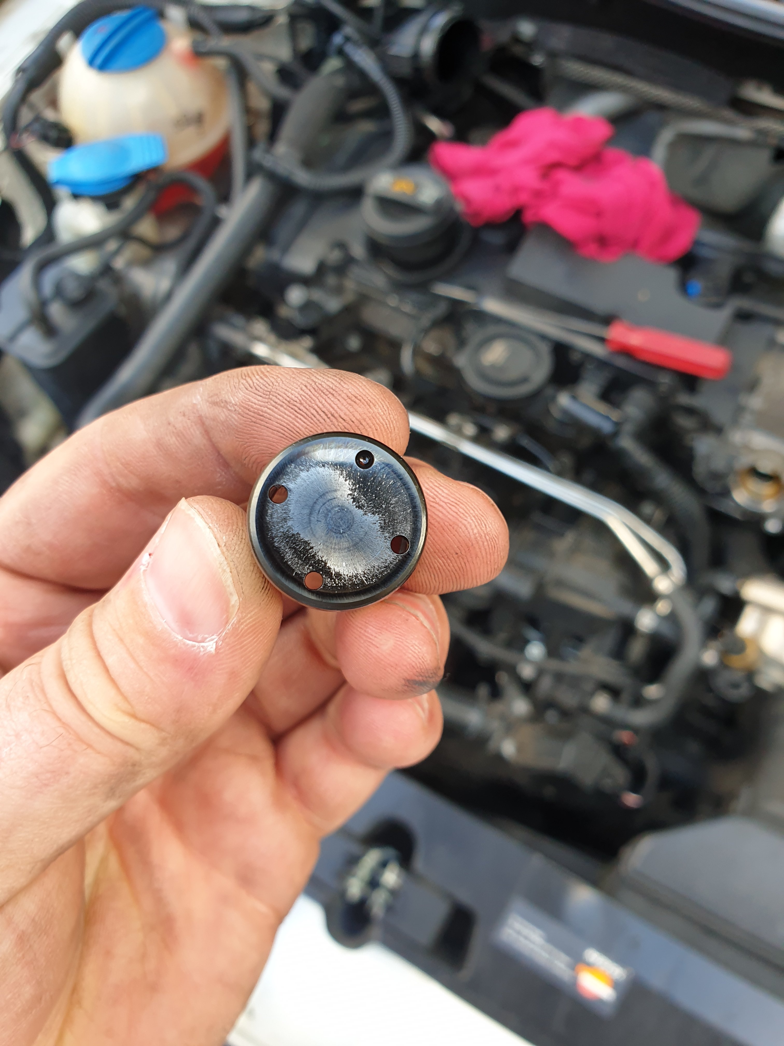

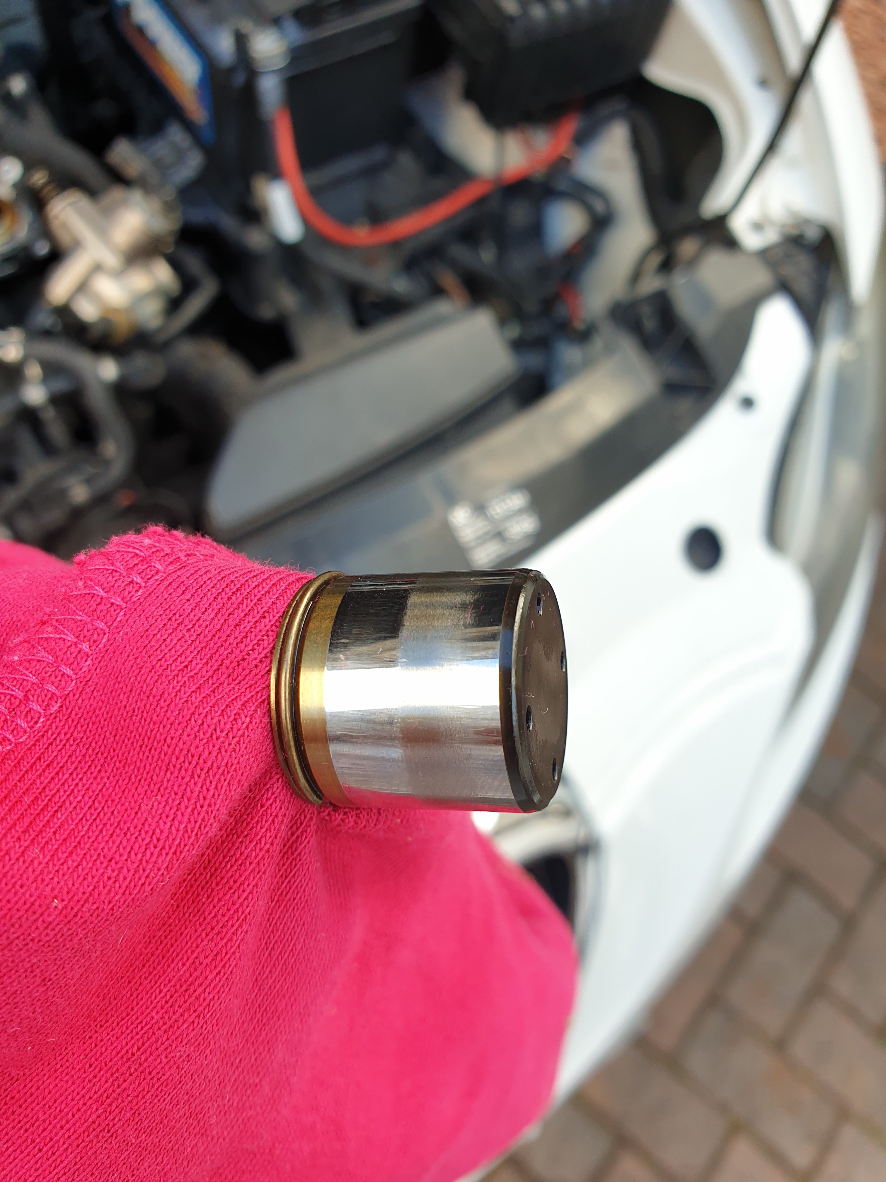

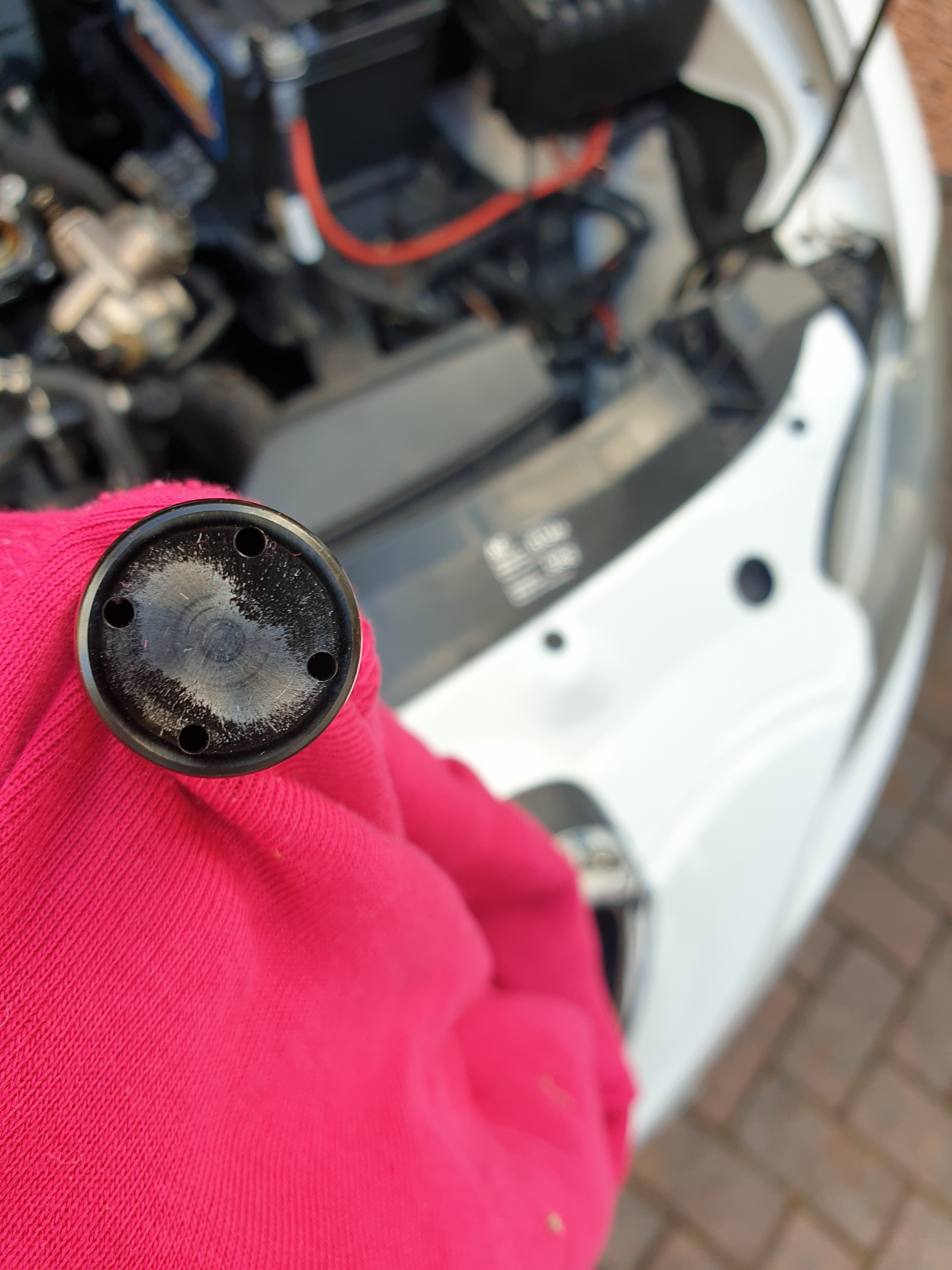

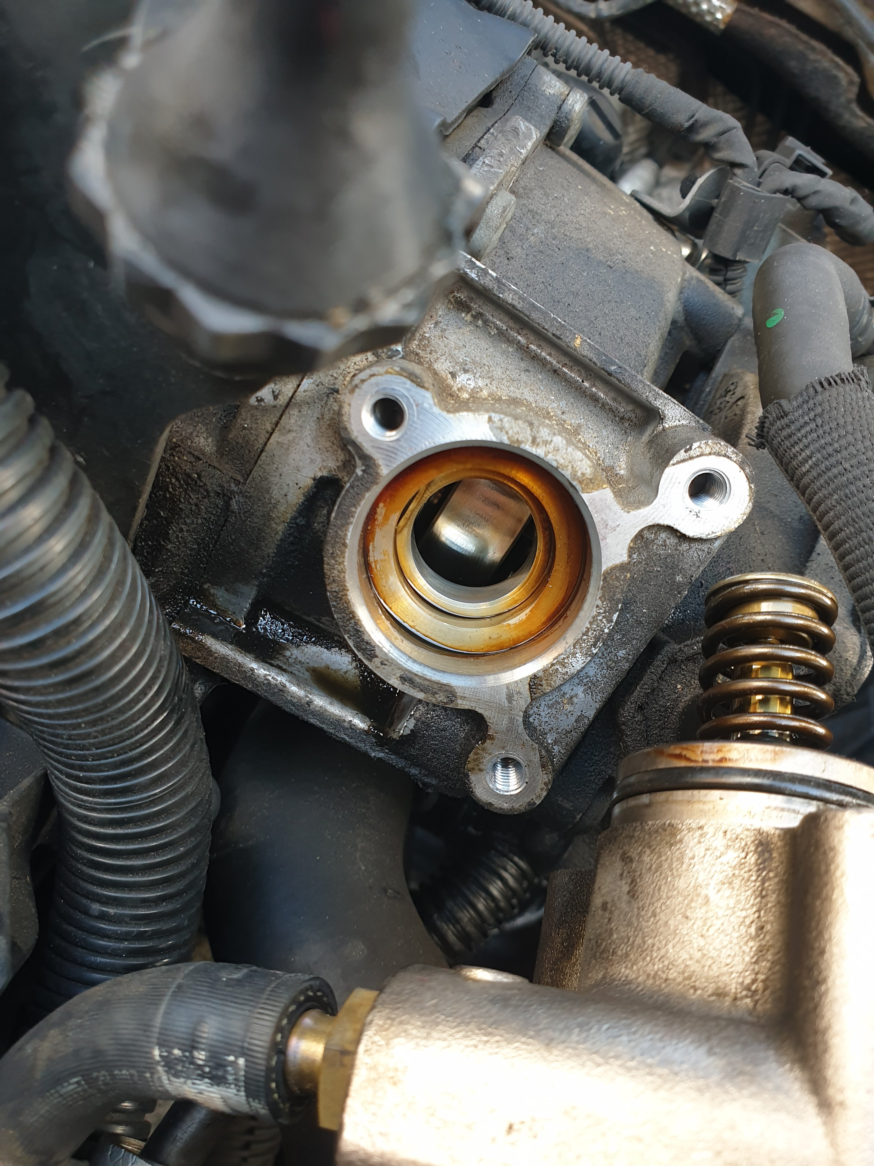

I removed the fuel pump today, there is deffo some pickup on the
but I do not know if it wareants changing. From what I have read, the tolerances are super small on these units so any kind of wear would be detrimental.
The follower deffo needs changing, the hardness has worn through and has some pickup on the sides too. I will buy a new one this week.
The only way I can imagine fuel getting into the oil in this area is if the shaft seal has gone around the plunger?
Anyway, see pics let me know your thoughts

That follower defo needs to be changed sooner rather than later.
At least there is no hole punched through it thou.

Due a change but not a problem.
You've no idea what the last one looked like though, could have gone stage 3 or 4 and they've just popped a fresh one in and hoped for the best.

Guys, if you click on one of the photos of the cam and zoom right in you will be able to see the pickup.
I am going to the dealers tomorrow, will show them the photos and see what they say. Will order new follower at the same time.
