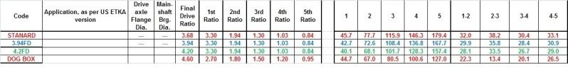

5.08FD top speed of 50mph LOL
I think I'll go for the 3.94 because with cams, 4 branch, head p&p'ed and a stand alone should see me nearly 200bhp and that should do for a wile. Then gear box and handling and if i do go back to the engine i would prob go for a turbo on to the ABF so i don't think acceleration will be much of a problem then.

Well Olly you get your head sorting in which way to go about the head mod's.... sort an exhuast manifold, decat, etc (performance advantage along the way) then do the head, cams & map all at once!
On the other hand you could go about the gearbox first, very easy way to get a quick car! If you source another geabox, final drive & diff then you could do a gearbox swap in a day..... instead improvement!
