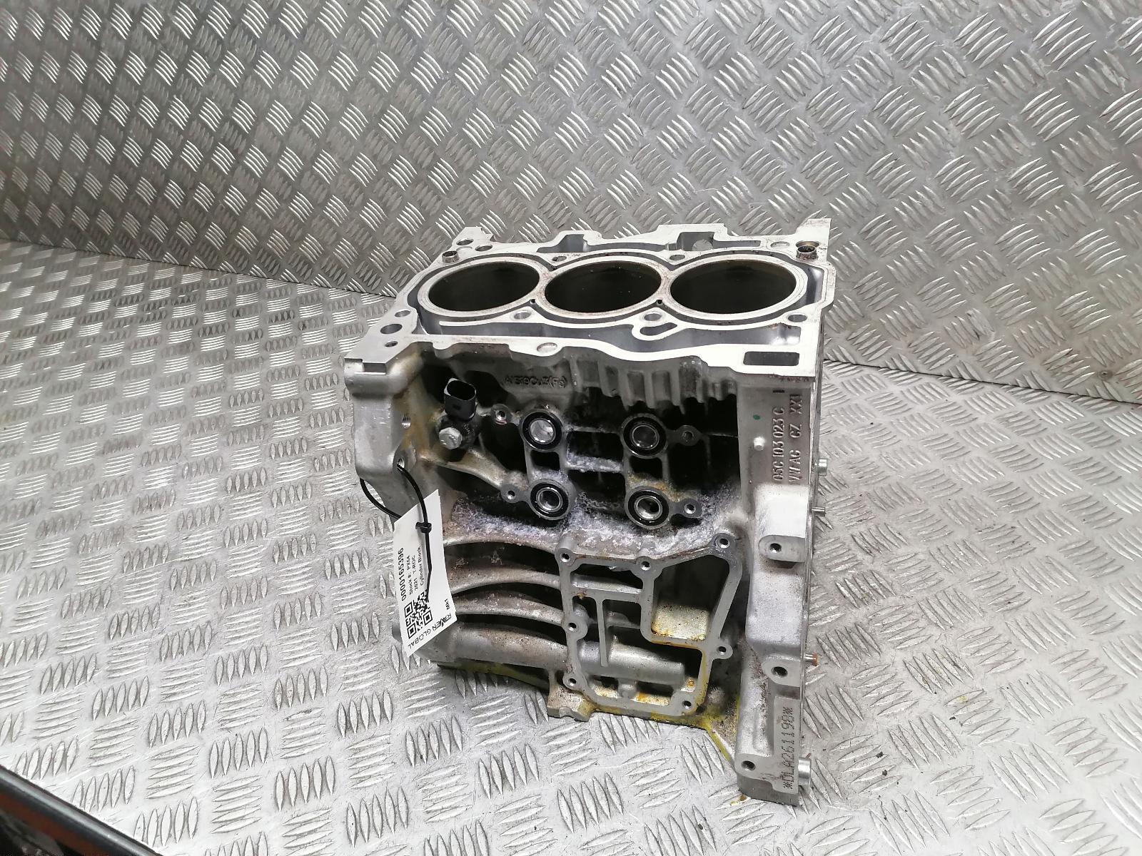

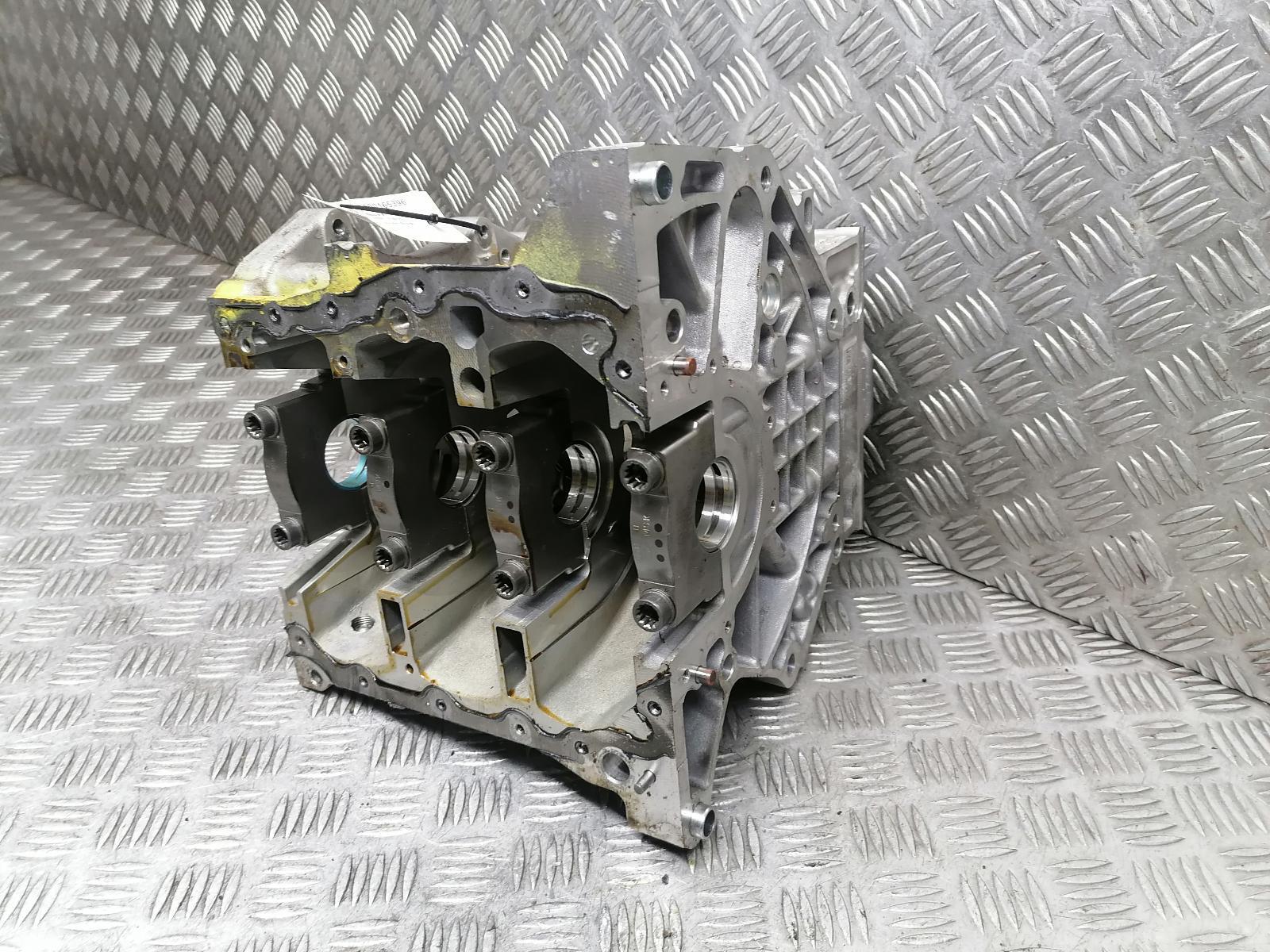

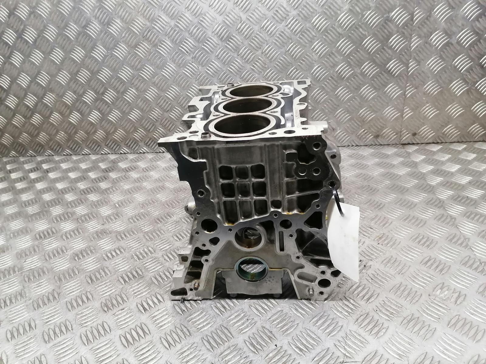

Engine block details of the DLAC. Cracking piece of modern design. Open deck so probably not good for high boost (although same as Golf-R EA888 which seems robust). Piston oil cooling jets. Square-4 pattern with seals on front where oil cooler goes. Single knock sensor to left. Think the threaded holes below the oil cooler are for an air/oil seperator and the charge cooler water pump is in there too. Interesting hollow internal strengthening ribs that go down to the sump line. Casting number 05C 103 023C.
Pics:
1. DLAC Block Front - gearbox goes on the right
2. DLAC Block Top - shows rear of block and gearbox goes on the left
3. DLAC Block Bottom - gearbox goes on left, front of engine is top
4. DLAC Block damper end - not the gearbox end
5. DLAC Block under - shows gearbox end also, top of picture is block front

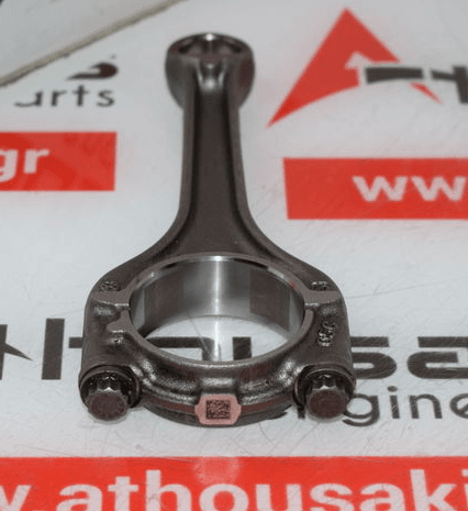

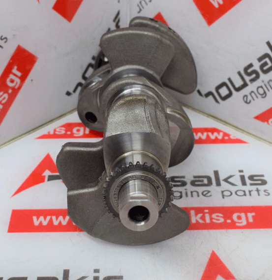

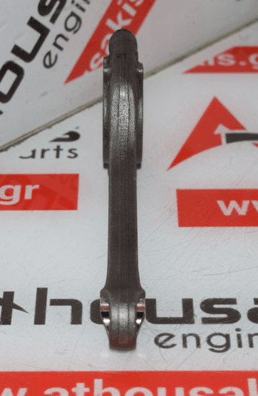

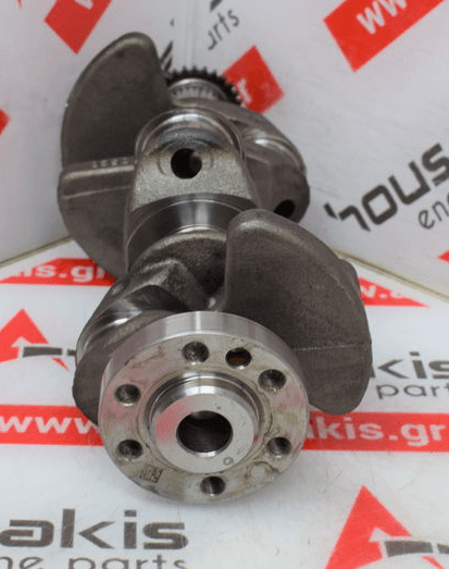

DLAC crank and rods. Apparently a forged crank with hollow journals, 76.4mm stroke, 42mm main and rod journals, 85mm rear seal diameter. Interesting counterweight offset for the 3cyl design. Rods look nothing special, fractured for the end cap, and with a low friction trapezoidal little end.

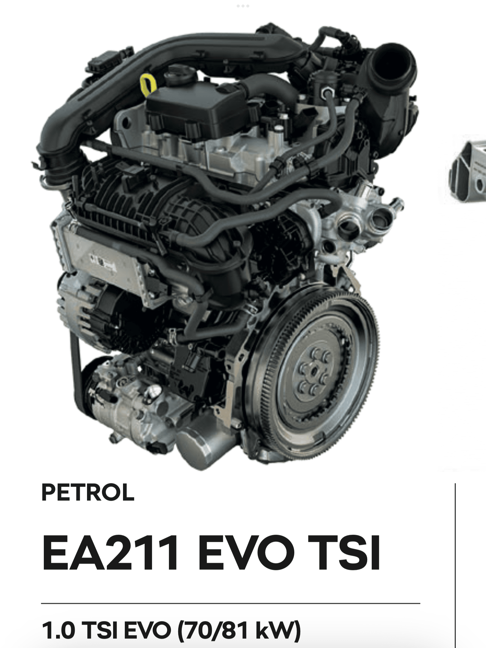

More info. It seems the DLAC is one of the EA211 Evo TSI engines brought in around 2020. New features include:
the 1.0 TSI EVO three-cylinder petrol
engine is very interesting and now
operates in the economical Miller
combustion cycle. With this cycle, its
suction valves close already during
the suction piston stroke, which
reduces the effective compression
ratio, but the expansion ratio remains
unchanged. In this way, the engine
achieves greater efficiency. The engine
features its turbocharger with the
variable geometry of its distribution
vanes, which makes maximum torque
available even at lower engine speeds.
The functional surface of the cylinders
of both EVO petrol engines is
modified by a plasma-applied surface
layer that reduces friction to increase
the engine’s mechanical efficiency.
Depending on the number of cylinders and their power output, the powerplants incorporate various technological elements. The 130 PS (128 hp/96kW) 4-cylinder and the 3-cylinder variants use a combustion process based on the Miller cycle. This helps reduce fuel consumption, particularly at low RPMs, by closing the inlet valves and thus reducing throttle losses. This also enables a high compression ratio, which stands at 12.5:1 in the 4-cylinder and 11.5:1 in the 3-cylinder engine.
To prevent lower fresh gas volume to reduce power output and torque, they use a precise hydraulic system that enables the inlet and exhaust camshafts to be continuously adjusted.
The turbochargers feature variable geometry, which means they can withstand charge pressures up to 2.3 bar (33 psi) in the 130 PS (128 hp/96 kW) 4-cylinder or 2.8 bar (40 psi) in the smaller 3-cylinder.
To increase efficiency, the 1.5 TSI evo also uses the innovative Active Cylinder Management (ACT) technology. It shuts down the second and third cylinders at low to medium RPMs by deactivating injection, ignition, and the valve gear.
All TSI evo engine variations use a highly efficient common rail injection system that runs at a maximum pressure of 350 bar (5,076 psi), delivering up to five injections per cycle. Raw emissions are kept at low levels, and a particulate filter mounted directly downstream of the engine retains almost all remaining harmful particles from the exhaust gas.
The compact units are also extremely light due to the use of lightweight materials like an aluminum crankcase. Thus, the 1.0-liter 3-cylinder only weighs 88 kg (194 lbs).

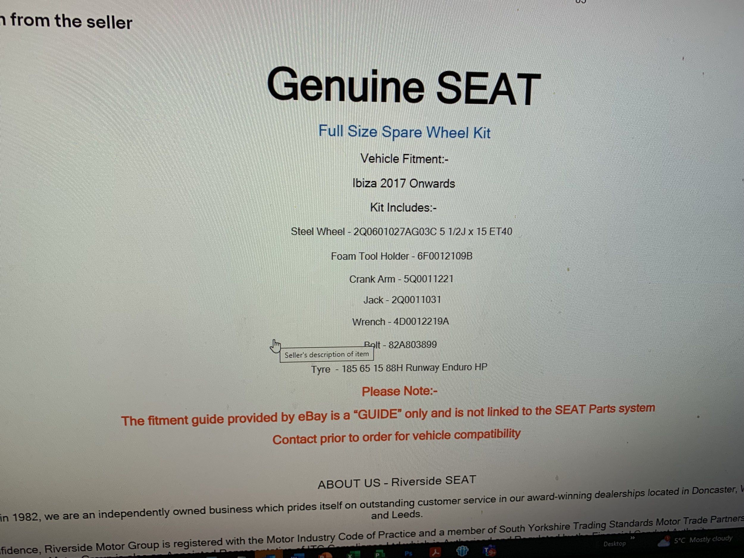

Spare wheel and jack kit sorted, details attached. About £180 delivered. Crazy that a spare wheel isnt fitted with state of roads when there is a space in the rear for one, money saving gone too far. If there is no space thats one thing (like in my Q7 with its massive gangsta wheels) but when there is its just nuts.

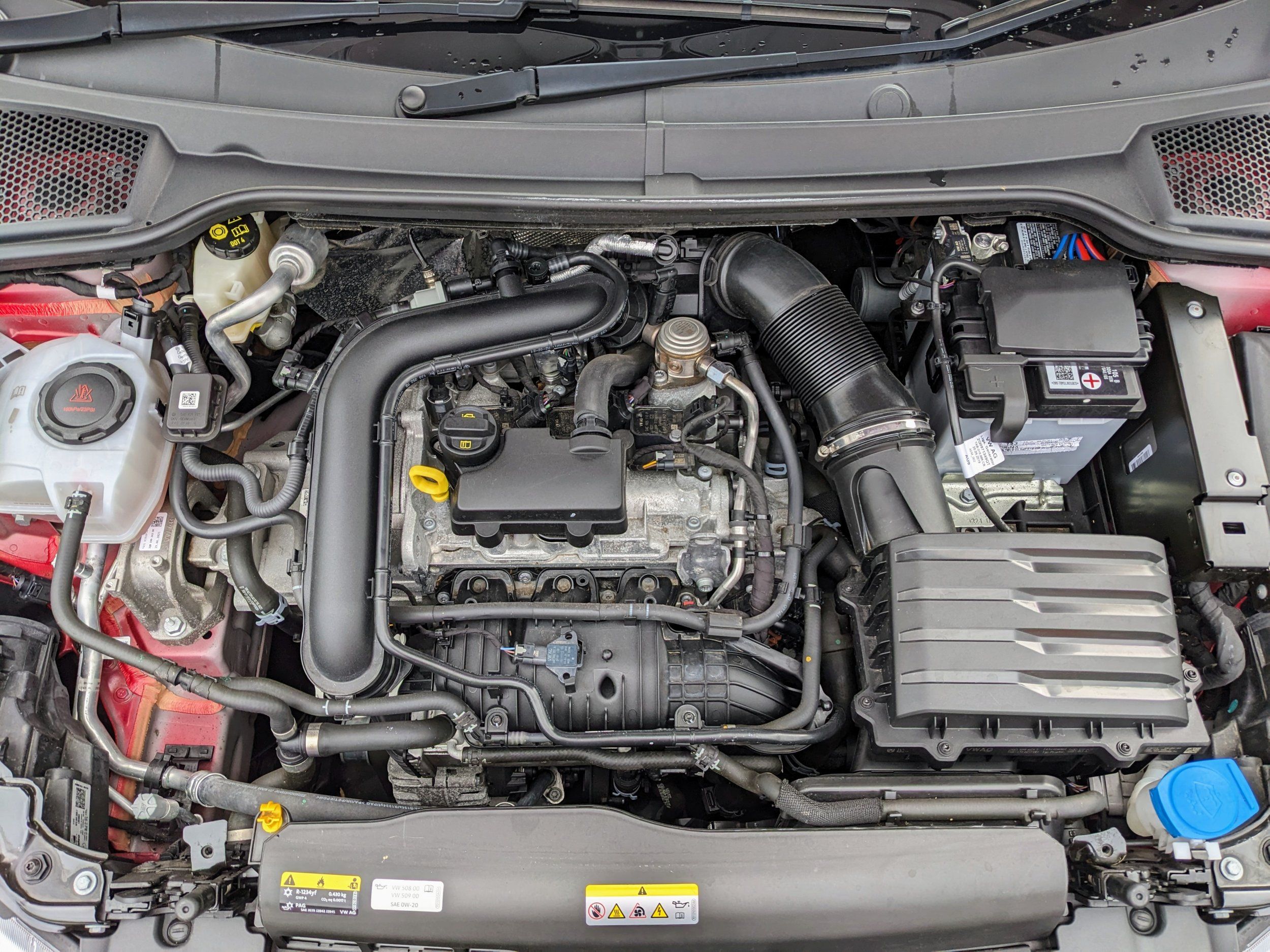

I've got a late 2021 (post-facelift) Ibiza FR (not FR Sport) with the 110PS tune engine, in "Desire Red", which looks great, I think. It has the same Tyres 215/45 R17 Nexen Nblue HD Plus tyres, think they're one of the stock options for the 17" wheels the FR comes with. I think they're okay, but nothing amazing.

Does your version of the engine have the air filter housing on top of the engine, or to the right hand side of it? Mine is like the latter, as I think are all the 1.0 TSI post-2021 facelift engines:

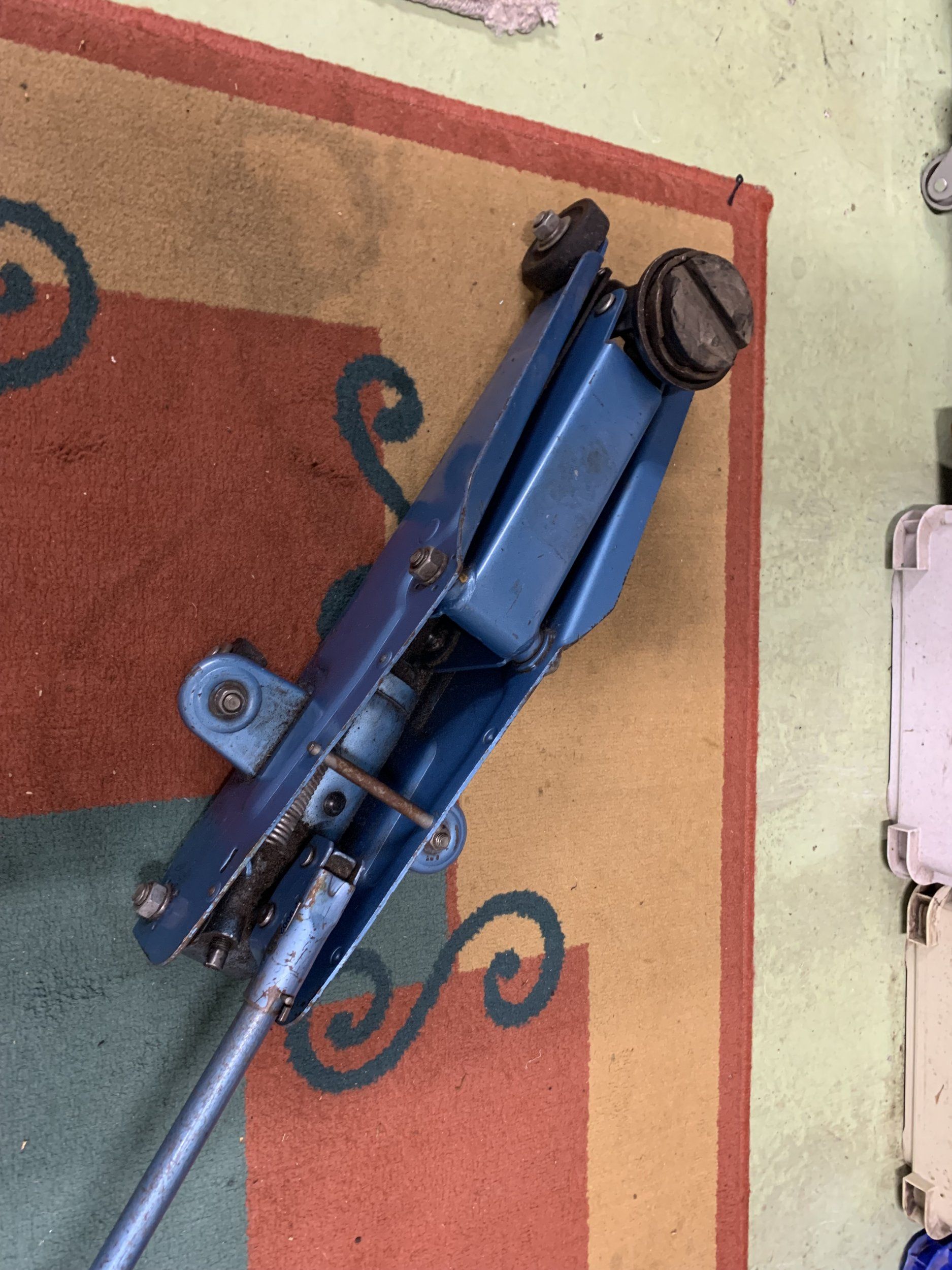

That would be great, I don't have a jack yet, but thinking of getting a low profile Sealey one, maybe this (possibly overkill for a light car like the Ibiza, but looks like it will last):
And a pair of pin-locking jack stands, along with some rubber inserts for them.
One thing I haven't figured out - if you're using the jacking point for the jack, then where do you put the jack stands (given that the jacking point will have the jack under it)?

Your engine looks same as ours, thats the Evo DLA-type engine. Didnt know about rear brakes so thats a useful mod at some point. Added pic of jack to post above. Its nothing special but I've had it for 30yrs. Get a rubber groove block so the jack doesnt damage/flatten the jacking point crease. I didnt let the car sit on the axle stand, kept it on the jack, but just put it next to the jack under the end of the jacking point in case the jack failed, which it didnt.

Re jacks; have a look here. Recommended by a few people I know.
https://www.sgs-engineering.com/garage-equipment/trolley-jacks
