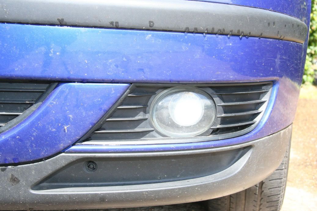

Oh, you mean the outside temperature sensor on your Mk.1 LC has gone mad?
What symptoms is it showing? Low, high, random readings, no reading at all?
It's in the front bumper, somewhere close to the nearside fog light. A small plastic sensor with a rounded end, clips into a round hole. In the standard bumper it looks like this:

i cant believe iv never seen it on the bumper, canrt see for looking:censored: thankssssssssssssssssssssssss.

From what I can tell just looking at diagrams, it's in roughly the same location i.e. offside front bumper near to the foglight. It seems to be mounted behind the grill, so I assume the Mk.2 foglight grills allow air to flow through, unlike most of the Mk.1's.

Ibiza's are based on the Polo, and I guess the Polo puts the sensor in the mirror.
Leon's are based on the Golf, and they all have the outside air temperature sensor in the front bumper, close to the nearside foglight position.
