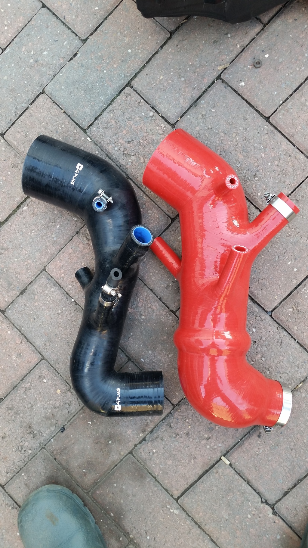

also these over sized tips arent slightly bigger, they are enormous compared to the standard inlet pipes

If the tip is increased then you're basically giving yourself a bigger straw, the maf is the same size but on the oem setup the maf isnt the restrictive part
