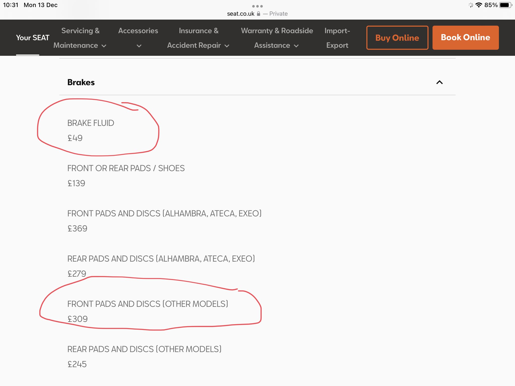

interesting that the dealer you’ve spoken to want £189 for a brake fluid change when the price on Seat’s website is £49. Same with brake discs - price on Seat’s website is £309 for front pads and discs .
