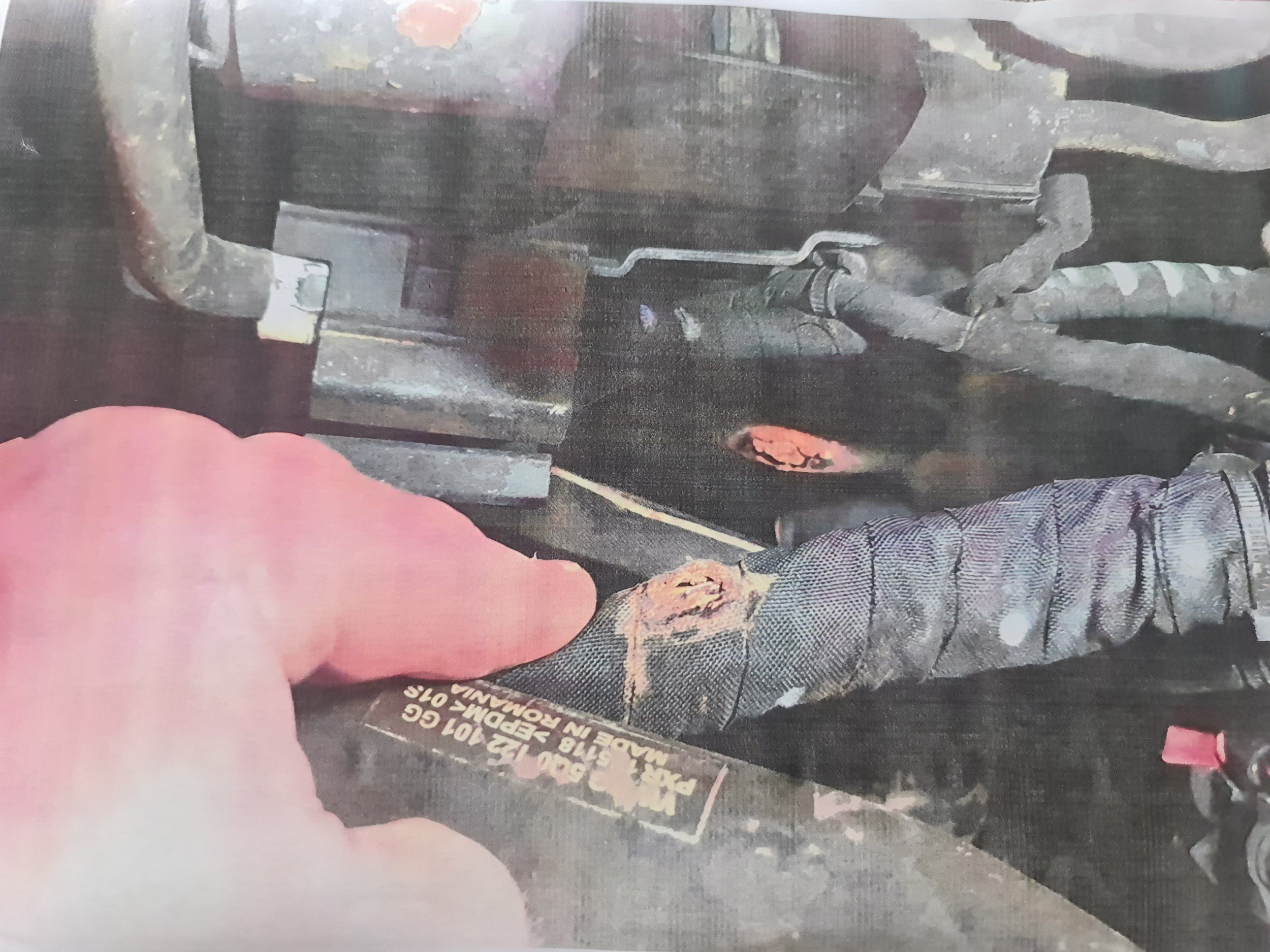

Seeing as this thread appears to be the top Google result for 'P00A300' now...
I replaced the sensor and the fault remained so took it to a local auto electrician. They took the air box off and found that the wiring harness had been rubbing against the bottom of the box and the wire to this sensor had broken. Not sure if this is a common fault?!
All is well now - oh, and it was in limp mode - and the DPF wasn't regenerating either so well worth getting this fixed ASAP if it happens to you
Good to know that you've fixed it, thanks for posting, it may help someone in the future.
