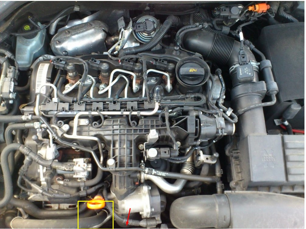

Hi, I have EML on and error code p0113. I have read it could be fault IAT or damaged wires around it.
Does anyone know the location of this?
FR 2009 facelift TDI
Thanks

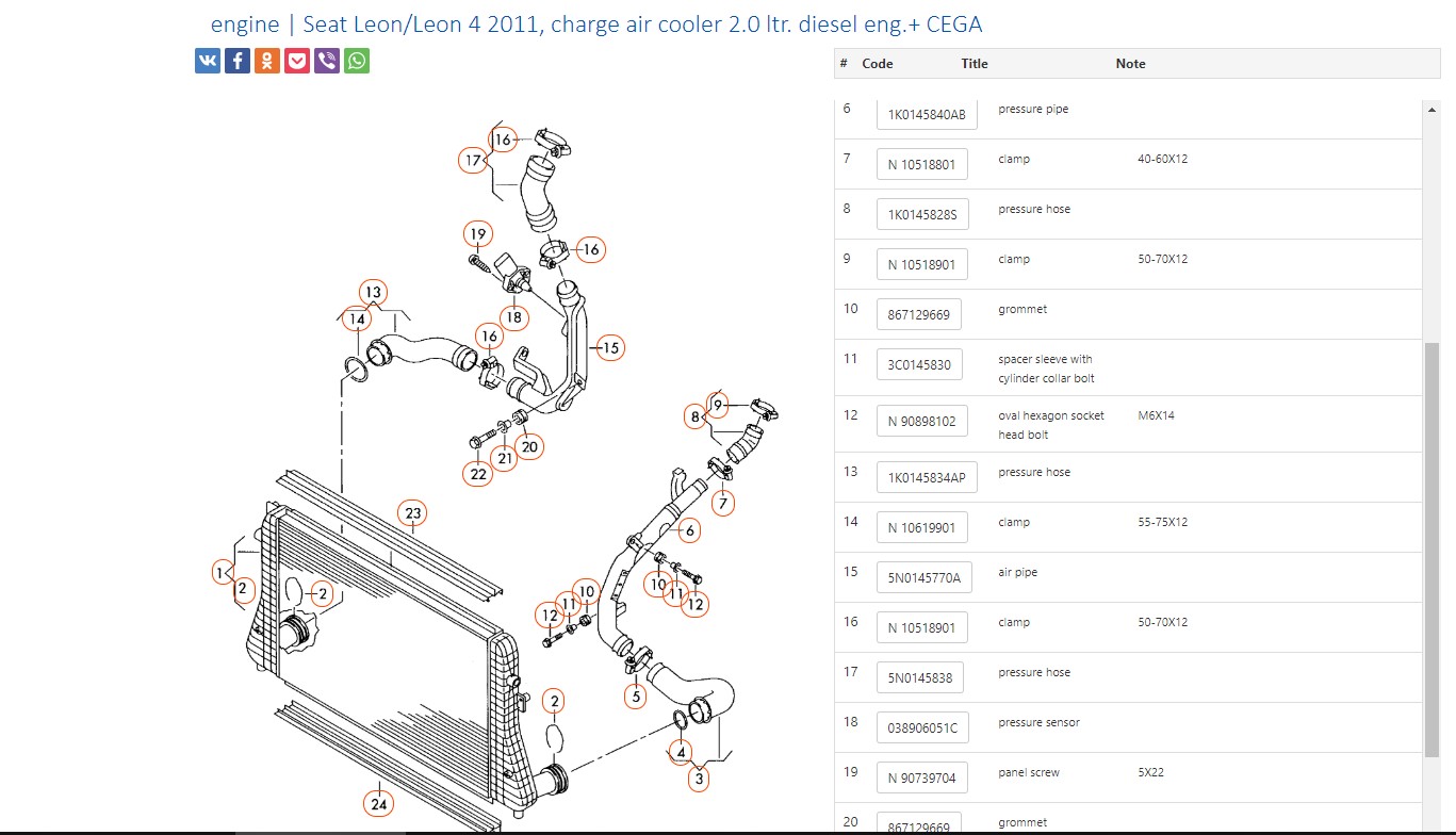

I think that in our car intake temperature is also measured by the MAP sensor. It's located on the pipe that goes from the IC to the manifold intake. Number 18 on the image

Try to look behind the alternator in that square area, follow the pipe marked by the arrow

Where did you get this image from with the part numbers? Is there a website with more part numbers?
