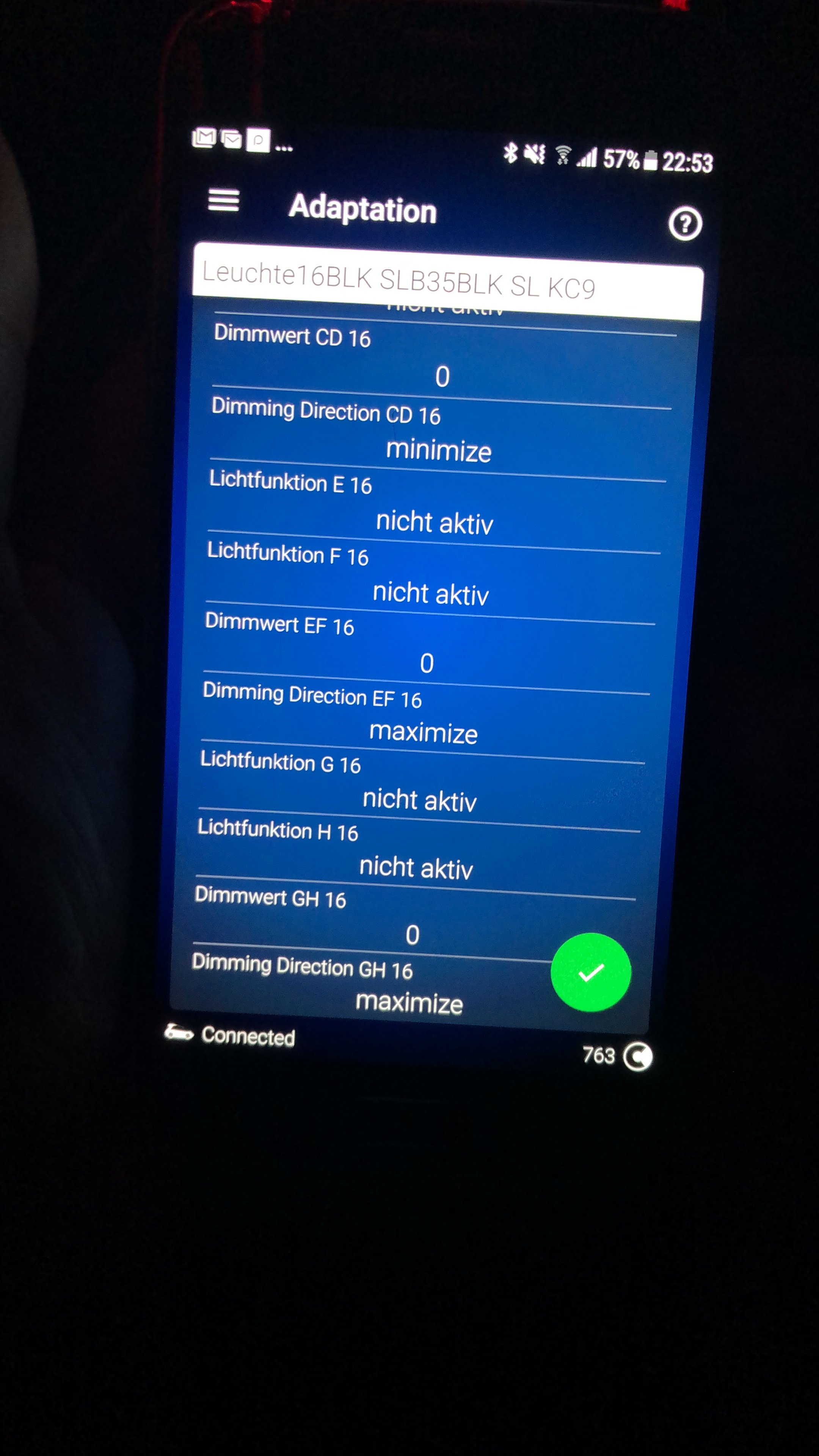

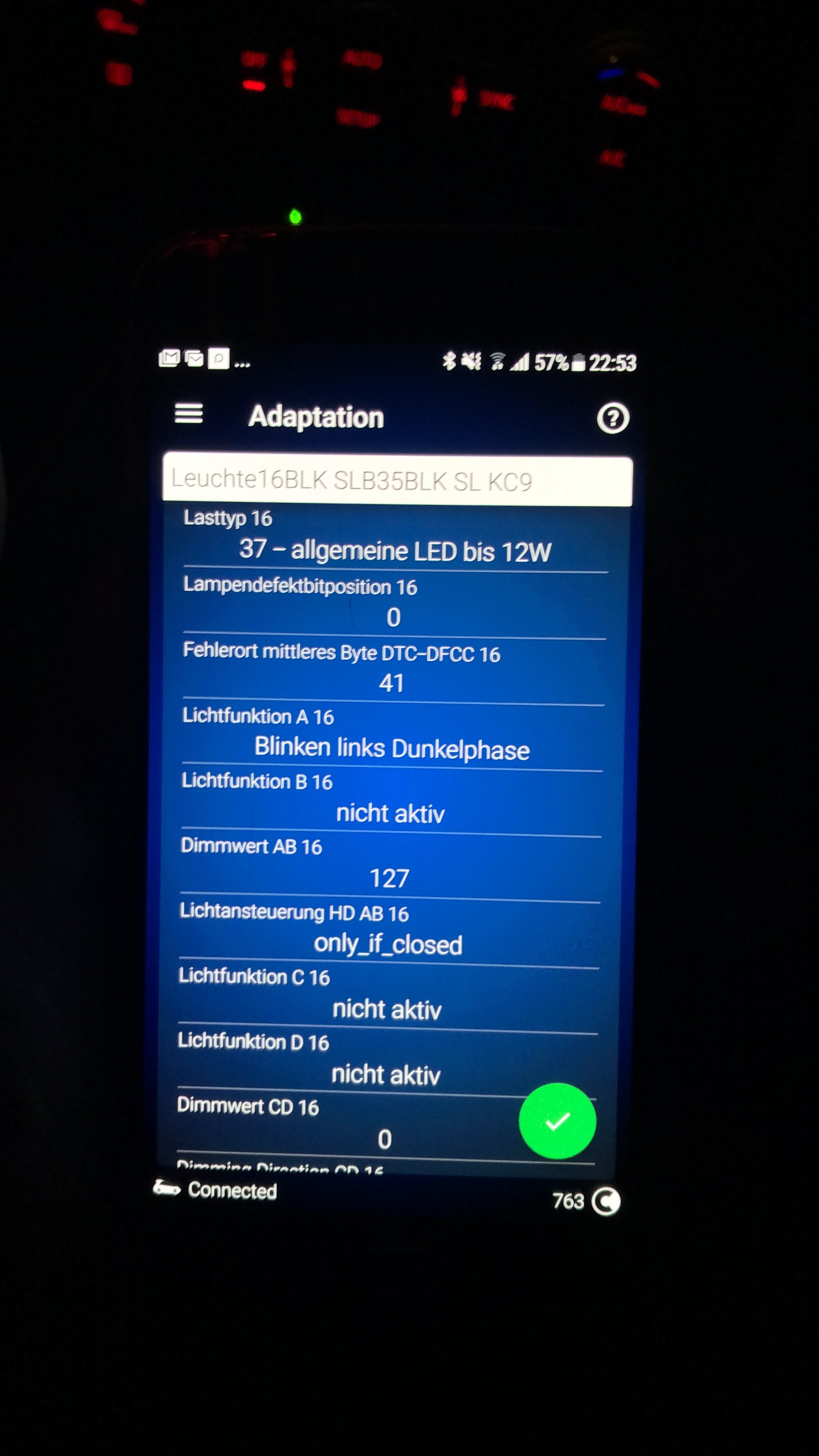

Connect OBD 11
Central electrics
Adaptations
Search for LEUCHTE16
Change your settings to match the following.
Lastyp 16 - 37- allgemeine LED bis 12W
41
Blinken links dunkelphase
Nicht activ
127
Only_if_closed
Nicht activ
Nicht Activ
Minimize
Nicht activ
Nicht activ
Maximize
Nicht activ
Nicht activ
Maximize.
thats your left light complete.

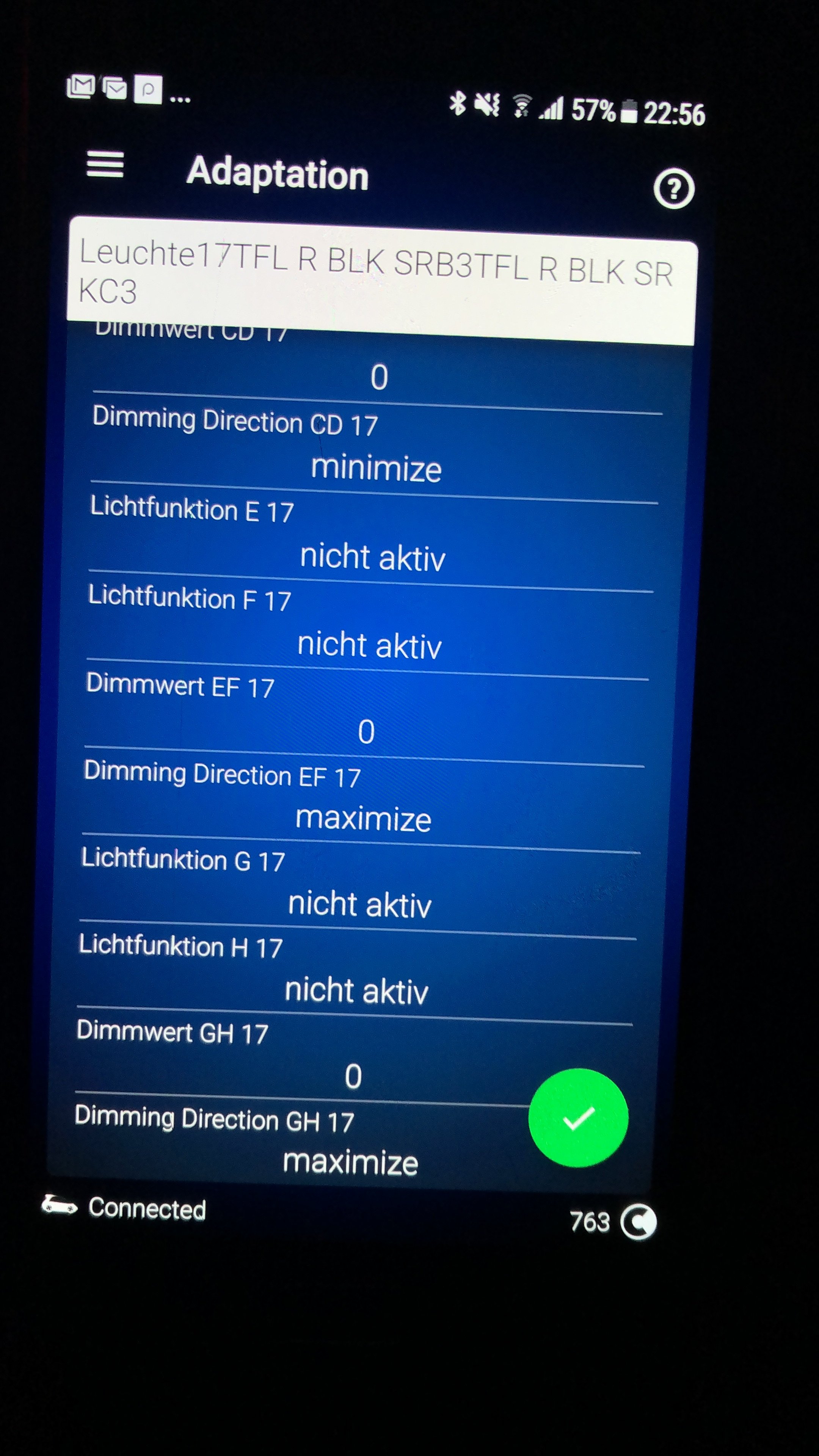

Now go back to adaptations and search for leuchte17
Lastyp17 - 37- allgemeine LED bis 12w
42
Blinken rechts dunkelphase
Nicht activ
127
Only_if_closed
Nicht Activ
Nicht Activ
Minimize
Nicht activ
Nicht Activ
Maximize
Nicht activ
Nicht activ
Maximize.
Select and hold green tick.
you now have pace lights !
refer to pics attached or you can DM if you have any questions
leuchte 16 is for your left rear light
Leuchte 17 is for the right rear light
