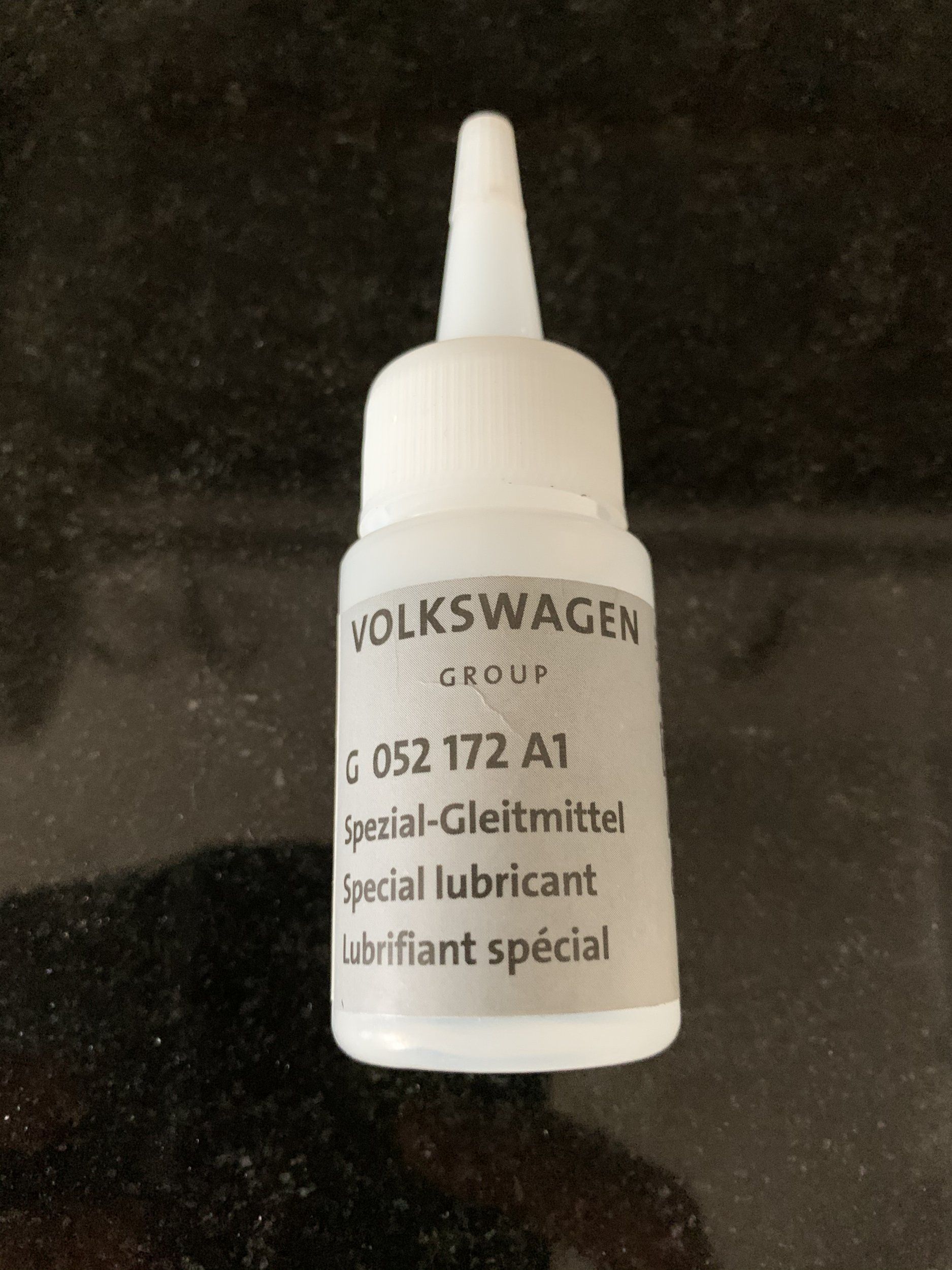

I recommend the VW Krytox lubricant for rubber seals. It’s quite expensive but will last a long time. I use it on all rubber seals including the pano roof.
The pano roof service is something, at least over here, which you have to pay for in addition to the ”normal” service but you can search how to do it yourself. I wasn’t that happy about how the dealer did it last time, but that’s obviously up to you.

Looks like Hampa1 answered it. Basically I've used that grease (quite expensive btw) and plain normal vaseline but on spring and fall I use a rubber conditioner with lots of UV protectants on the seals just to ensure they don't get charred or frozen.
This along a 1.1mm bike cable (the one from shifters) I pass it thru the water passages just to ensure they aren't clogged and they can evacuate all the water that may enter (there are two on the front and two on the rear).
