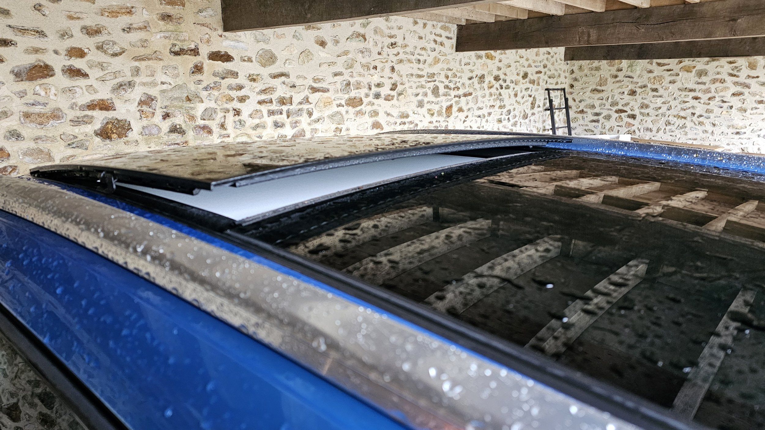

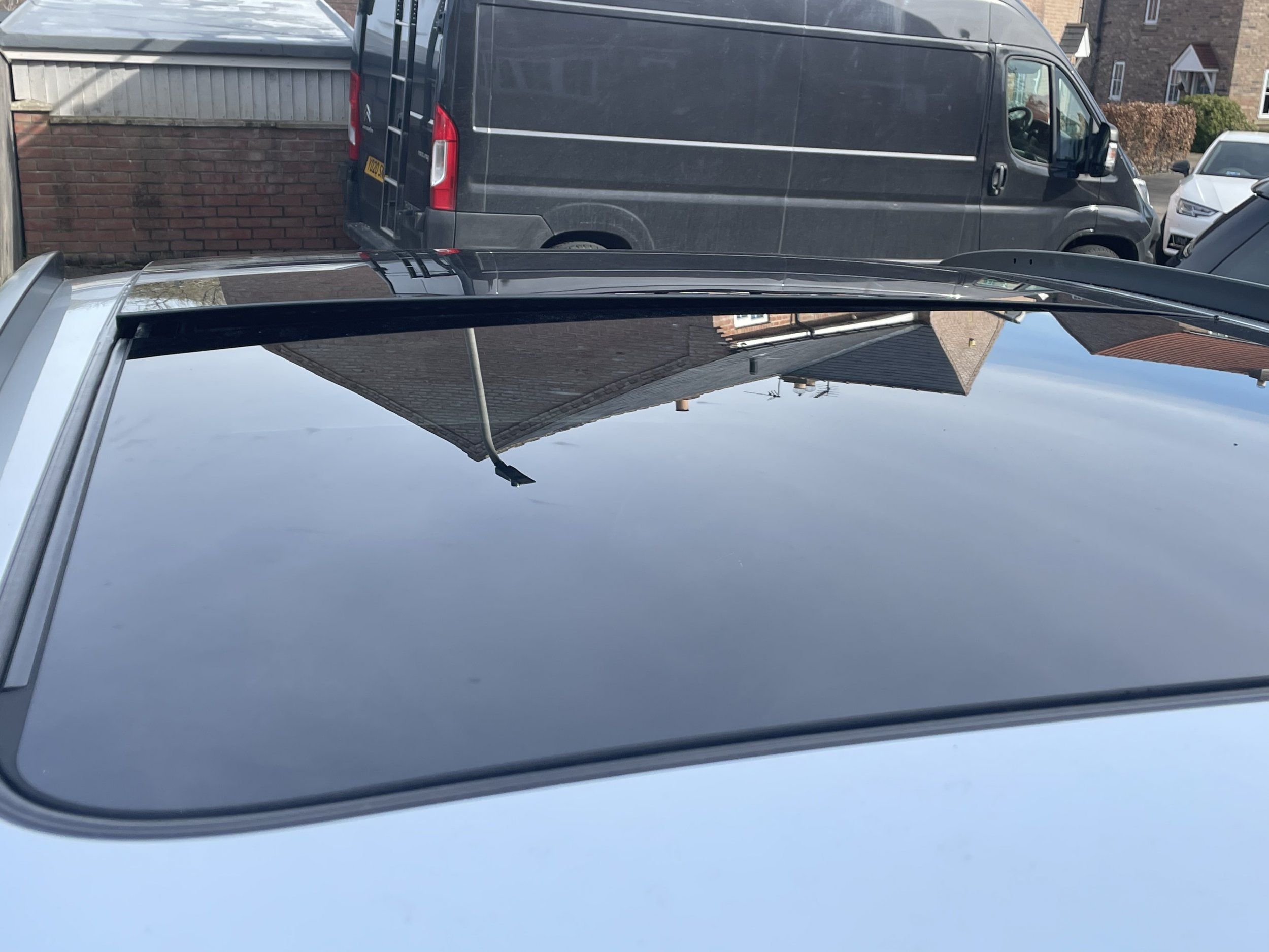

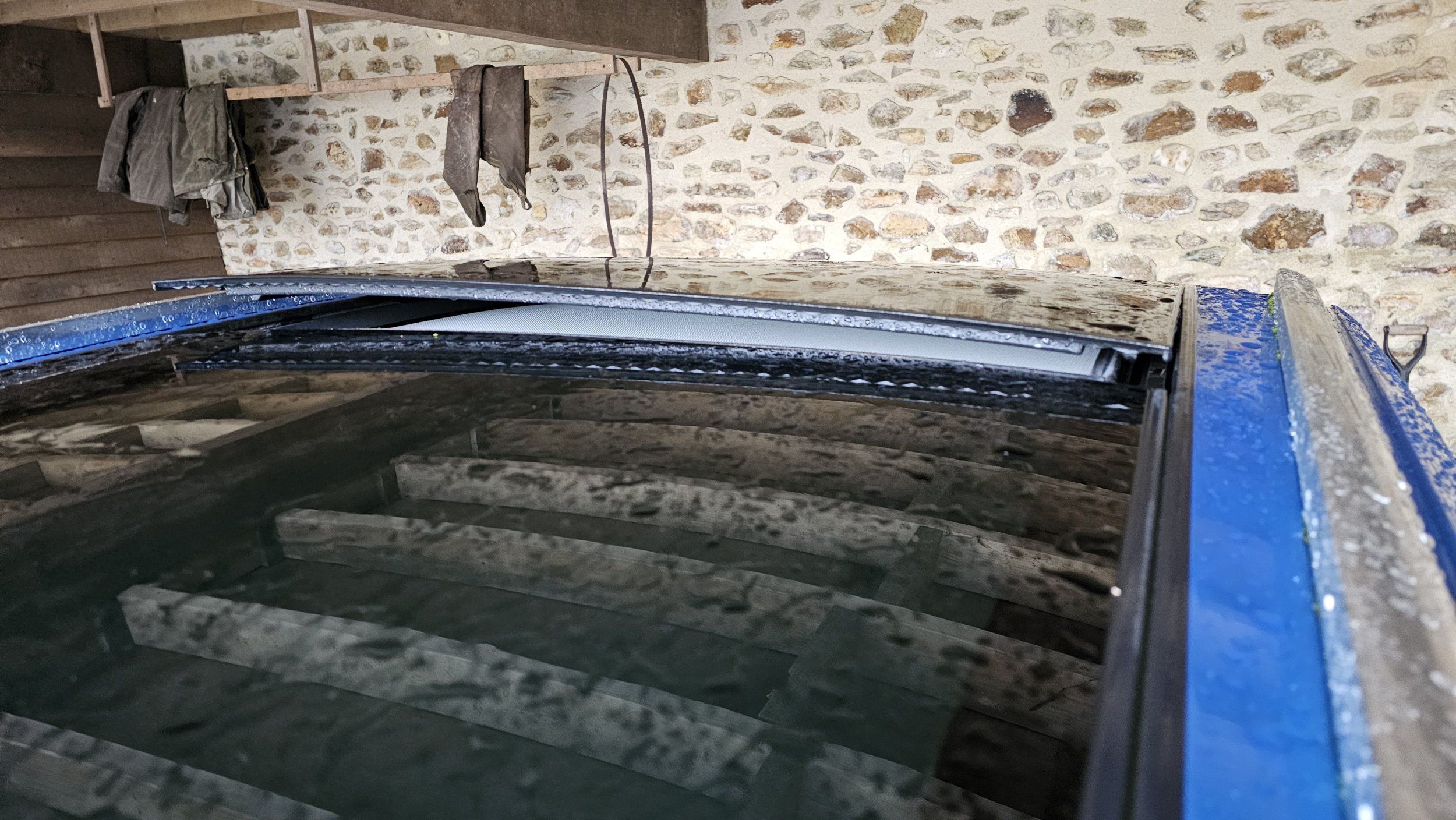

Did you solve this problem ? I had same issue...
Fml ?
Need to find an engineering-minded, old-school mechanic. Appears the glass needs reseating/persuading back into where it should be. Then you can at least use the car whilst considering the remortgage.
A 3k bill to replace the entire sunroof mechanism is a poor show and a grift.
