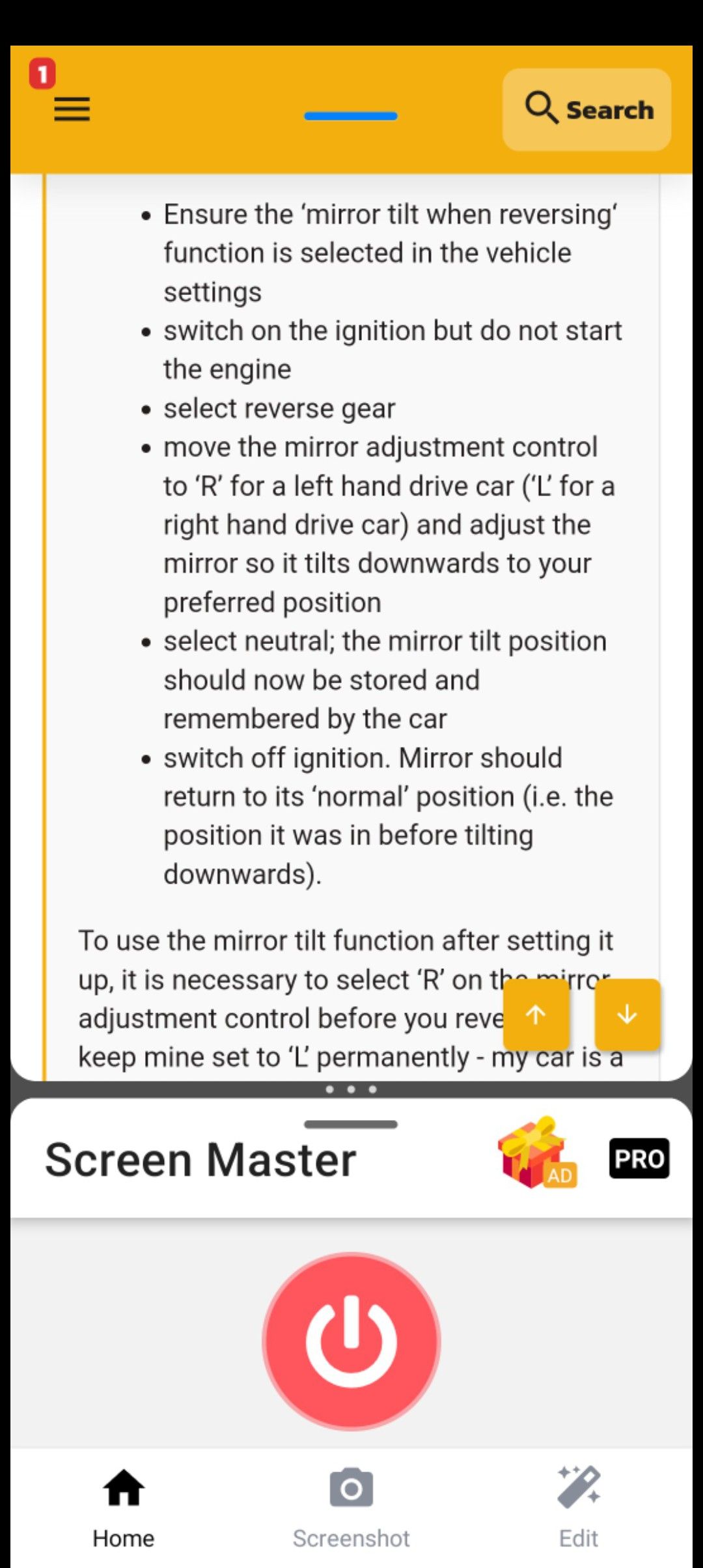

This is a method that works thaknks to someone knowing what he is talking about
