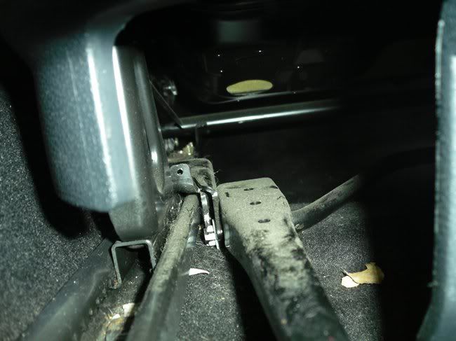

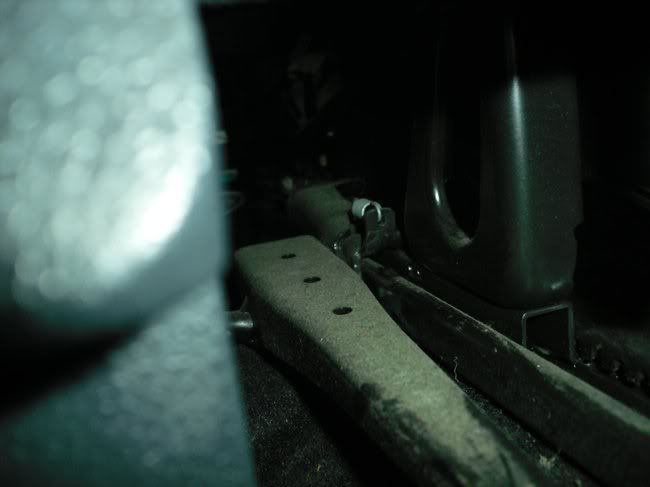

Righty, I've had a good look with a torch and found the problem!
Driver's side mechanism:
Passenger side mechanism:

Which I guess must be the offending spring?
The question now is.... how do I fix it?? I obviously need to order the spring, but it looks like it will be impossible to fit unless I remove the seat. But I'm not sure I can get the socket into undo the funny bolts without the seat moving. Catch 22 situation....

From the photos, it looks as if the latch is lifted by the (missing) spring. If so, (and if there isn't one on the other side), perhaps you could poke with a suitable implement, and lift the latch that way. I picture a long pointy screwdriver or similar. Thinking further, even if there are two latches, one each side, the other is presumably working, so the method should still work.

Yes, it looks like it works that way. I couldn't get it to lift when I tried to move it with a screwdriver when I found it on Sunday, but I'll have another go.
