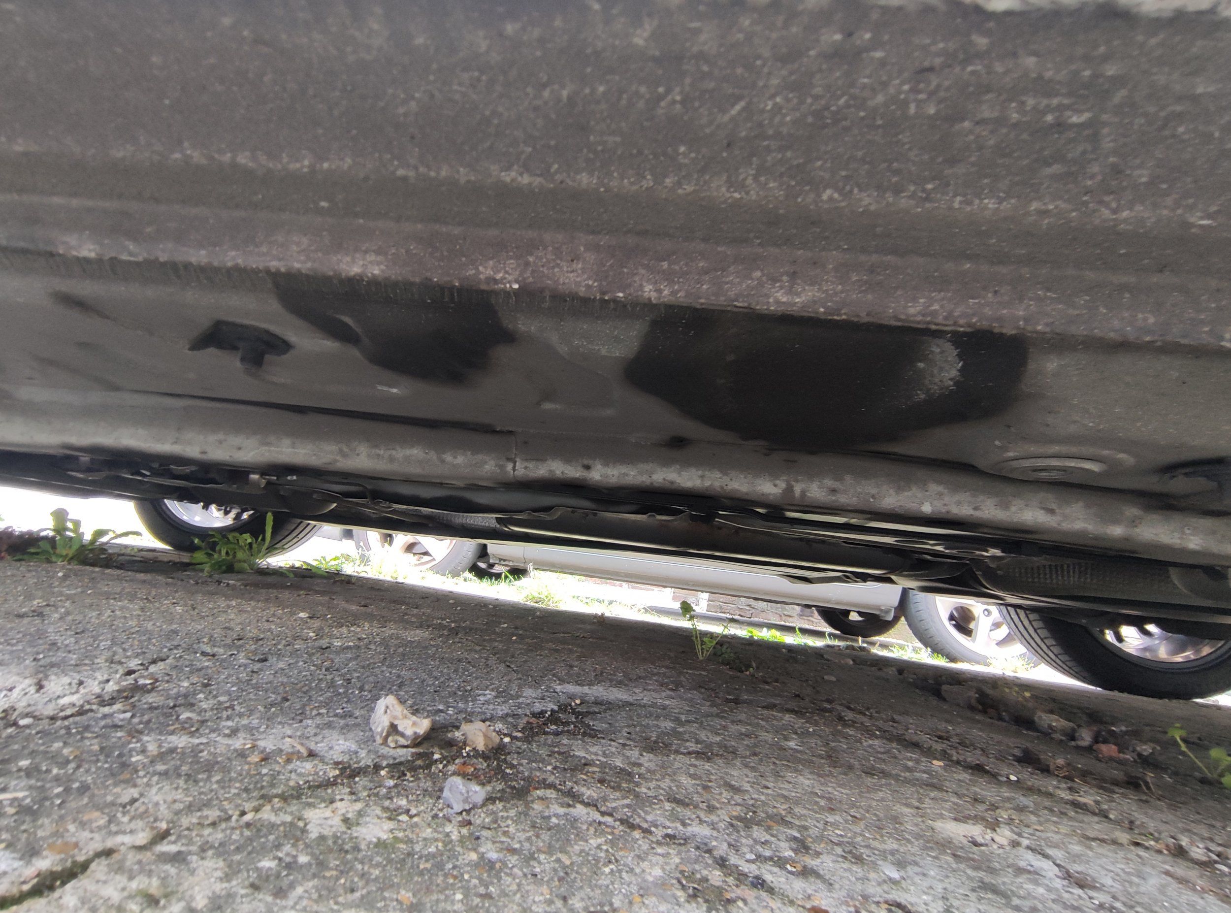

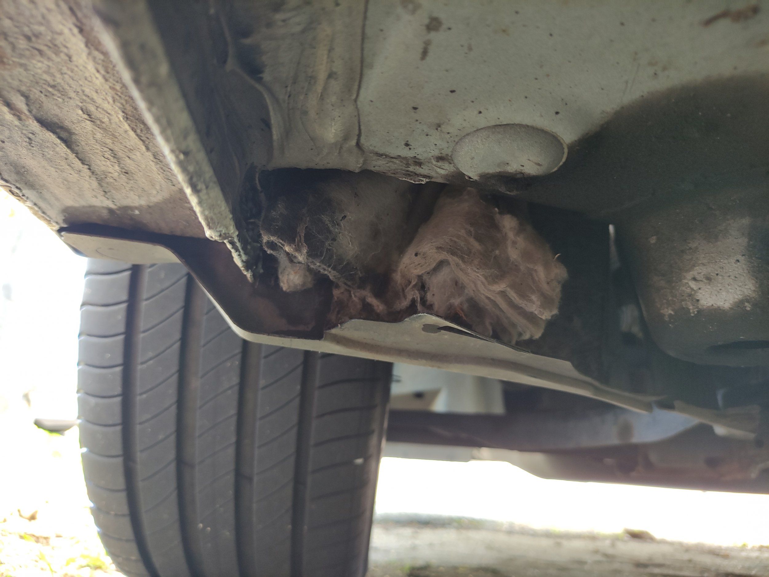

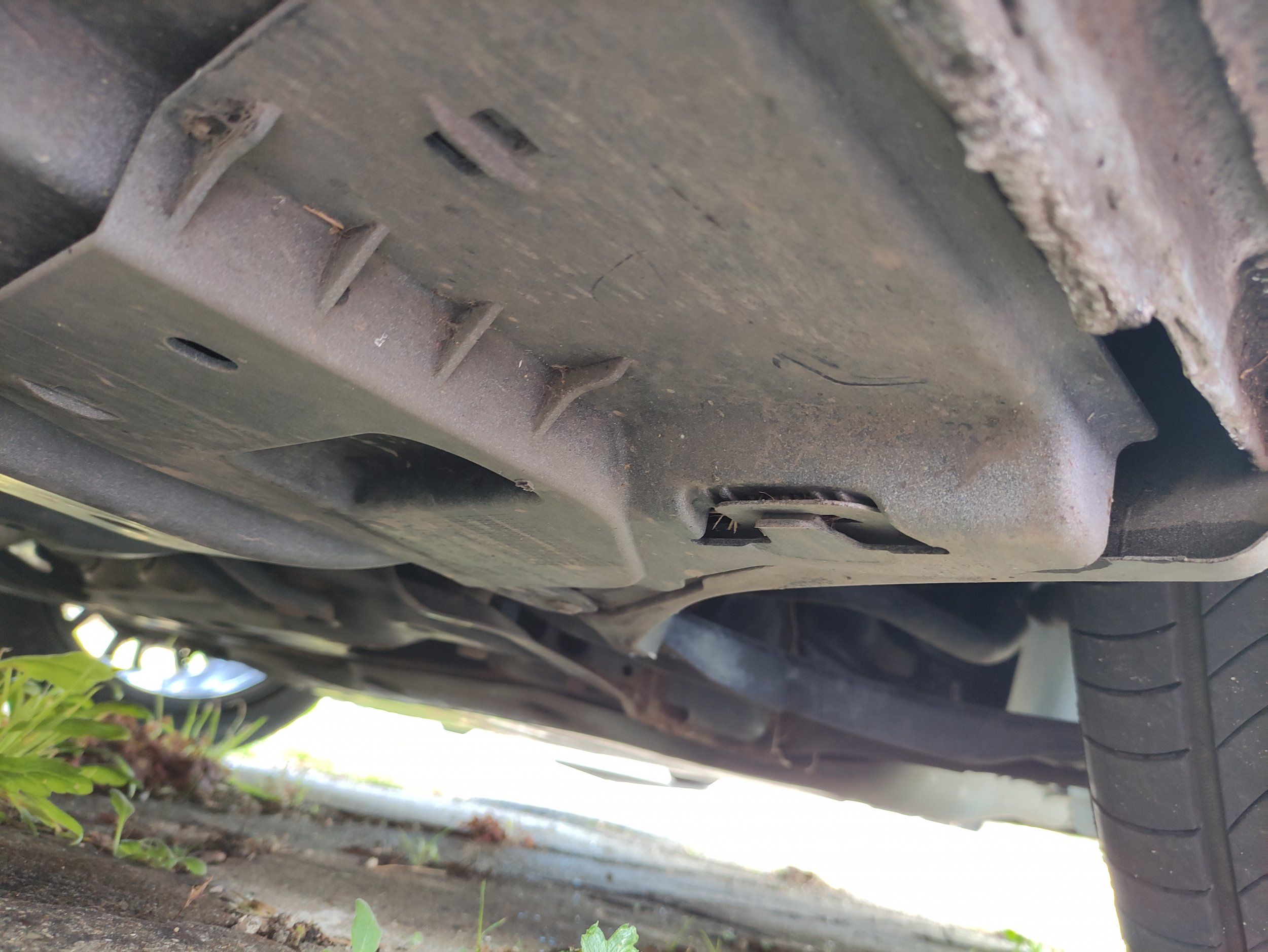

Just bought a 2019 Seat Leon Estate and noticed that I'm missing what appears to be some trim on the passenger side (when comparing to drivers side) The first bit seems to be directly behind the passenger wheel and I noticed it because I saw what looked like some wet insulation hanging down from behind the wheel to the floor. I presume this is some sort of sound proofing? Anyway without the plastic cover the insulation gets wet and I think the glue holding it in fails and it starts to fall out. So I'd like to replace this part.
Finding what the part actually seems difficult. The only thing I've found is on this page: https://www.seatia.com/secon-972.html if you scroll down to the first picture of the wheel area, it's the blue part, which the text describes as: "the guard for the window lifter bracket" but googling that doesn't seem to get me anywhere.
The second missing part is the rest of the side underbody going half way down the car. I'm moderately sure it's this: https://seatdirectparts.co.uk/parts...facelift/seat-leon-2013-2017-side-under-tray/ but not 100%. It's basically the side plastic undertray that runs from the first missing bit halfway down the car.
Any advice on where to source replacements / thoughts appreciated :)
I attached some pictures showing the difference between drivers side (all undertray seems present) to passenger side (side parts missing)

Funny i was doing research into the jacking points on the car and found this thread:
You've found the factory jacking point under that cover. The thread references this video showing a guy replacing this bit of plastic.
There are some part numbers on the video description which might help you. Looks like it's not damaged though so I'm not sure what's causing the issue you're experiencing.

That's very useful thank you.
I think not all cars have insulation stuffed in there (I guess), and as mine does, the lack of the cover means it's got wet and is falling out as you can see in one of my pics. At least I think that's what is happening.
What an incredibly useful website, thanks for the link!
Stupid question - do the brackets demote driver side or passenger side? I'm not familiar with how these things are usually written.
Oh I see it seems brackets mean driver side. Thanks to your link I've found replacement parts online, much appreciated :)
Try and work out how many "retainers" you need and get some of them to avoid having received the undercover panels and have no means to fix them to the car - or are they included as part of the new panels.
