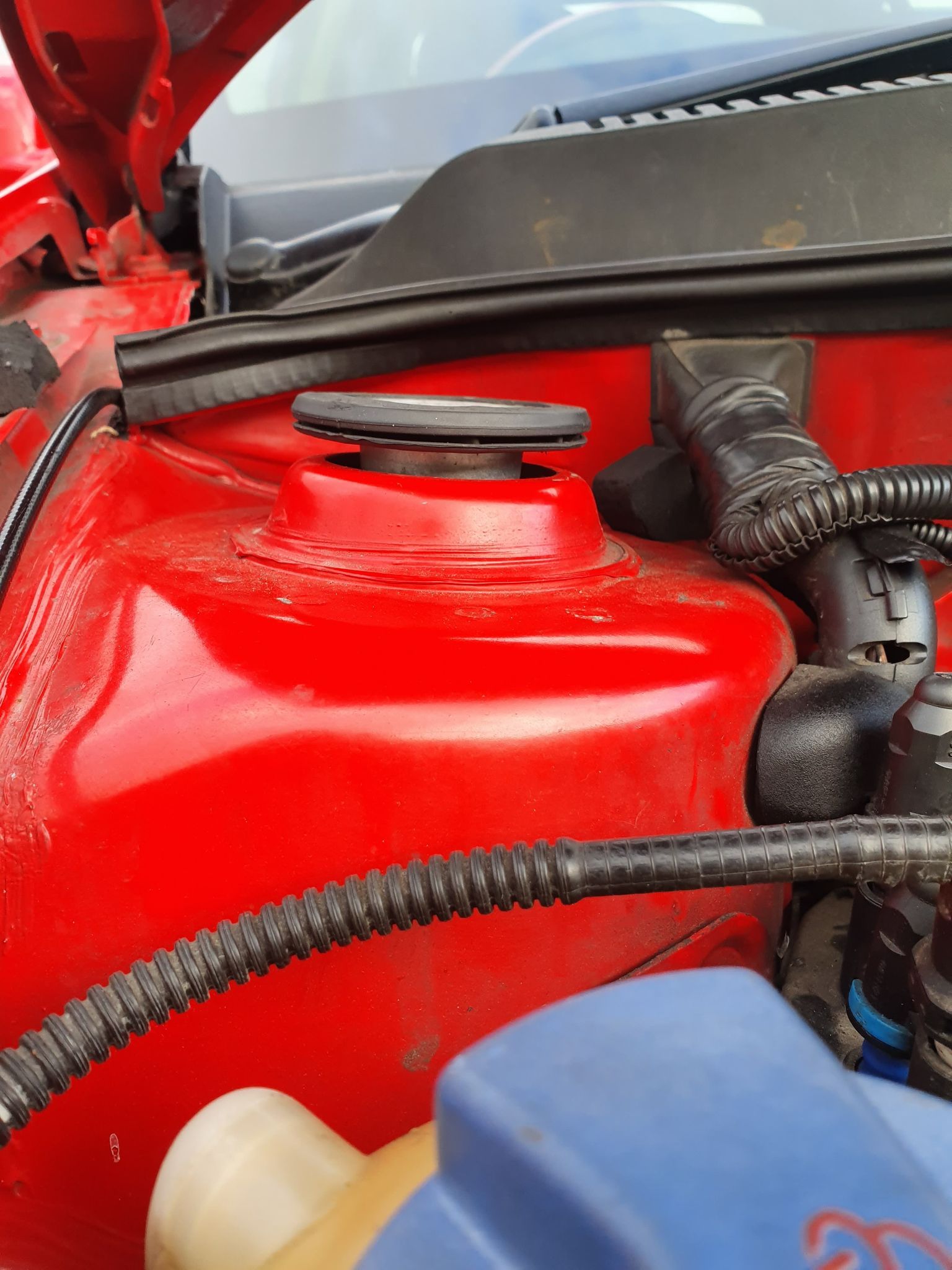

Hey chaps since fitting my coilovers and the aforementioned top mounts I have had a low rumble type knocking on bumpy surfaces.
I’ve changed my arb bushes and droplinks since too, and also taken the shocks out and torqued them back up which seemed to quell the noise a bit.
So I think it’s the top mounts. I have removed the rubber ring on the edge of the top mount cups, as the rubber didn’t sit nicely with the cups.
Since I have noticed the black spacers provided, I can spin freely by hand.
No idea if this is intended, but if the cups aren’t pressing tight on the spacers then what’s the point of them?
Regards
The point of the cup is just to allow the strut to sit higher into the tunnel. I can spin mine freely as well it's perfectly normal. Did you replace the bearings that sit under the bushes while you were there? And did you put plenty of grease on the bushings and surrounding surfaces?

Perfect, I’ve done exactly the same as you. I’ll be honest I have had the front shocks apart a couple of times now and still understand how the cups work lol
It was concerning me that the spacers span
Knocking must be coming from something else then
[mention]SlashProm [/mention] Also I didn’t replace the bearings, they didn’t seem particularly rough when I had them out. Could they knock?
Did you take the strut out completely? If so just make sure they are seated properly into the hub. I'd take a look at the ball joints as well, they aren't that great tbh.
Yeah I took them apart completely and re tightened everything with the help of a vice to steady things this time.
The soft knocking noise remained if not a tiny bit better. Could be worth checking the ball joints, I didn’t consider any parts I hadn’t touched as the noise came with the coilovers/top mounts being fitted.
It’s possible the car being lower is now causing a knocking from elsewhere?
A quick test you can do is jack the car up and try and pull the wheel in and out towards you, this will tell you if there is movement in the balljoint. After that take the wheel off the hub and try moving the hub up and down, I wouldn't have thought it will move as this is usually the problem you get with worn top mount bushes. But it might just highlight whatever is knocking while your pushing and pulling at things.
