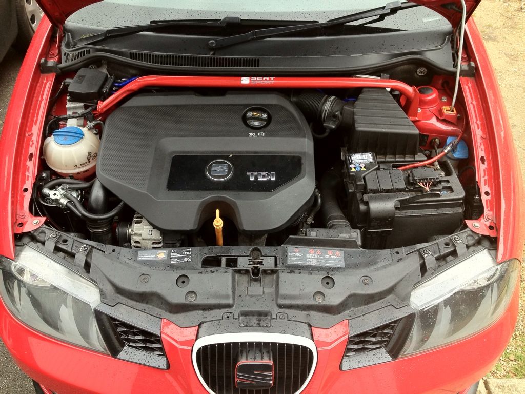

Here's the strut brace tho:
Nope mines not bolted?? It just pushes in and the reason it's came out is the pressure has become high now due to the blanking plate and it's popped out. The only thing stopping it from coming out is a little flare on the flexi

Odd, all the ones Ive seen bolt on. I'll check my mates BLT at the weekend
