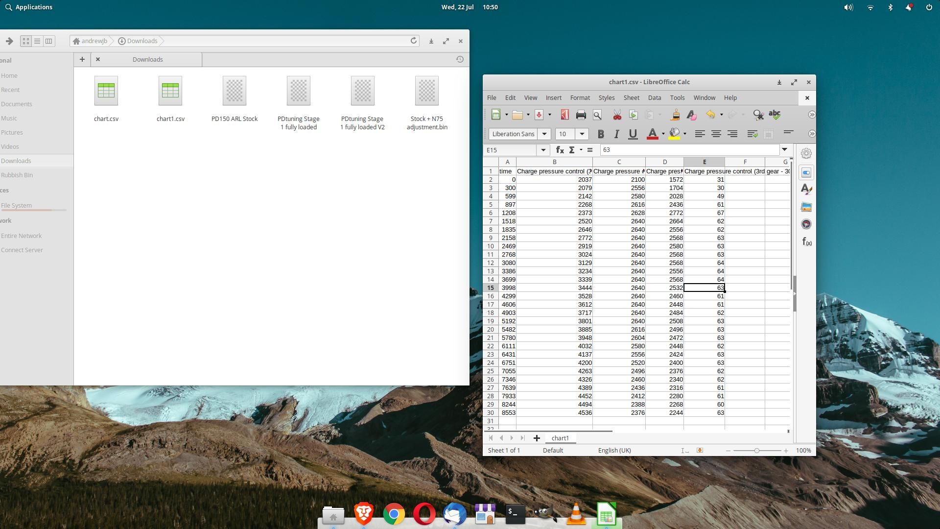

So spent about 2 hours last night doing some remote tuning with PDtuning then I got told off my the missus so had to resume this morning.
So far I've done 14 runs (14 different data .csv) on 4 different files.
First file is Stock OEM SEAT file, 2nd file is Stock + N75 adjustments, 3rd is a Stage 1 file and 4th is a second version of that file. Very much doubt the original tuner of this car went to this "extreme" when tuning it. I reckon they flashed a map and that was it.
Were looking to smooth out a slight boost spike at 1200rpm and then we will turn the boost up slightly for a little more power!
At the moment the car is pretty smokeless as well, I do want a little smoke at the end but nothing excessive (I had a pure smoke map on my PD170 years ago).
Eventually might bang a GT1752 turbo on it!
