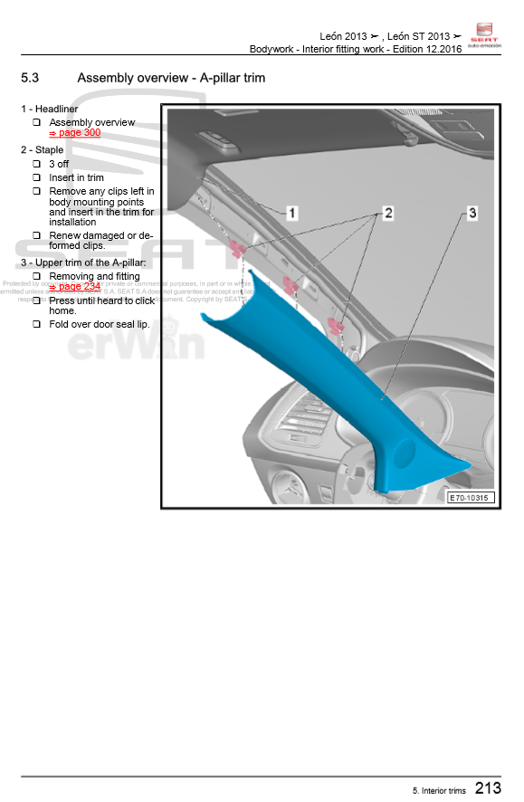

Areas that generally create the most rattles/noise are the A-pillars either side of the windscreen - prise theses off with a trim removal tool, and apply felt tape around the bottom of the A-pillars where they meet the dash.
The second area is where all of the plastic sections join either side of the transmission tunnel either side of the gear lever - no need to strip apart just apply 100mm strips where the top of the transmission tunnel plastic overlaps the side sections.

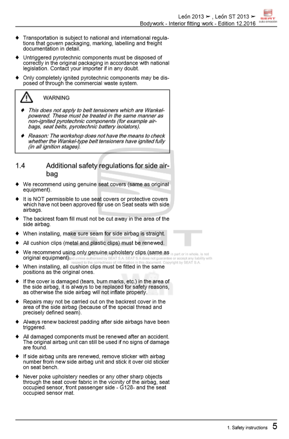

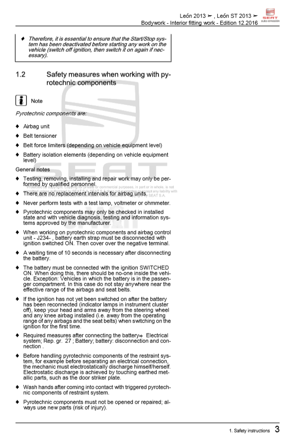

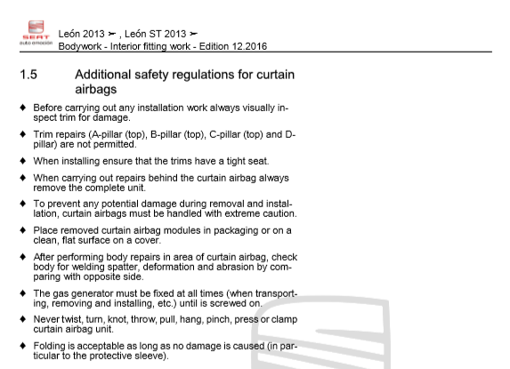

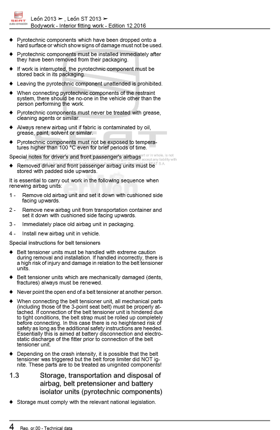

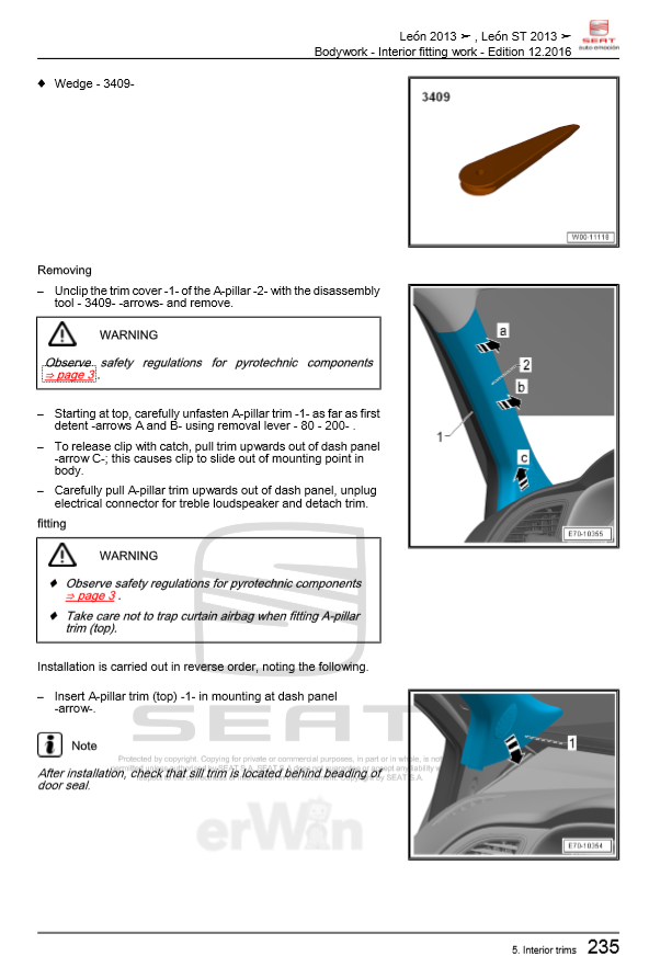

When you prised off the a pillar, did you disconnect the battery to stop the curtain airbag from potentially deploying? I've been wanting to remove it to run my dashcam cable down the inside it but am worried of setting off the airbag, do you happen to have any pictures of it once removed?
That's a very good idea to stick the felt tape onto it, I currently have no rattles from the a pillar but nice to know of a solution that fixes it if it appears!
Information is above. I'm not certain for all models, but I'm fairly sure that my 2013 FR doesn't have any curtain airbags under the A-pillars; mine are in the B-Pillars / Front Seats / Dash.
