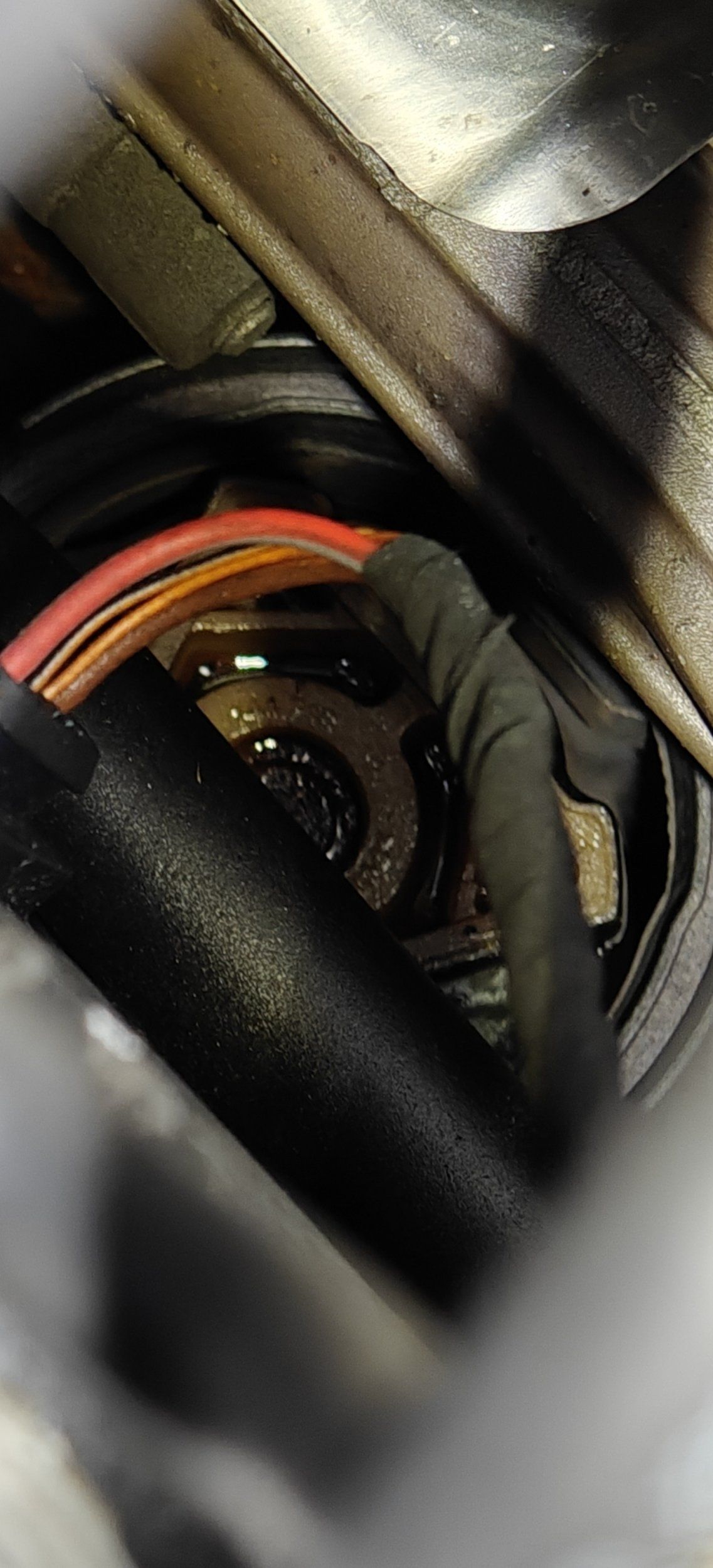

I have since learnt about the common coolant issues on these engines so I am keeping a close eye on mine, I was poking underneath the car and bonnet and couldn't spot anything obvious but the front end was oily in places ( I suspect gearbox or diff oil has been spilt and wiped away) however I did spot this random part sat in oil. Anyone know what it is and should it be like this?? It looks exposed

That looks like an engine/gearbox mount/bush with some oil on it from when they removed the filter.
I think the filter is in the circular silver ribbed bit (in your first photo) so likely to have made a bit of mess on removal.
It looks tight, but might be worth trying to get a rag in there to wipe the oil up and check it after a little while to see if stays dry.

best thing to clean that up is brake cleaner. Get spraying down there and it will all be cleaned out.
Cheers all I knew I had seen it before which must have been when I was reading into upgrading the engine mounts. That has put my mind at rest
I'd clean it ASAP. Oil causes the rubber to soften and eventually decompose.
