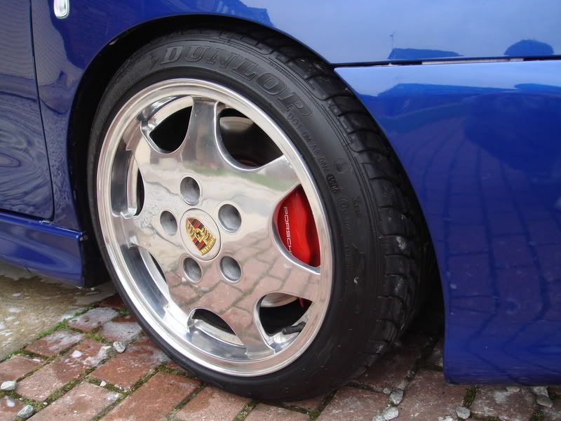

someone in hull got them, he on here too - cupra44
996 turbo calipers (big red's) & Cupra R disc's (305mm)
heres a piccy
(sorry will, thought i'd nick em and use them on here)
Yes I am running 305mm discs from the cupra R, and if anyone wants my calipers there are for sale on edition 38 for 375 0n0 delivered, CALIPERS ONLY !!! Thanks
Front's and they are massive I'm only selling because they don't fit under my new porsche wheels, these are known as 996 monoblocks
How come nobody found out about this ages ago that the porsche calipers just fit straight on with no other modification needed? seems abit too good to be true, now off the the scrap yards we all go in search of some porsche calipers lol. exactly what model doe they come off? What type of clearance issue do they have as they look massive? ie what wheels will they fit behind, standard cupra 16" or wheels that suite the likes of wilwood or brembo.
