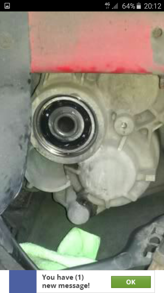

I've just popped the inspection cover off to see if the shaft moves in and out, lone behold the undertray is FULL of box oil, the shaft bearing cover is missing! I have no idea if there'sa drop of fluid in there! Its too late to drain and refil etc...

Question? Testing the shaft movement, the larger outer circlip moves back and forth, the smaller inner clip and tube like shaft is tight, What one is the o2m going to shim? Small or large outer circlip??
Yes, but theres 2 clips, one is on the smaller shaft (10p sized roughly) and a large one right on the outer silver ring (tennis ball sized)
I watched the tutorial on YouTube, (if you can call it a tutorial) and the box was different looking, He removed the huge outer circlip?
It's the big one mate. Bit of a bitch to get to lock in once shims on but goes in the end.
Yes just watched it again and I am happy its the larger one, I will fit it tomorrow along with a fluid topup, Lets hope the box is cured..... I will report back
Fingers crossed mate. If you haven't got needle nose pliers you can do it with 2 flat head screw drivers to spread the clip open and onto the shaft. Sounds kinky lol
