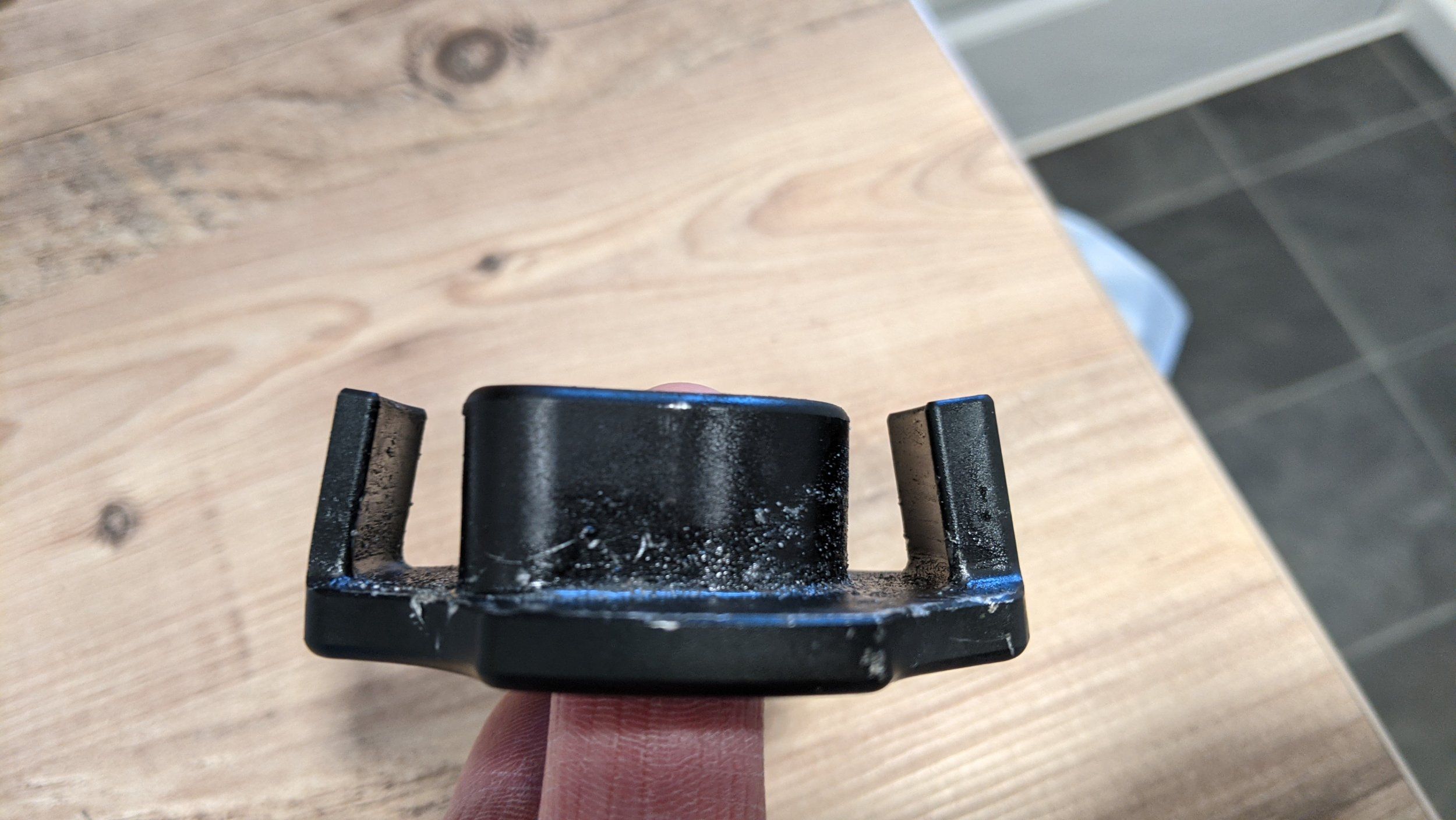

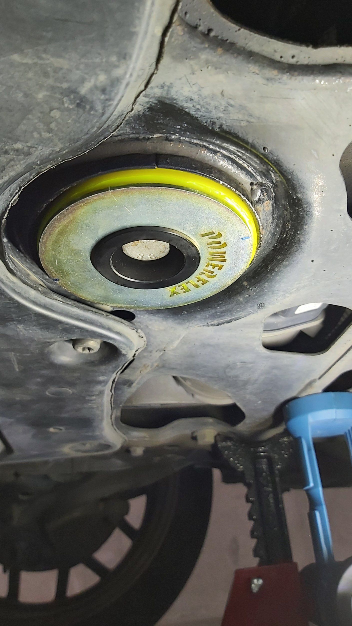

Hi all, just installed powerflex insert on my seat leon.
First impressions are very good, small amount of vibration at idle and reverse nothing major though.
No wheel hop when i give it stick anymore, car feels a lot more positive and tight.
I used car ramps to install. Greased insert up got it in position, used a pry bar to lever against subframe and engine, insert was then squeezed in bit by bit and then i undid the bolt put the collar and washer inplace and torqued back to 100 ish nm.
The insert will bed in over time and vibrations should minimize not that there is much in the first place. So happy days
