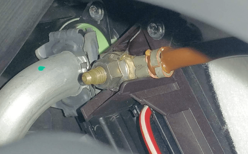

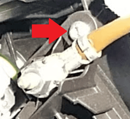

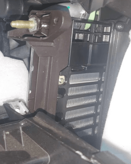

I've got the same car as you and have the same wiring. Mine looks clean though and like you say, the burning/overheat could suggest a bad earth.

I will double check - i'm pretty sure I noticed this and re-adjusted the ring terminal - but if this is the issue then it is shocking design to not have the ring terminal restrained
Another possibility is that the ring terminal crimp is not perfectly tight and a small amount of resistance is present and the heating effect of current through this small resistance is creating the heat. Can you solder rhe copper wire to the ring connector thus eliminating any possibility of this resitance if not try sqeezing the crimp connector with a pair of pliers.

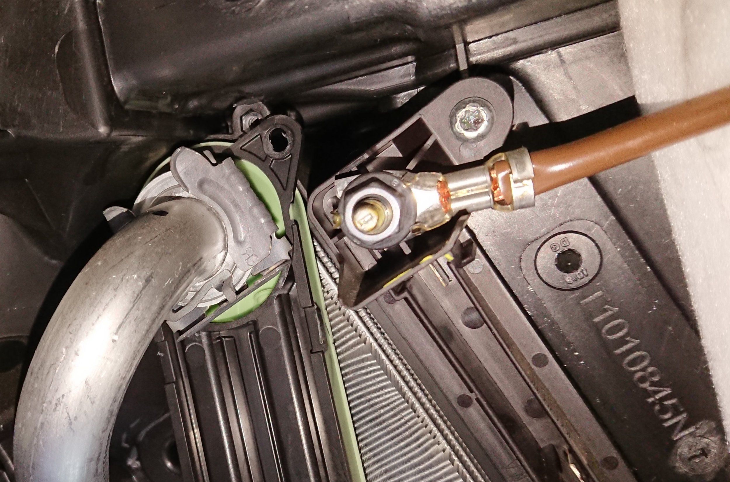

Double checking and yes the ring terminal isn't touching the bolt. Was an older photo I shared.
You can see the insulation by the crimp has bubbled so must have got very hot! This photo is just peaking through the glove box.
The crimp does look well 'crimped' when I have time next I will try checking the resistance from the terminal to earth and to the cable to see if there is a bad connection/high resistance?

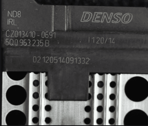

Looking in the Seat Manual I can confirm the large brown wire is an earth as suspected.

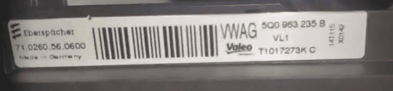

I have looked at a couple of resources and can't find any recall for my car Reg. There is a recall on Audi Q5/A4 I can see on the PTC aux heater.
I have also found there is 3x supersessions of OE numbers
5Q0963235 Denso
5Q0963235B Denso
5Q0963235C Valeo
And the comment: Dropped: Jan 1, 2016 (EKZ: L)
Maybe worth a phone call to Seat.

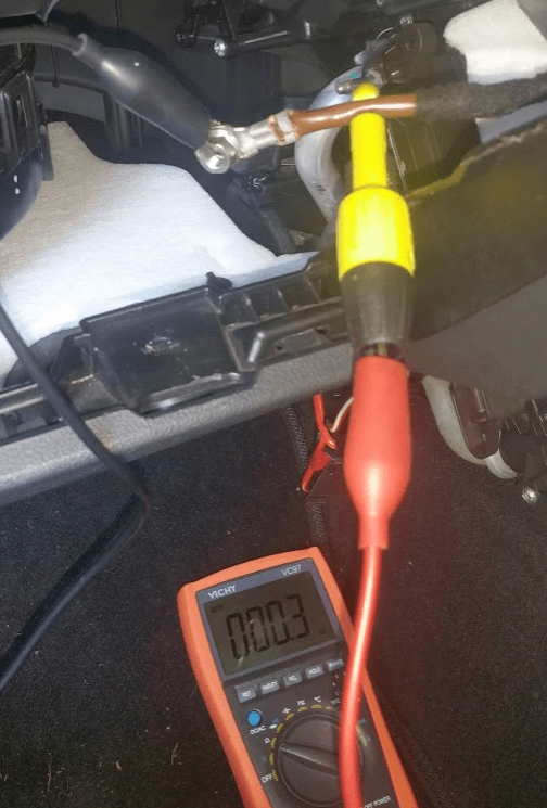

Thank you for this, I tried measuring the resistance at various points on the PTC heater and struggled with my standard multi meter as the resistances were less than 1 ohm.

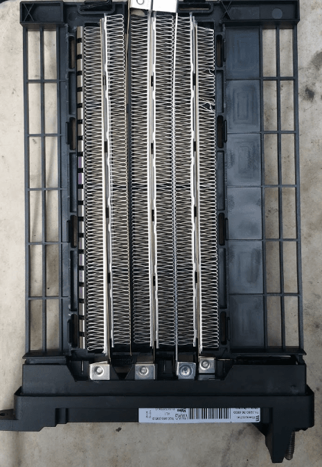

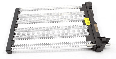

I was surprised to see the heater I have below:
Mostly black plastic - feels very flimsy - and also has the SAME OE number as other alloy PTC's I have seen.
So VAG have updated to this with the SAME OE number!

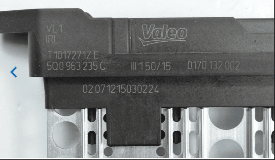

And the latest C number is from Valeo looks like this:

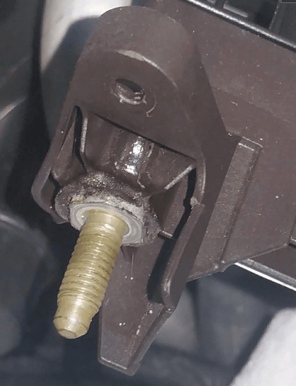

The plastic arround the earth terminal has started to degrade - so has obviously got hot!
It is brown plastic on mine - and black on these later versions - maybe a better/more suitable grade?
Tried measuring the resistance between the large brown cable and the ring terminal and got arround 0.3 ohms.
Does this seem reasonable? Or is my measuring flawed/not accurate enough? I think this is flawed method for measuring resistance in high current cables.
Also tried measuring resistance between earth cable and earth terminal on heater - again I think beyond the accuracy of my multi meter,
I should probably do a voltage drop test over this cable/terminal - trouble is I can't control when the PTC heater turns on.
This is the resistance of one of the 3 PTC circuits in the heater - each was arround 0.8 ohms.
any ideas?
Thinking of just getting a later PTC heater of ebay and see how that works.

We used to resort to feeding a high current down suspect high current leads where there was a need to check for high integrity and then voltage drop across the suspect section, it was either that or use a high grade milliohm meter.
Another thing, you will need to confirm where the unwanted extra resistance is, is it at the lead’s crimping point, or at the stud but on the PTC heater end side and conducting the heat through that stud.
EDit:- I’d think that that must be your best plan, as well as investigating buying a new lead, a genuine later lead from a VW Group dealership.

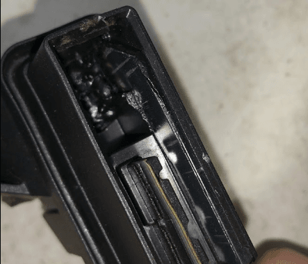

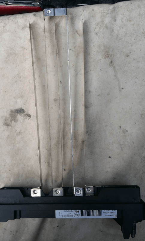

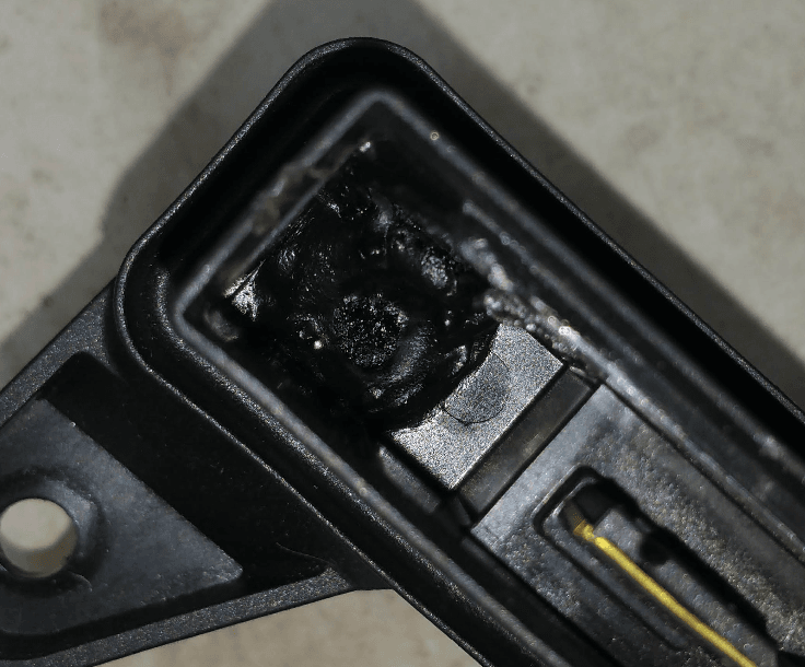

Update:
I managed to get the PTC heater out yesterday - had to remove quite a few screws securing the dash, also from behind the HVAC and screen to give enough wriggle room of the dash to 'just' allow me to slide out the aux heater.
I could clearly 'feel' the earth terminal was loose to the earth return strap which will obviously cause a high resistance and melted plastic!
Interesting design, the thin 'brass' colour strips are the positives, the thicker aluminium colour strip is the ground/return
The latest PTC has a revised design 5Q0963235C:

While I was fitting my new heater matrix I also fitted a new PTC heater. 5Q0963235C this new design feels so much more sturdy than the previous piece of flexible junk.
Obviously the PTC heater won't be turning on until next winter but nice to know it's sorted.
