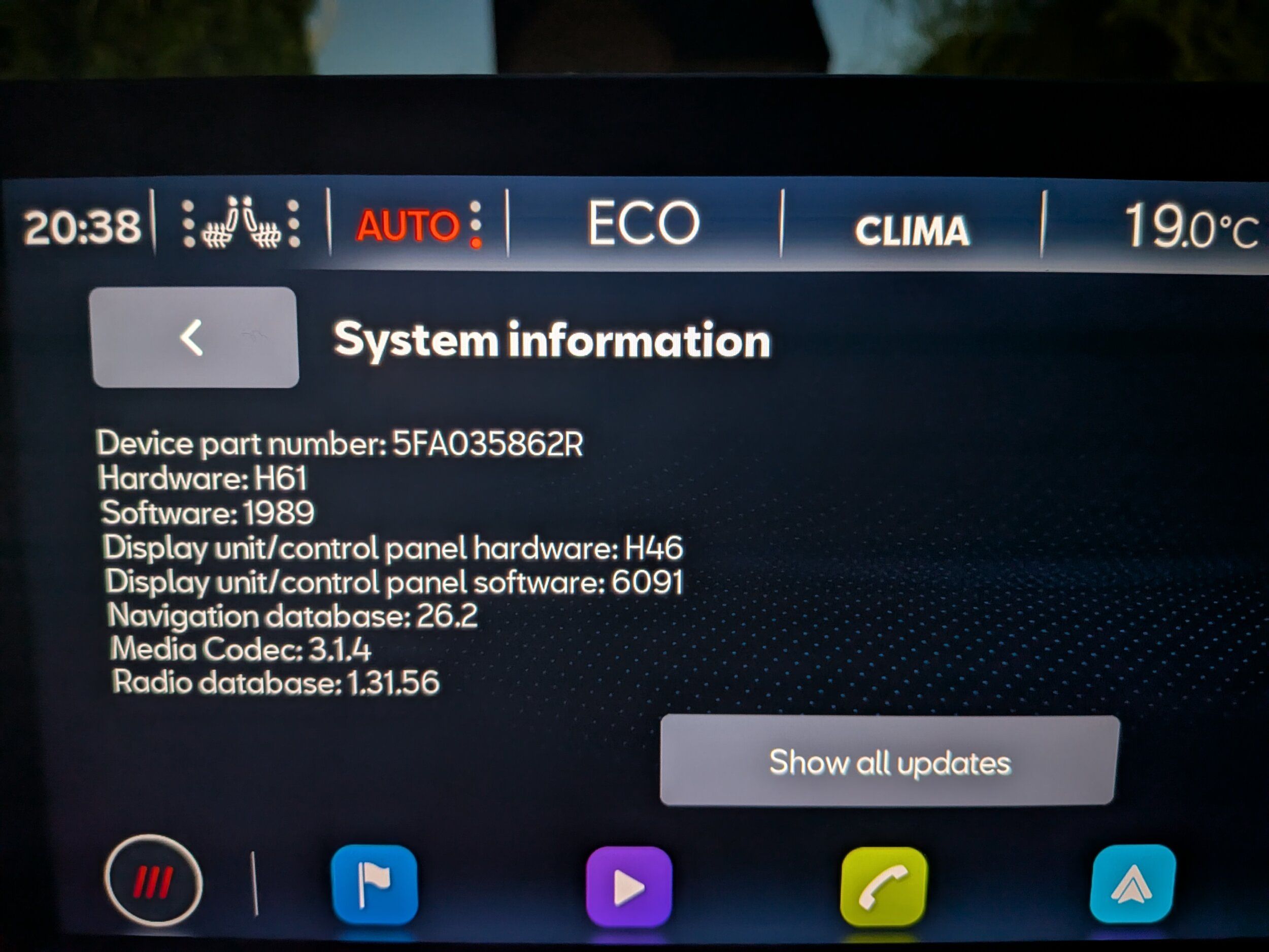

Just installed an OTA update. No idea what it does?
Car: 2023 Cupra Leon Hybrid
The car is on lease so doesn't get to see a main dealer unless it's in for warranty work, so am I missing some sort of update that only a dealer can do?

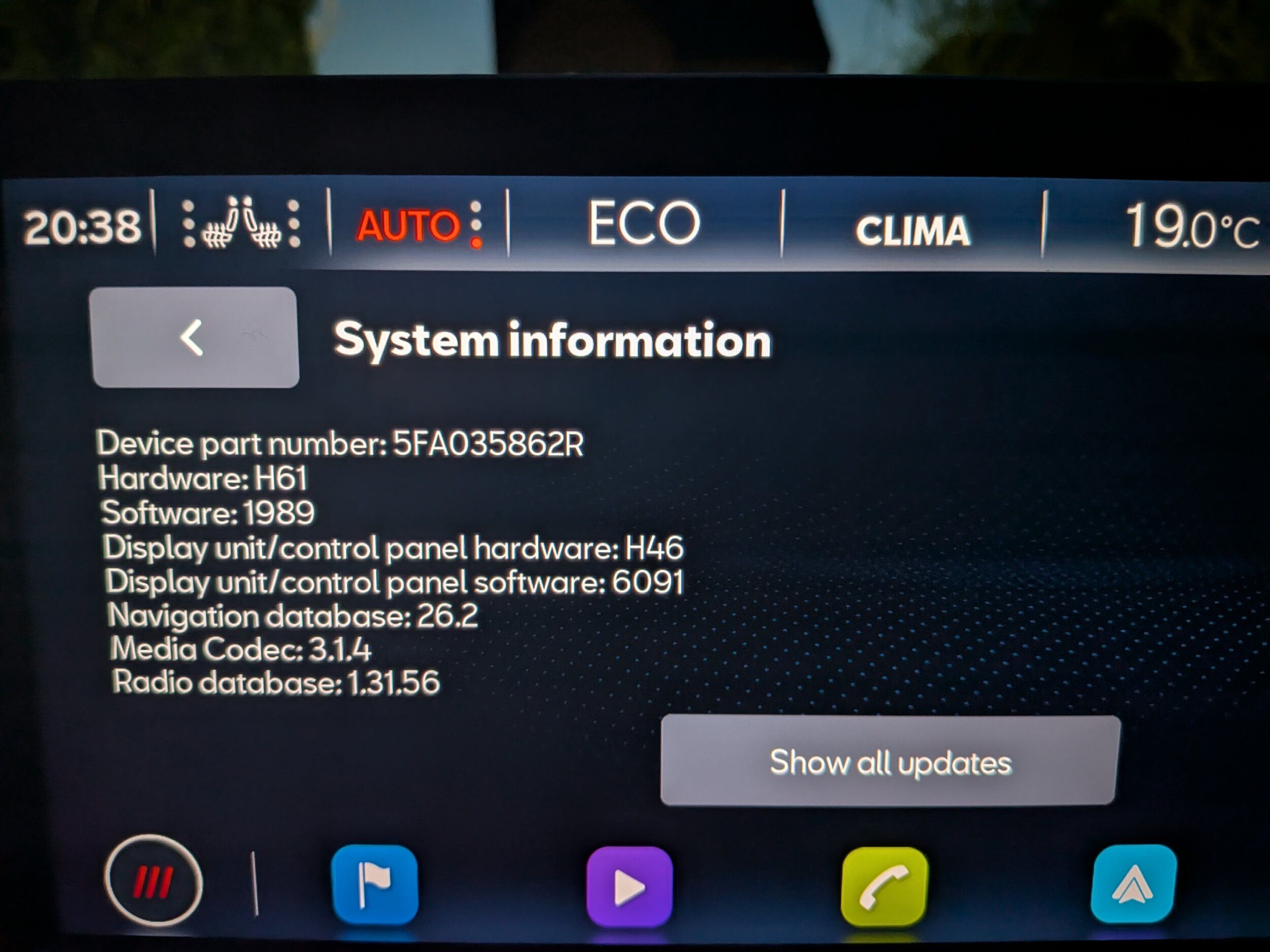

The PV4-RC software update suite mentioned in this thread isn't applicable to your vehicle.
You appear to have installed the latest infotainment system software though.

Oh, I assumed being the Leon thread, the PV4-RC update would be applicable to my Leon (should I get to a dealer for them to apply it)? I know that's not what I got from the OTA update but just posted here for general system update info.
The software update suites were not introduced to vehicle models until mid 2024 to comply with the new UNECE regulations, your vehicle was built before then so it's a pre-UNECE model, so unfortunately, the PV4-RC does not apply to your model year.
Ah, I see, thanks. I just assumed this was one of those regular updates that all models get.
As an aside, the OTA update I installed wiped my profile and reset all internal settings, radio stations, seat position, eManager, clock, dash layout, reverse mirror dip etc etc. Then had to login to my Cupra Connect profile again, in doing so, forgot my PIN which has locked me out for 24 hours! Phone companies seem to do software updates so much better.
