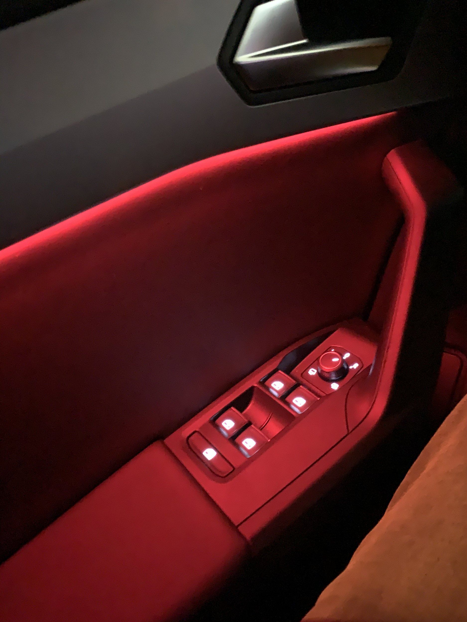

Now the second part is a photo taken after the infotainment has been reset to factory settings .. shows the ambient lightning as red ..
Then the second video is of me adjusting the ambient lighting brightness which immediately makes it go from red to white ...
Super weird ...

I just find it weird that the ambient lighting would be a feature you’d need to select on every single drive ... I’ve found that if I have the ambient lighting on while I try to reset the infotainment system and revert to factory settings the ambient lighting changes to red .. however as mentioned above, as soon as I try to increase or decrease the brightness it changes back to white...furthermore I get a prompt stating it was unfortunately not possible to revert back to factory settings ..

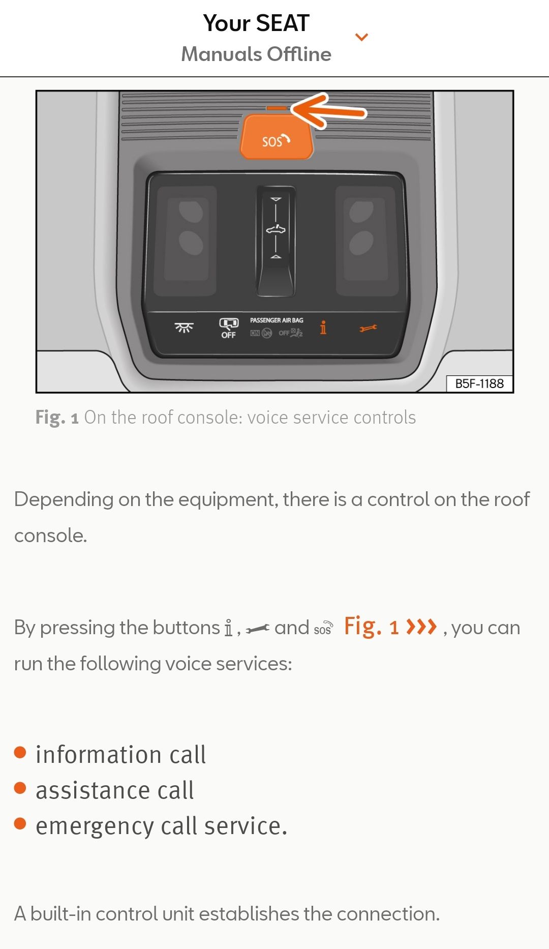

Neither my info or service buttons on the roof works either ...

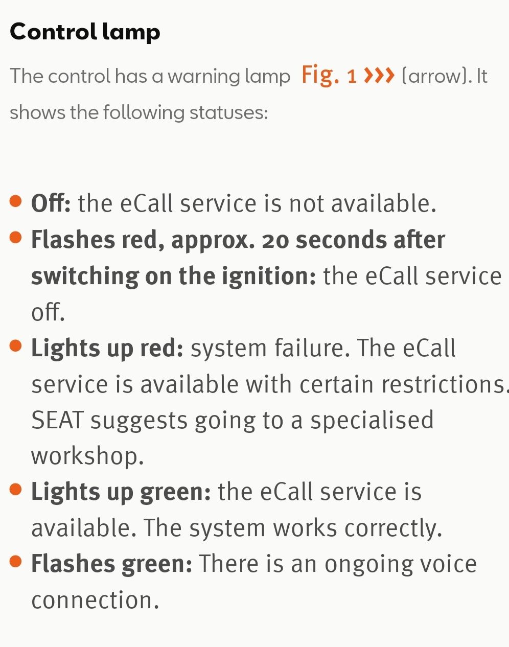

Deleted member 123864
I wonder is your eSIM activated? Sounds as if it isn’t.
