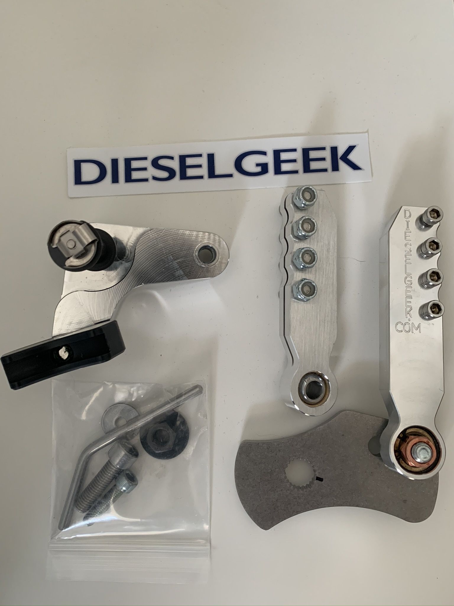

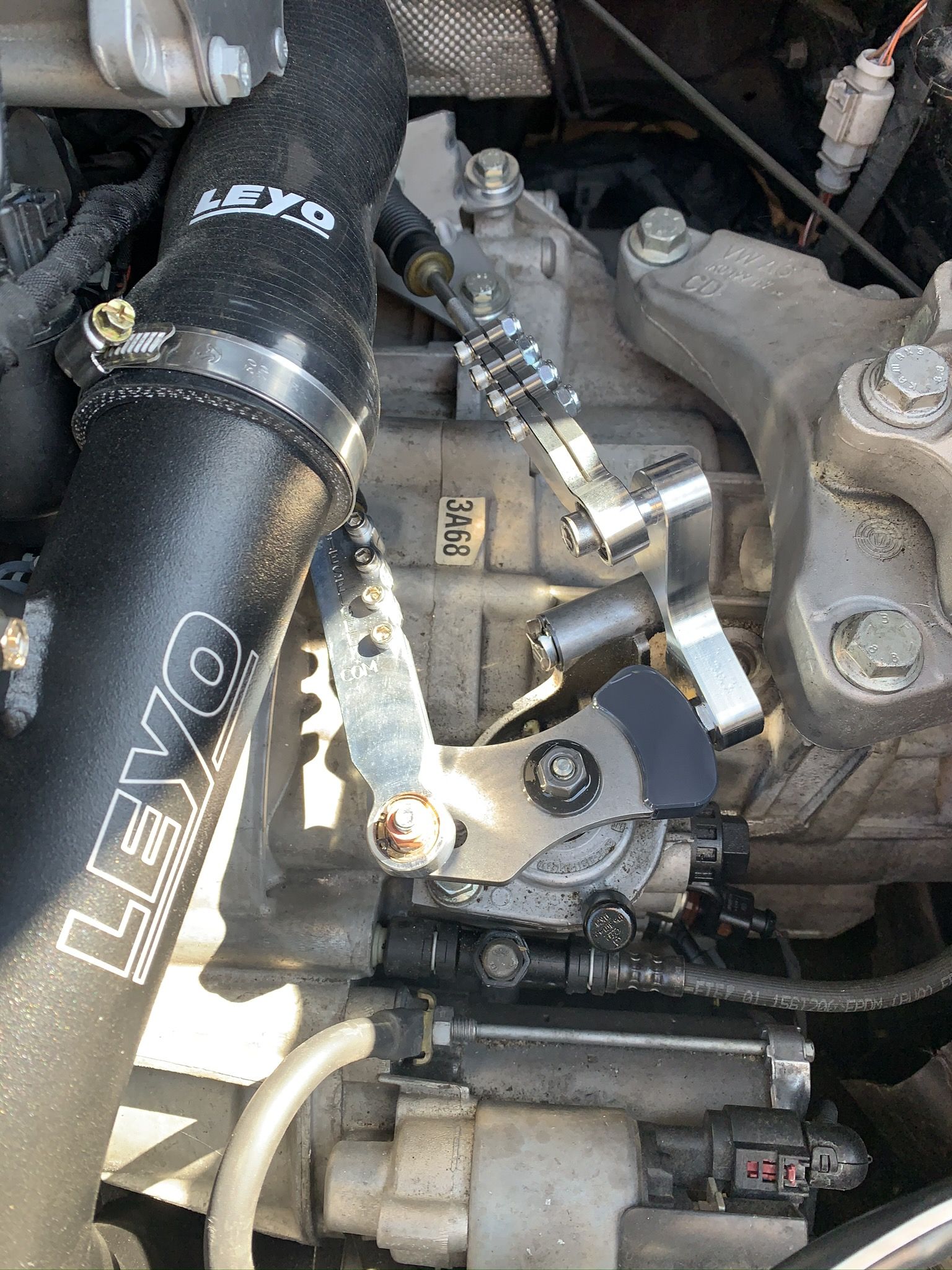

Not meaning to throw a spanner in the works, but I ordered a different kit all together - I got the Diesel Geek Stigma quick shifter set, which I think is fantastic. @Charliessmith has a set too. Not the cheapest but the look and perform great.

I must say I'm extremely happy with the Diesel Geeks short shifter kit, it feels amazing and really shortens the shift quiet a bit.
@paddy6789 told me about it and he got it first and from what he told me about how it feels and performs I had to get it, and I've never thought twice since.
It also looks amazing.
