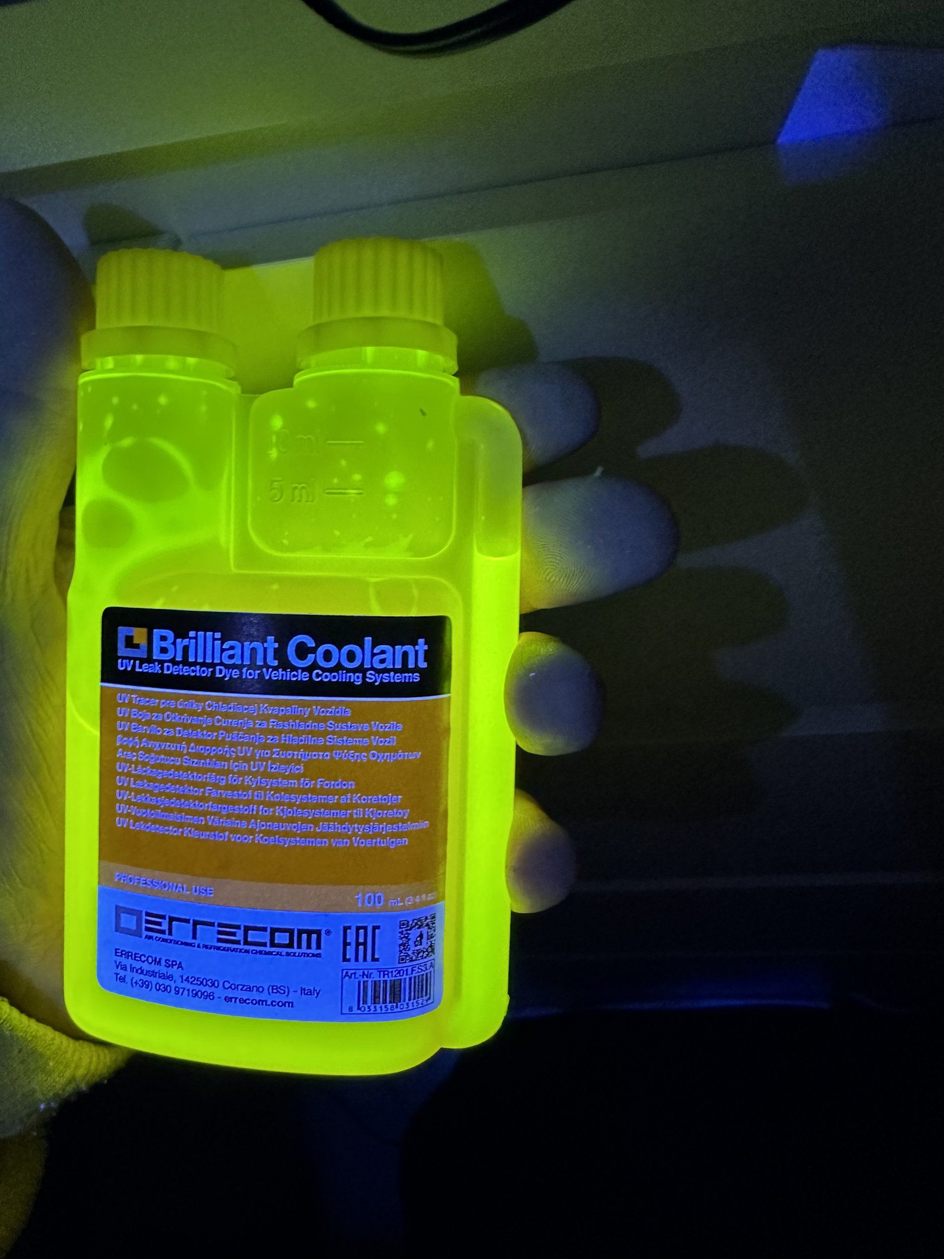

I’ve bought a bottle of uv dye to try and find my possible coolant leak, the car had a new water pump fitted under warranty so could be it needing bled or a leak, who knows.

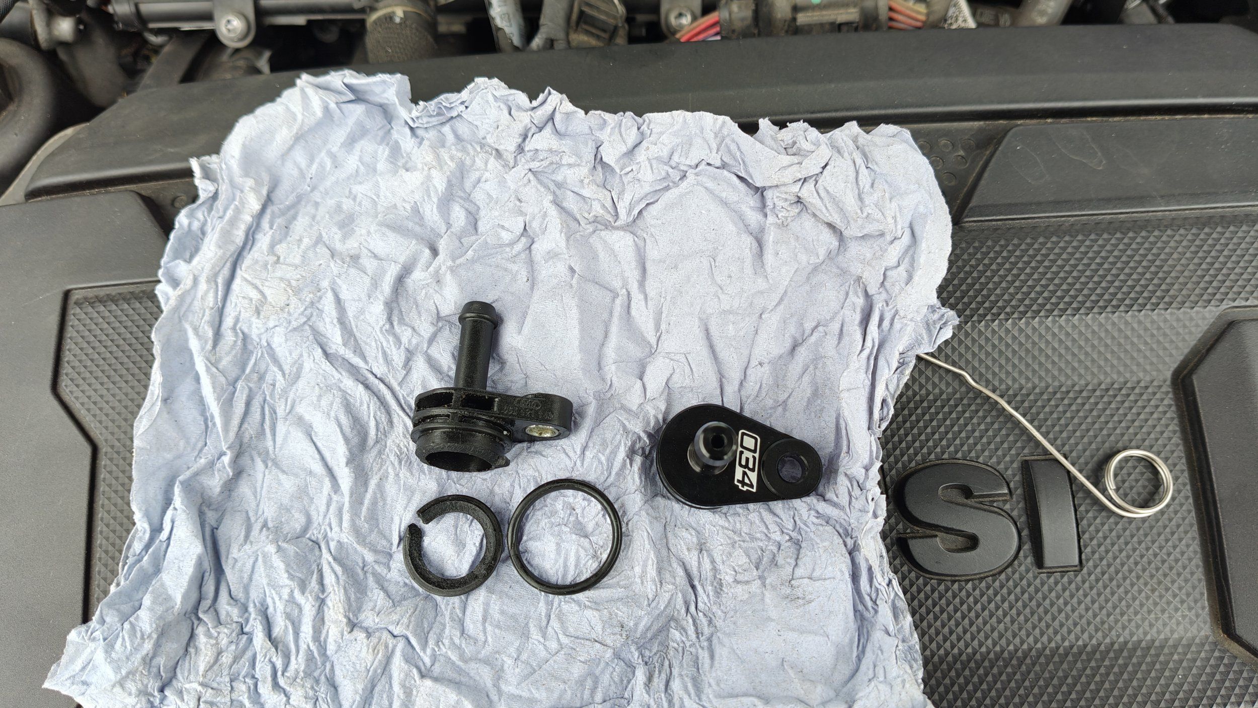

Well I have an update.
After I bought a new expansion tank cap it didn't fix the issue. I thought sod it and just get the 034 Billet barb I was going to anyway. I live fairly close to Awesome GTi so just called in on the way to work the other day and I fitted it this morning.
Took off the original one and it looked intact from the top but after removed it I noticed the bottom flange had blown off the plastic one and rubber O Ring and lower part where missing. Fortunately the heads designed so that it's got a cup to sit on and both parts where just inside the hole. I managed to fish them out with a long pick. Hopefully that's the last of the coolant issues now.
Probably will replace the Coolant tank for the non scila bag one just to be on the safe side.

I'm pretty certain this has fixed the issue now. I went for a really long good drive over the Easter Weekend to Caffeine and Machine, The Hill. 260+ mile round trip and no issues. Coolant level is still exactly the same level as before I set off.
Just so happend to be a MK3 Leon Cupra meetup happens at the same time which was surprising.
I was also pleasantly surprised with my fuel consumption, averaged 49mpg for the trip. Particularly as it's normally only gets 35/38 on my commute.
