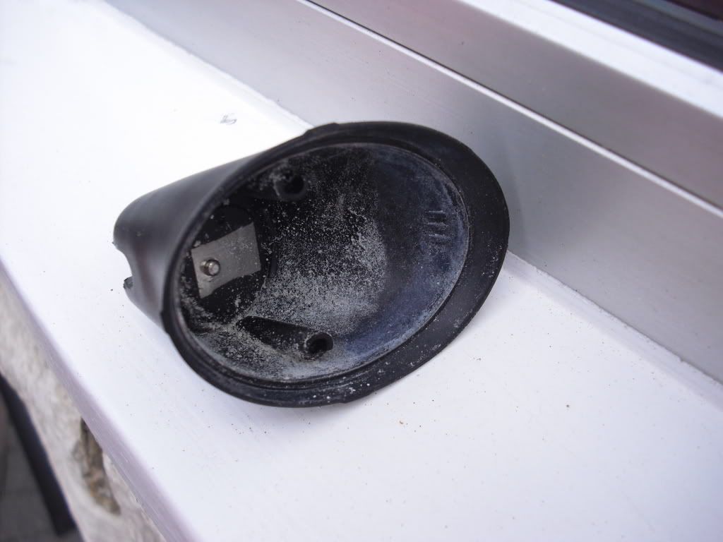

well after doing some research across the MK4 platform VAG cars i came across a candian forum where he had the same issue, his car at the time was only 2 years old (bora)
Anyway he removed the amplified aerial base from the roof of the car and said there was a lot of corrosion from salt etc underneath, after replacing the base it had solved his problems.
With this in mind i thought the easiest place to start was the aerial base. Its very easy to get to and after removing it from the car and taking it apart this is what i was left with
Looking closely at the circuitry and components it looks beyond saving, will have a look in the local scrap yard and see if there are any in better condition (doubt it) and get a price from SEAT for a new unit

bloody hell, can tbeleive it has got that bad in there. have you tried gsf/ecp for a replacement cost? they maybe cheaper than the dealers

its wierd how its got likethat in there, must be from jet washes etc. i think your betting off getting a new kit as a 2nd hand one will probably have similar issues regarding the seal. you may wanna use some silicone or something to make it watertight.

Well, a trip down to the scrap yard was a good move, i took the aerial bases off a passat and a MK4 golf, but the internals were slightly different, the connector was the same, then i found a skoda felicia 2003 and it was an identical aerial base, internals all identical as well and this one was in very good condition, no corrosion at all, i siliconed it all up and fitted it to the roof, the radio reception is now CRYSTAL clear, and i can get stations i didnt even know existed!
Very happy indeed! in the end it didnt cost me anything either witch is a bonus
Just need to clear the fault code with VAG COM and thats one job done
