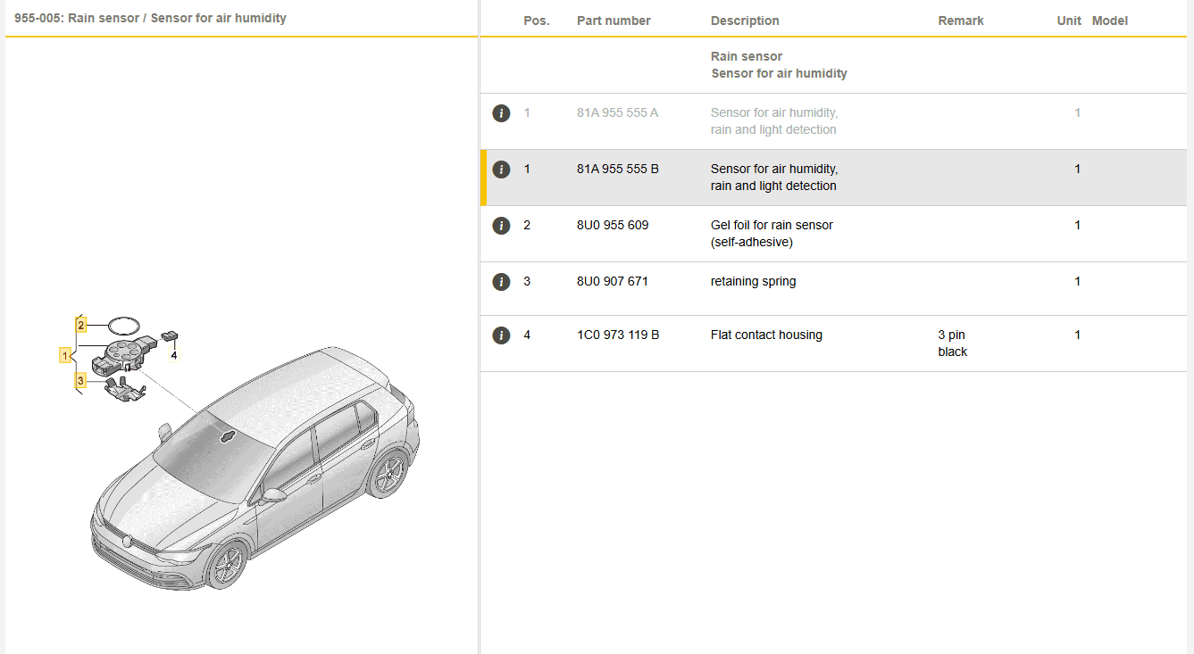

Have you checked that you currently have a sensor installed in the windscreen? There's a discrete light sensor installed in the light switch
To be fair you should have a sensor there for the humidity, I don't see a sensor listed for the Leon KL that doesn't have rain/light & humidity functionality. It's possible the additional functionality just requires enabling.

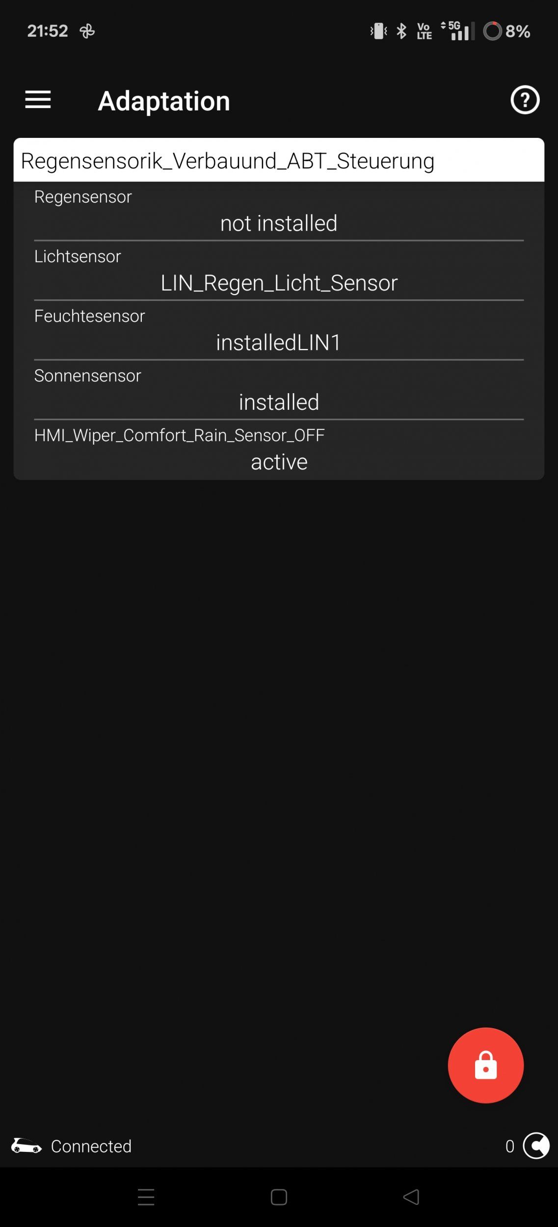

Hello. Thank you for your response. My leon has only auto light not rain sensor Im 100% sure. Many friends of mine with same seat leon mk4 kl 2021 have no rain sensor too. Light switch says auto. Only this. Any help please?

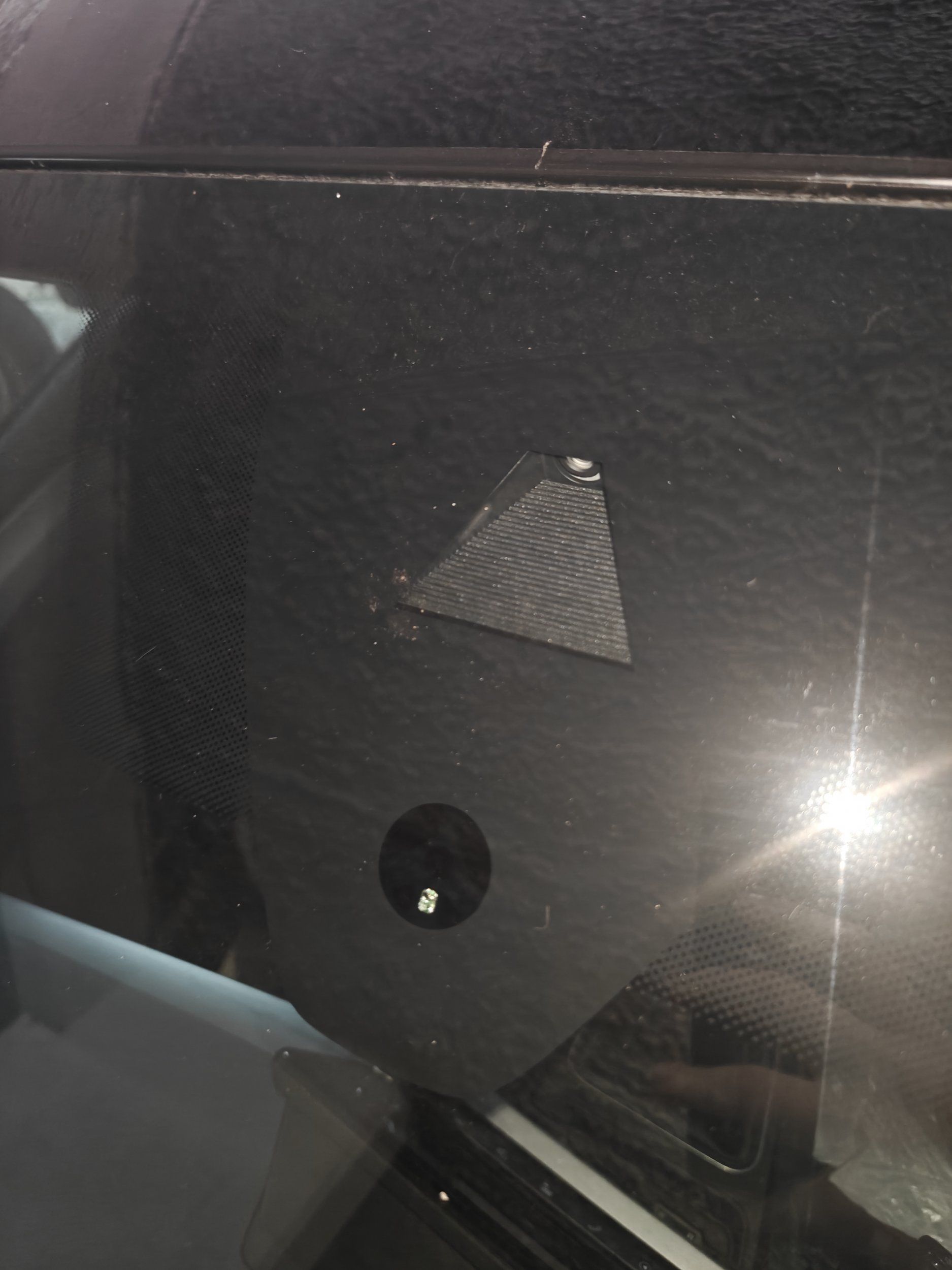

You already have the sensor installed in the windscreen

I have tried to put the switch up like the wv Golf 7.5 I used to have with rain sensor and its not working. If I put the switch up sweepers are working every 25 secs. Any idea how to activate it?

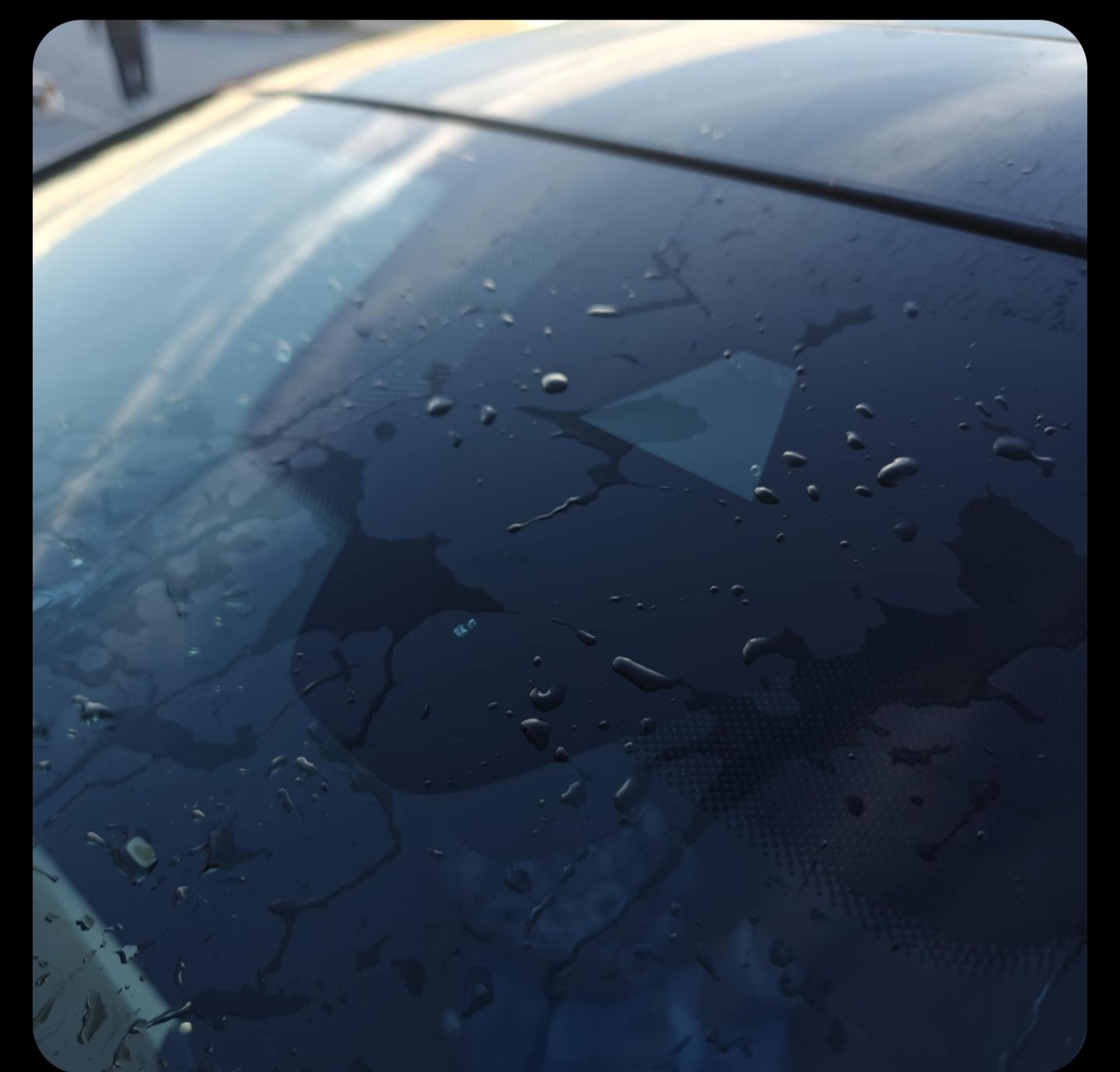

See the picture below:

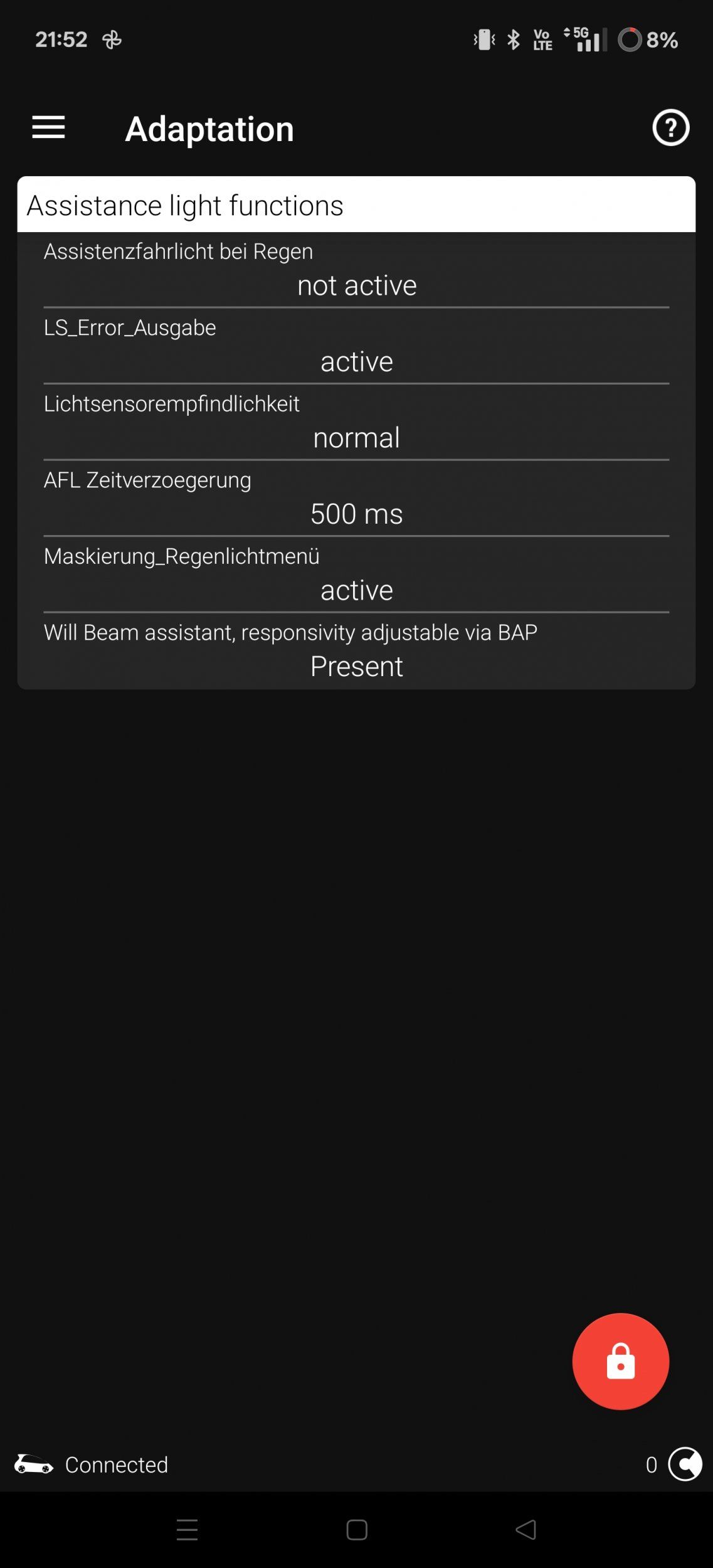

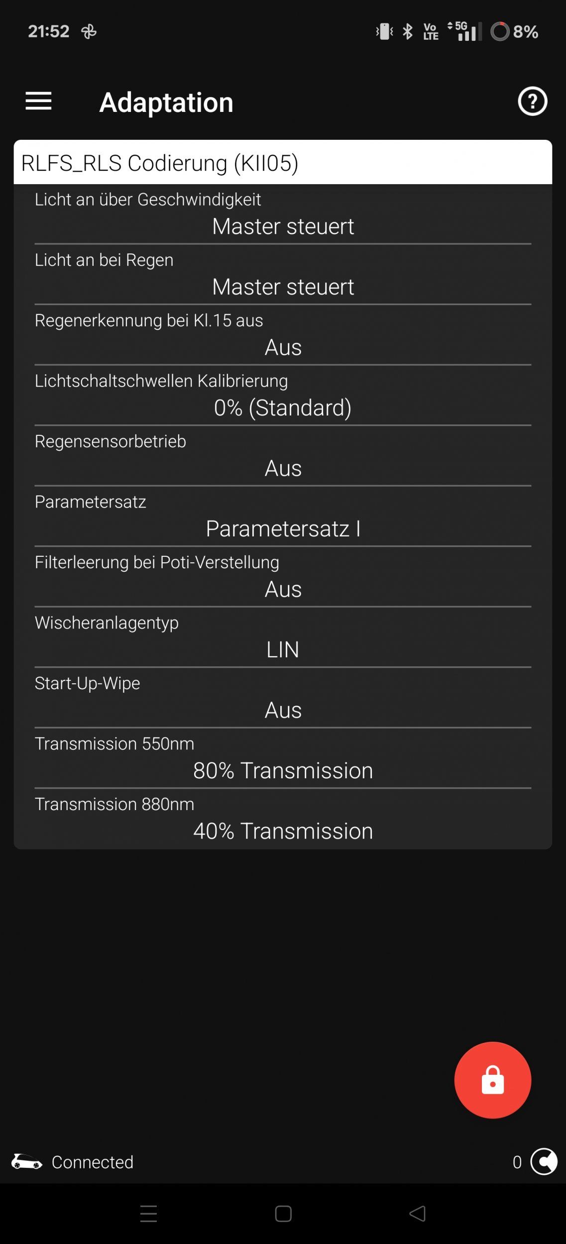

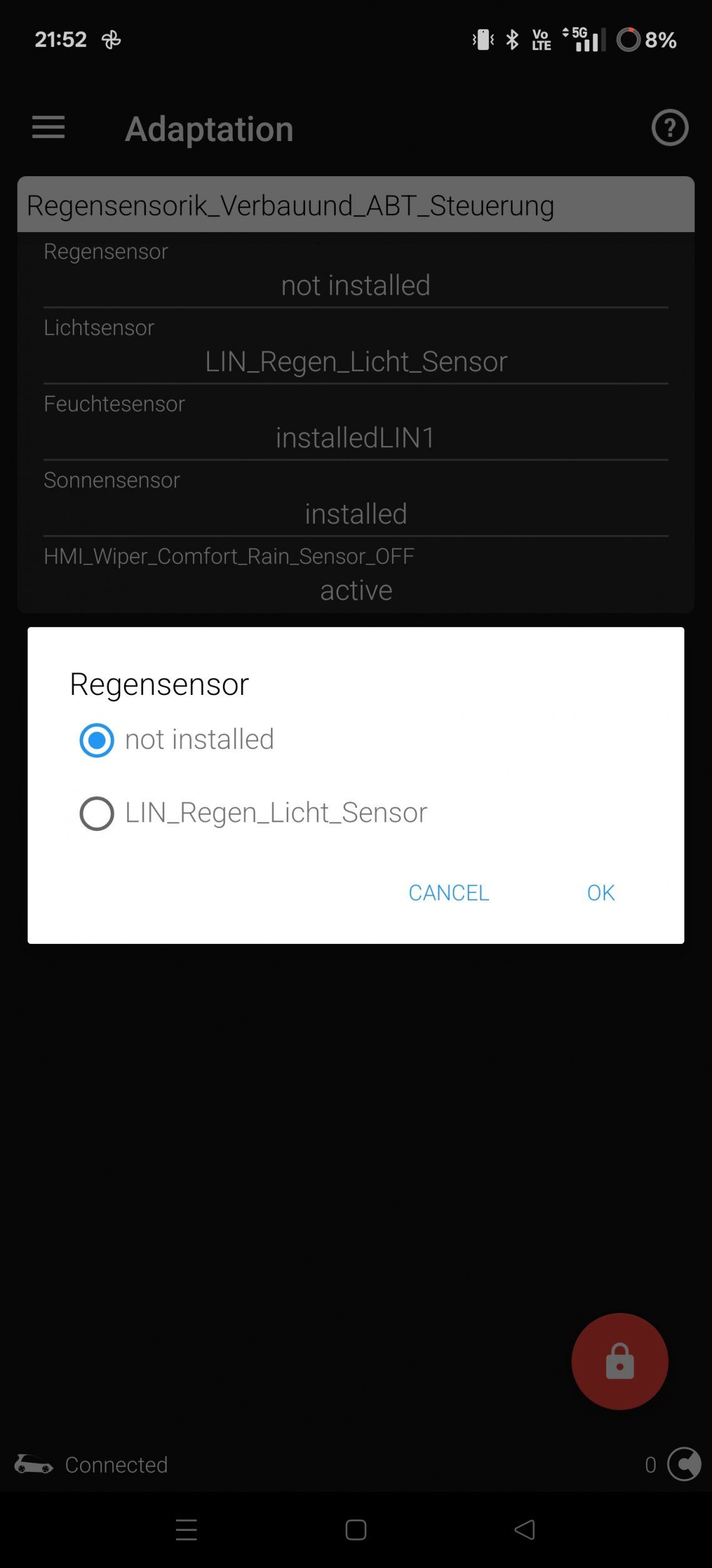

Regensensorik_Verbauund_ABT_Steuerung
HMI_Wiper_Comfort_Rain_Sensor_OFF notactive -> active
Regensensor not installed -> installed
Assistance light functions
Assistenzfahrlicht bei Regen not active -> active
Maskierung_Regenlichtmenü active -> not active
RLFS_RLS Codierung (KII05)
Regensensorbetrieb Aus -> Ein
Light function "Coming/Leaving Home"
Menuesteuerung Leaving-home Freischaltung per BAP not active -> active
Menuesteuerung Coming Home Werkseinstellung not active -> active
Coming Home Verbaustatus not installed -> Automatic
Leaving-Home Verbausstatus not enabled -> enabled
Darstellung Coming-home Verlauf not active -> active
Darstellung Leaving-home Verlauf not active -> active
Dataset is the same for both 8N4 and 8N6

Somehow the picture is too bad, or I have trouble seeing, but I'm missing some circles on the sensor...

Good morning.
Please see this pic. I need to change only this? It will work then?
And see these too
