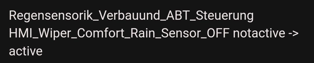

There's coding in A5 too, in addition to the list I posted
Regensensorik_Verbauund_ABT_Steuerung
HMI_Wiper_Comfort_Rain_Sensor_OFF notactive -> active
Regensensor not installed -> installed
Assistance light functions
Assistenzfahrlicht bei Regen not active -> active
Maskierung_Regenlichtmenü active -> not active
RLFS_RLS Codierung (KII05)
Regensensorbetrieb Aus -> Ein
Light function "Coming/Leaving Home"
Menuesteuerung Leaving-home Freischaltung per BAP not active -> active
Menuesteuerung Coming Home Werkseinstellung not active -> active
Coming Home Verbaustatus not installed -> Automatic
Leaving-Home Verbausstatus not enabled -> enabled
Darstellung Coming-home Verlauf not active -> active
Darstellung Leaving-home Verlauf not active -> active

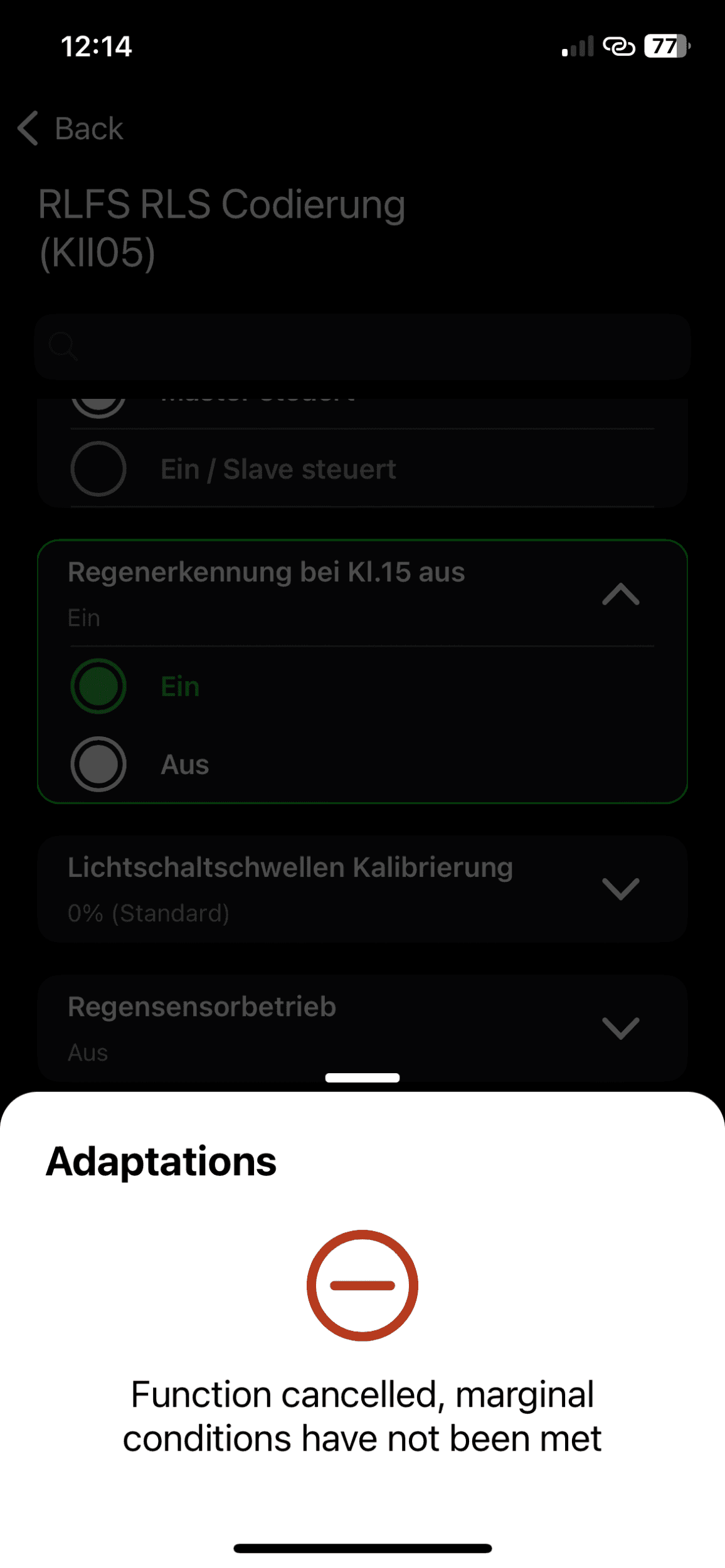

Hi @East Yorkshire Retrofits , I'm trying to enable this in my Seat Leon mk4 and it fails for me with "Functions cancelled, marginal conditions have not been met" when I'm trying to do the following step:
All the other changes worked! It's only that one that I can not enable.
Any idea what am I missing here ?
Thanks!

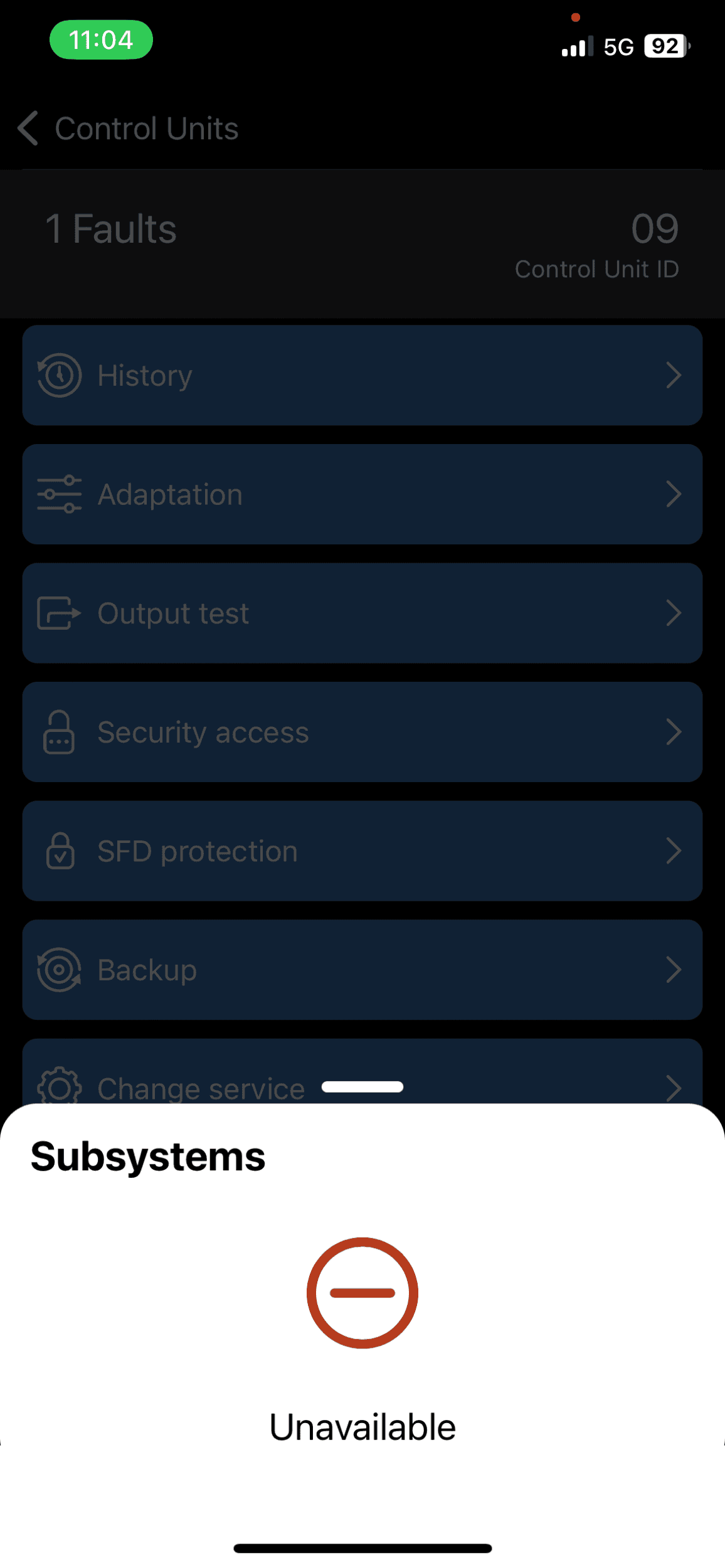

I am using the OBDeleven VAG (so pro verson) and I am getting an “Unavailable” when clicking on the Subsystem of 09
is this expected? Or any idea how else to get the sensor PN ?

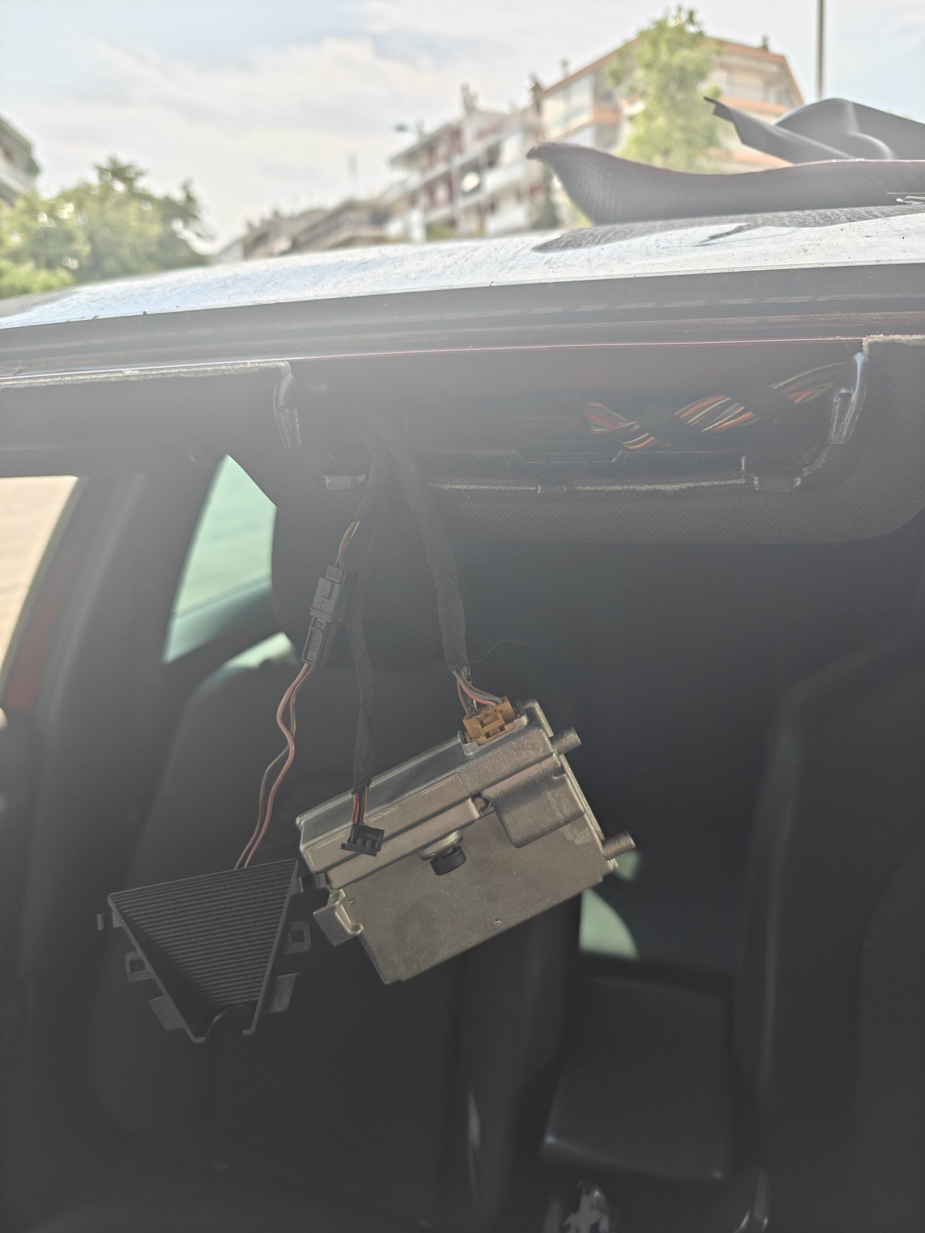

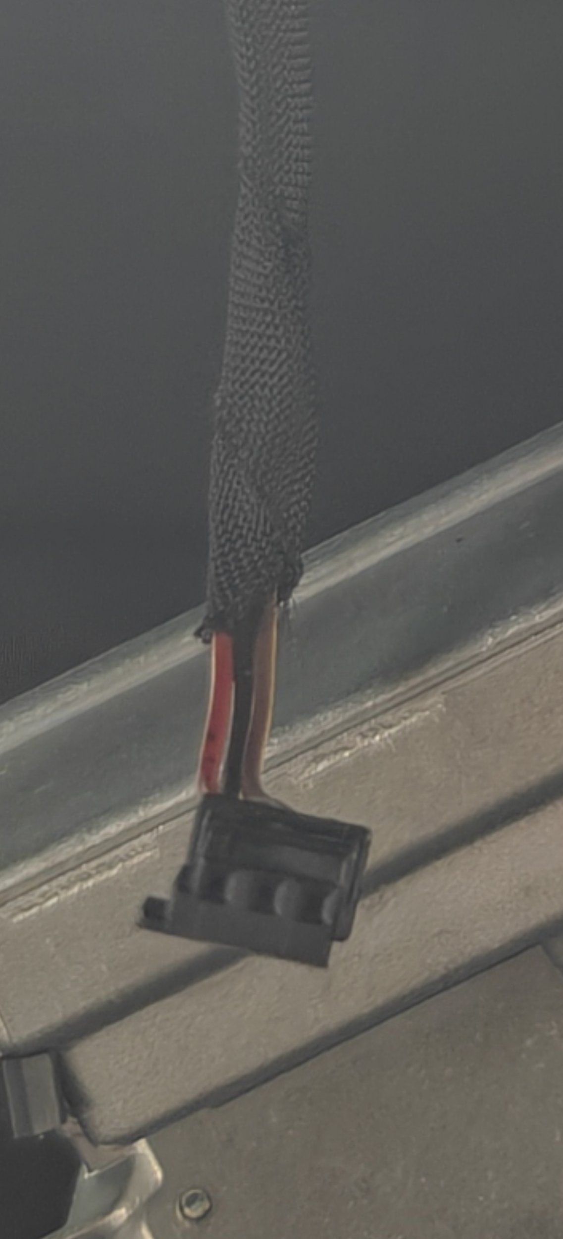

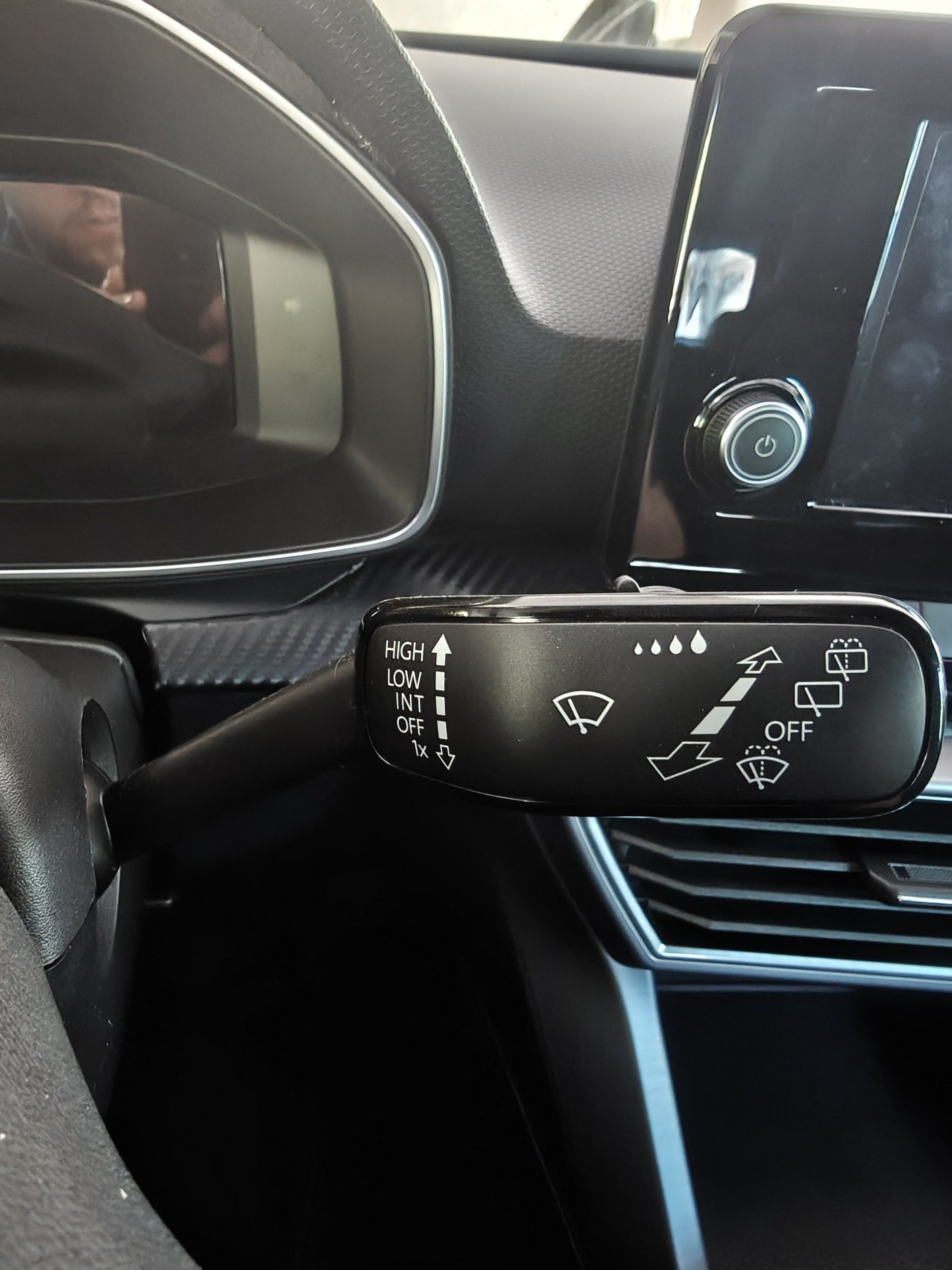

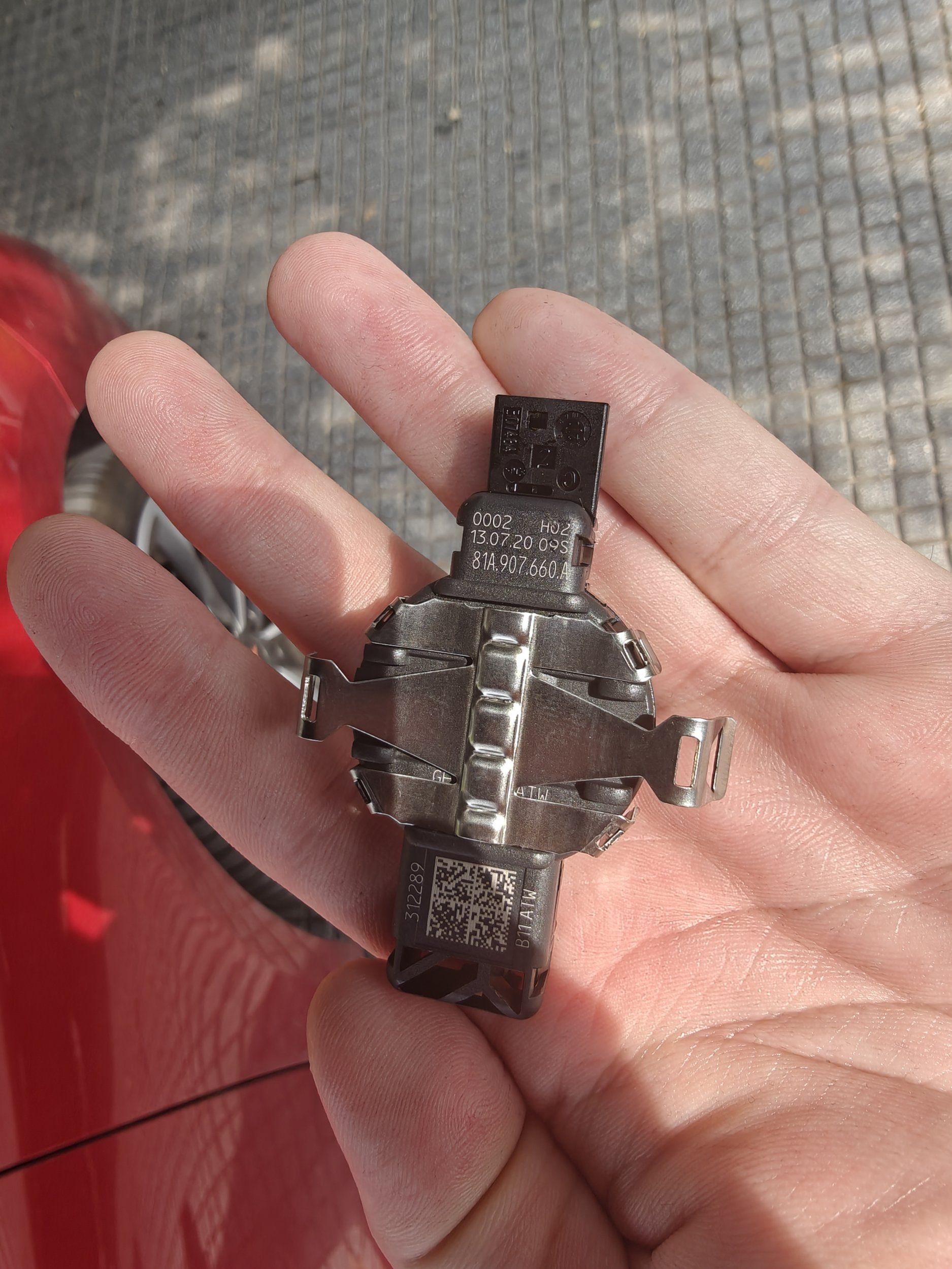

Hello again. I replace my windshield. And I saw what sensor I had installed. Please see the photos. You can also see the wiring, the switch, etc. When I Google the part number of my own sensor it seems that its already a rain sensor along with humidity and light. But I do NOT have rain sensor at all. Please see the wiring. What can I do to have rain sensor please? AI says that I have the right sensor but not the right wiring.
Thank you

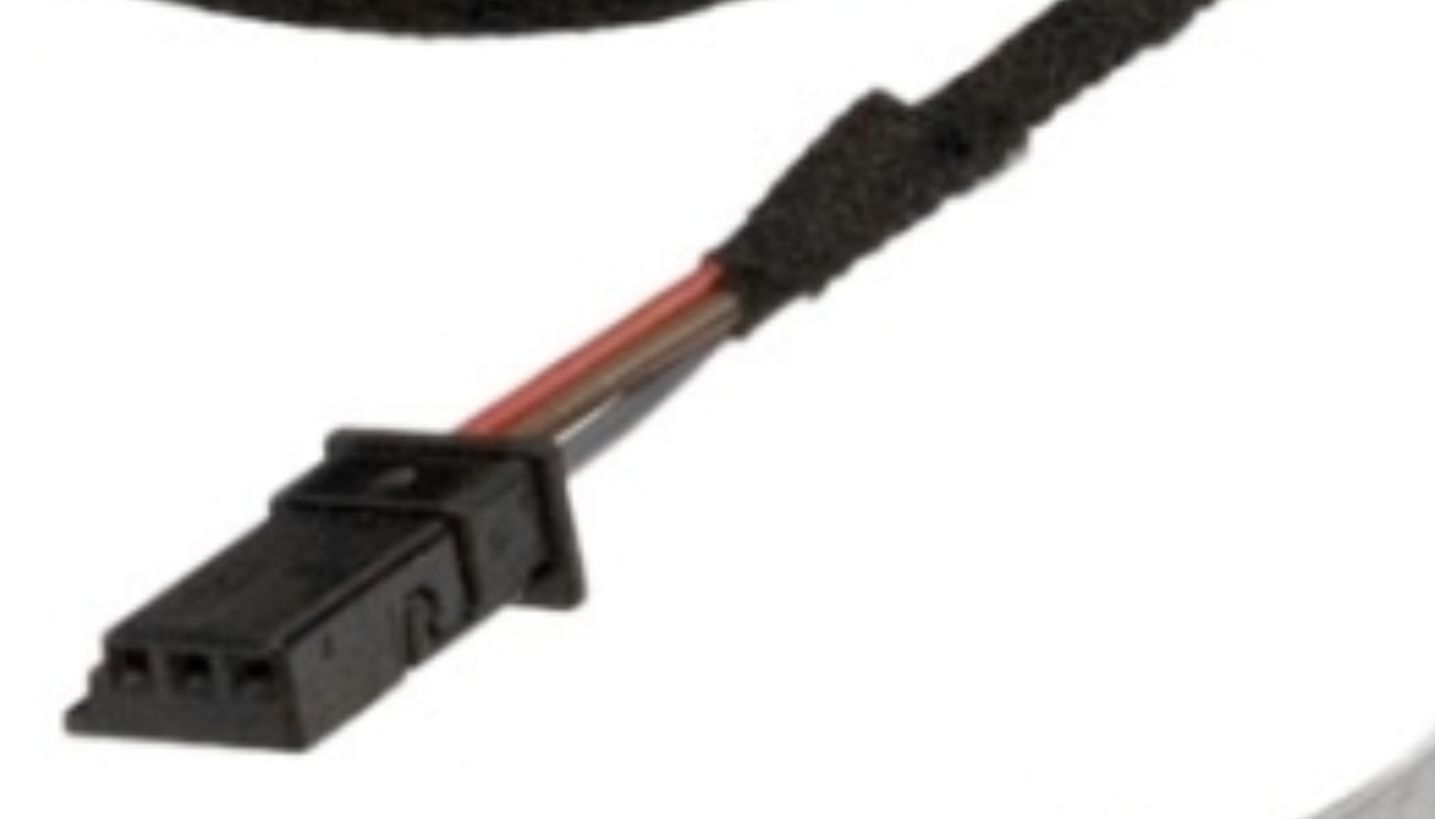

The wiring is just power, ground and LIN. Your wiring is fine
The stalks are the same for cars with/without auto lights & wipers.
And this also

If my wiring is fine, the sensor is fine, then why I don't have auto wipers? My car doesn't seem to have rain sensor and I know lot of people with the same exact car that also DON'T have rain sensor. We have only light and humidity. What can I do?
