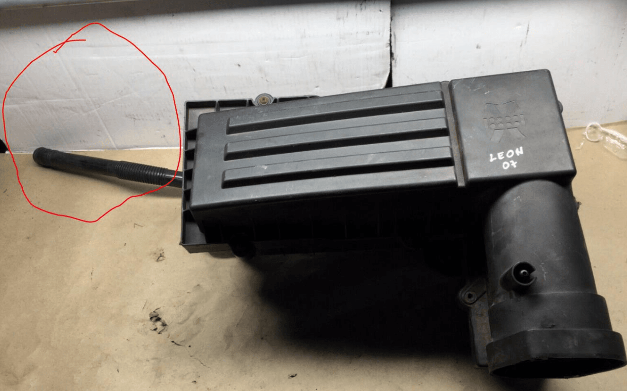

Hi All,
Just to let you know this issue has now been resolved.
It appears the flex pipe attached to the airbox was wiggling about at high speeds which was causing the vibrations which made it sound like it was coming from the passenger footwell.
I tied this up with some cable ties and no more rattles over 70MPH!
Picture attached for your references.
Thanks
