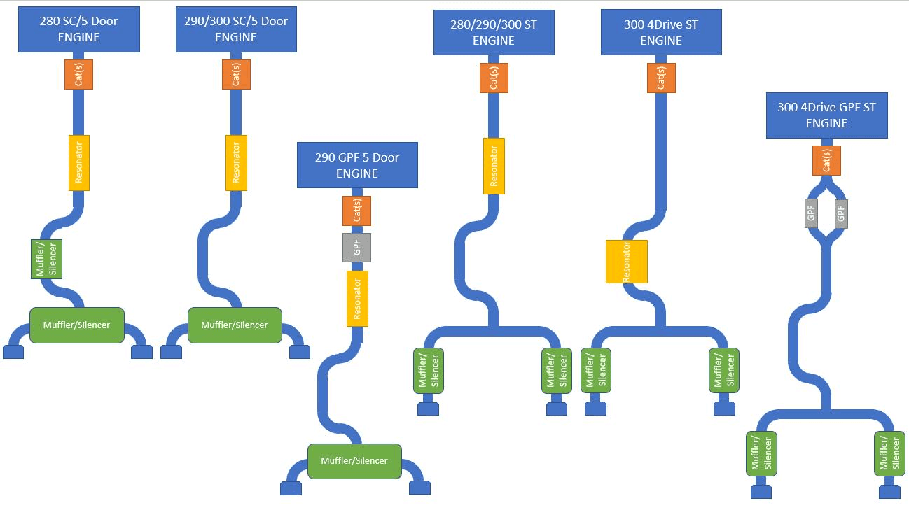

The exhaust is completely different on the ST, with 2 back boxes either side of a spare wheel well (on the Cupra) that sits much lower. This supports the lower floor on the ST than the hatch. For example the rear back boxes actually sit wider and further back of the rear wheels.

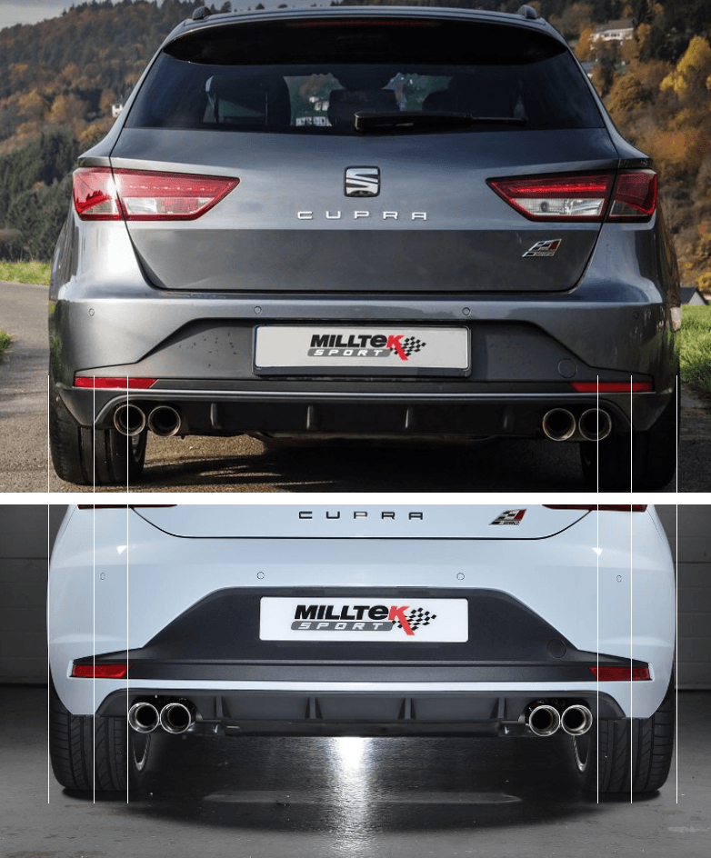

I know you're talking FR, but the below examples of the exhausts on the Cupra should help, although they are not to scale. The exhaust tips are not like massively different in position, but they are further apart.

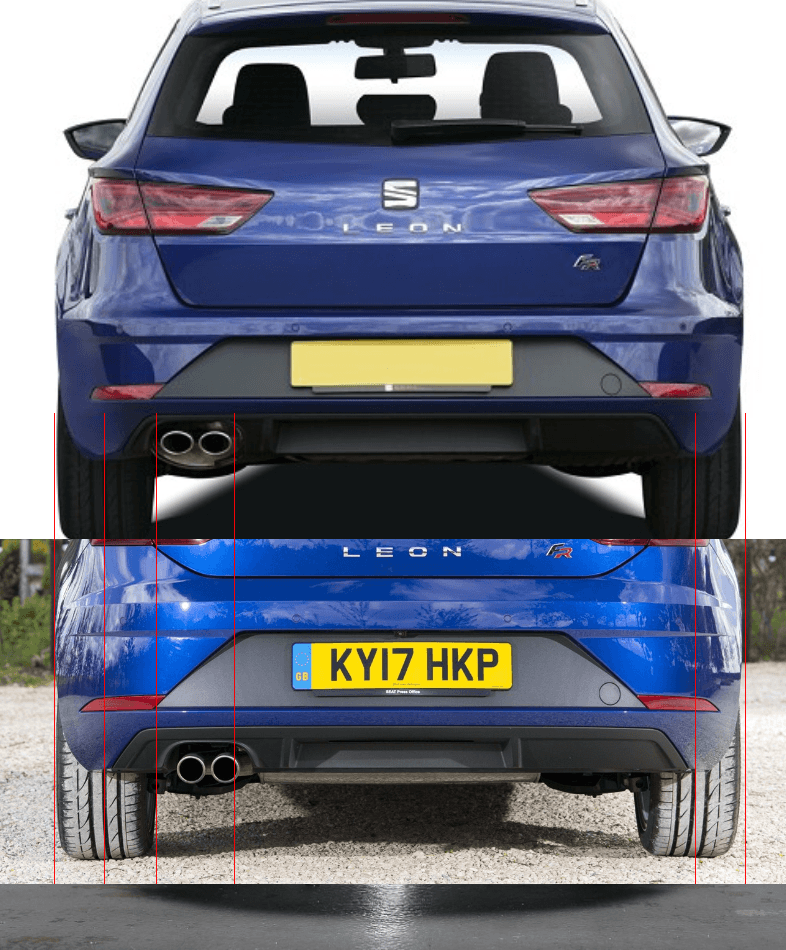

As for straighter bumper, this just the shape of the car, with the extended boot and bigger rear bumper the curves on the corner are sharper making the bumper edge that bit straighter. Either way its a very different bumper, just look at the boot edge etc:
I know this isn't a perfect comparison, but should help highlight the differences (besides the more obvious extra 30+cm length to the car)
As for Maxton, the facelift bumper on the FR is the same as the Cupra just with a different diffuser. So you could get the cupra one, but you'd need an exhaust to fill the extra hole...

Again not perfect but the difference for the FR.
Does look like the exhuast tips may be differnt size too, although they may be the same width...
