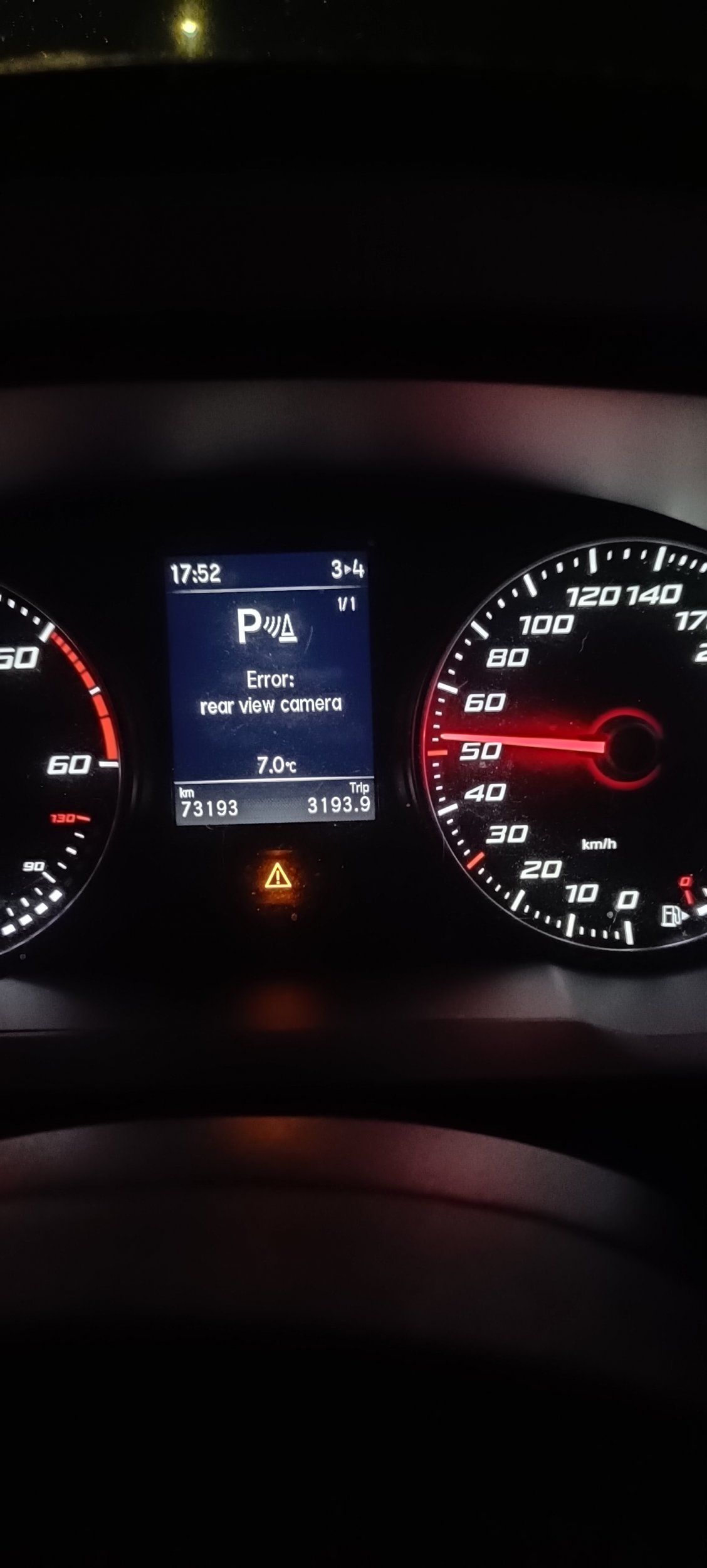

Hey guys, I know this tread is old, I'm new to this page and have started to have issues with my reverse camera on my Leon 2021, was the best option to bring it ro the dealership?thanks again ?
Hey! You better check if the camera are still in place, cuz for 2020-2021 models had a common issue, that cameras just felt out. Mine felt out twice. Both times changed by warranty.

I was reading other threads and looking at advice on them aswell, camera is still intact. Thinking of changing my car also I've had too much trouble with it than it's worth. Thanks for replying ?
