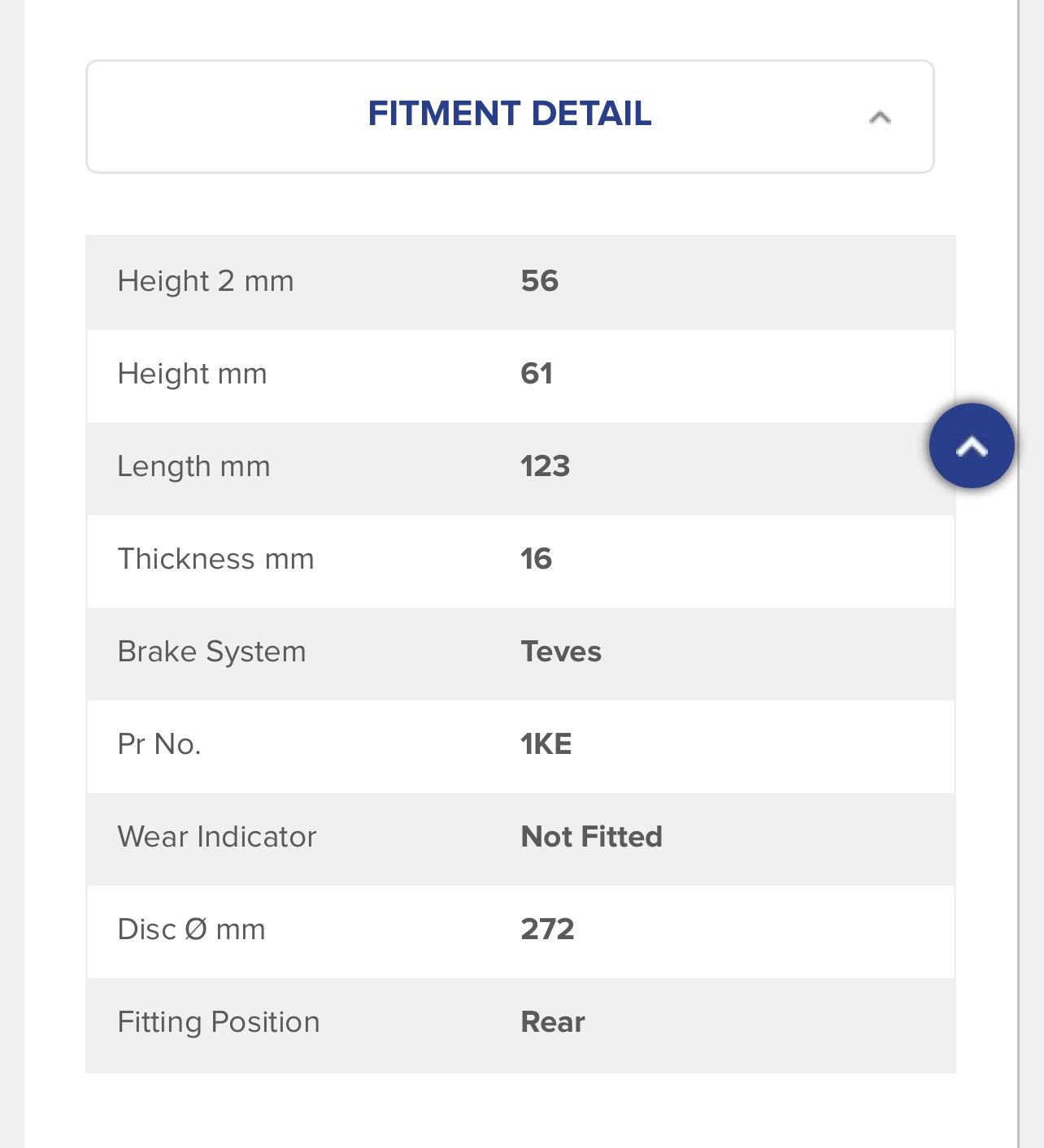

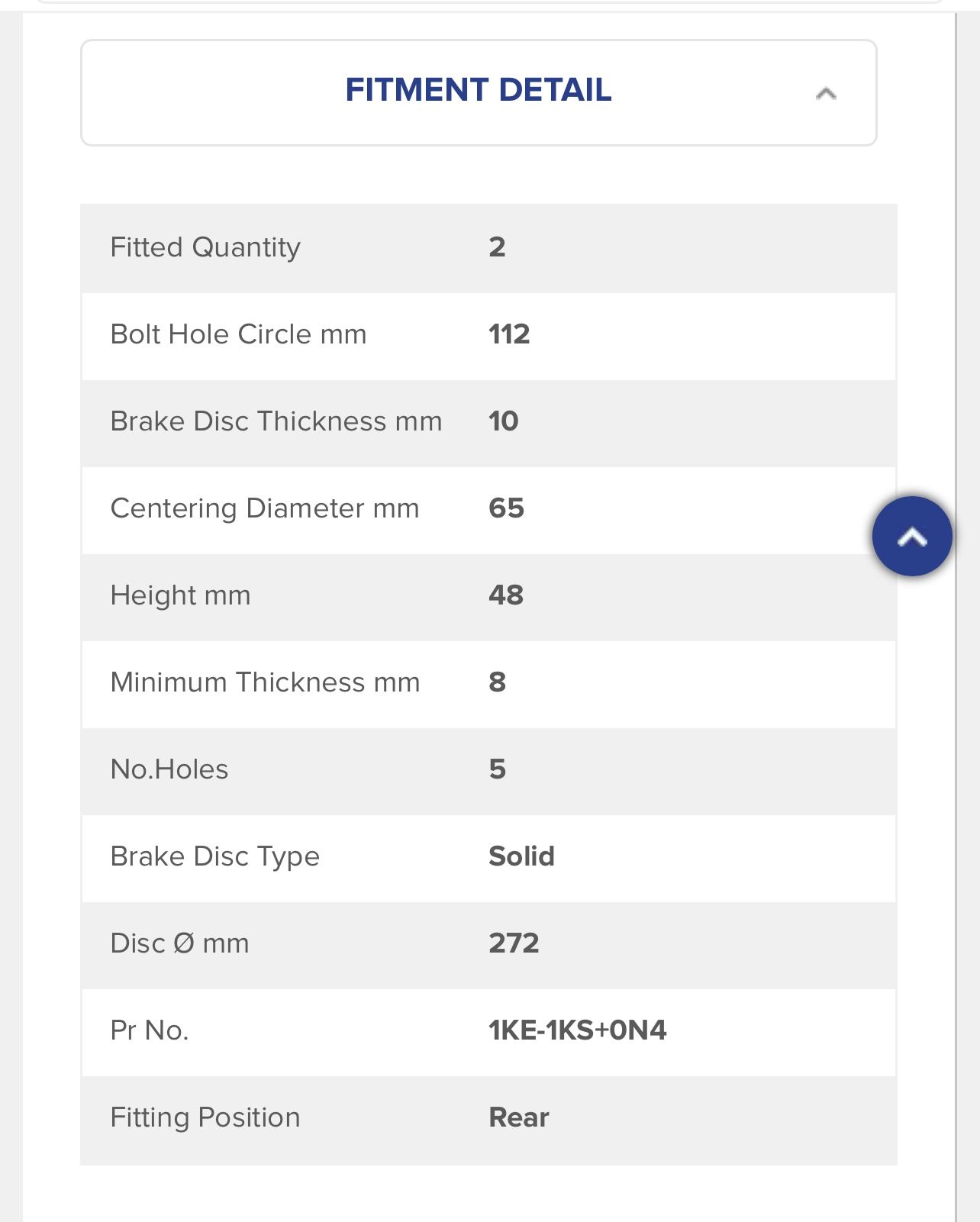

the ‘1ke’ dimensions for the pads and discs for my 2018 st if it helps -

That is amazing mate and a massive help. Sorry if I got this wrong isn't the rear system 1ks rather 1ke or is this dependant on what engine you have ? Thanks again mate

@SuperV8 - another one for you 😉
lol.
For others this was my reply:
No rear wear indicator.
The 184 has 272mm diameter rear discs. 08.B413.11 looks correct.
There are 2x pad versions depending on if you have EPB?
LP2709 would be if you have manual handbrake.
LP2490 if you have EPB.
#Additionally# as yours is 2018 this has EBP so your rear pad would be LP2490 - which is 1KE pr code.
